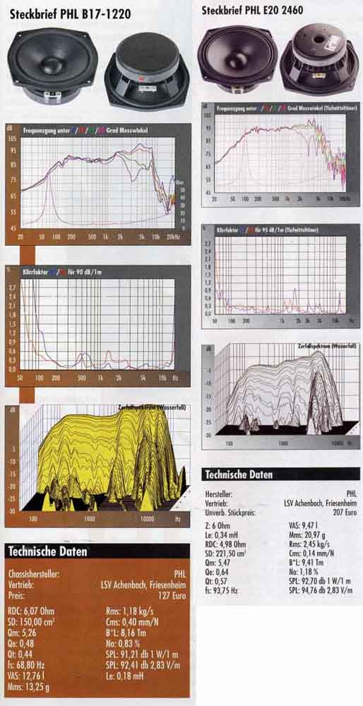

I Know that ceramic drivers sounds better together but some guys (like tony Gee) says that are not so dynamic, I know some kharma design that sounds very very good but that have a 12" woofer. A very dynamic loudspeaker is what I am looking for! So I would try to mate the accuracy of the ceramic mid-hi with the authority of the pro audio low end.
Recently I am more for a simplier 3ways with 15 kappa pro (side firing), phl 1220 or 2460 and morel supreme.
If you see the distortion graph of the phl you can appreciate that the distortion of the accuton 7" isn't lower than the phl!!! so isn't true that those pro audio stuff are so bad! (I hope...) 🙄
