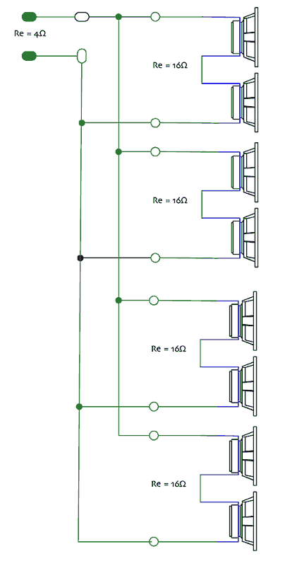

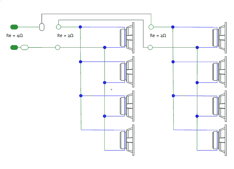

Not sure about that. But I can report that the fault was a bad connector: with a new loom, all is good. Better than good: Scheme 3 (4x 16Ω series pairs in parallel) has improved LF significantly vs Scheme 1 (2x 2Ω sets in series of 4x drivers in parallel).

Can you describe in which way it sounds better?
If the drivers are all in one huge airspace, it will affect inter-driver electrical dampening how they're grouped. The two groups of parallel 4 in series may measure higher in Qts through increased Qes. The other scheme will have the individual woofer peaks combine into one wider peak, lowering measured and perceived Qts. Parallel operation eliminates most of the driver interaction, which retains a more focused, taller (higher Q) summed system peak. The series connection disperses the peak, making it sum as a wider (lower Q) peak.

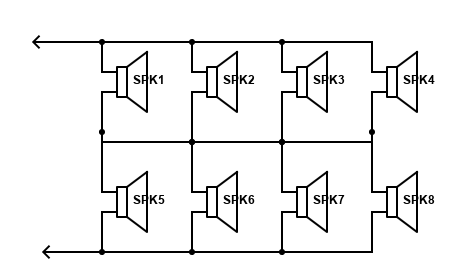

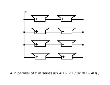

Thought it might be useful to fix and repost this graphic as I couldn't find a one-stop image showing all (4) possible connection methods for series-parallel wiring 8x drivers, which either produces 2*Re or Re/2.
Apologies in advance for another schoolboy question: but in each case where would resistors and capacitors be inserted to create a low-pass filter to roll off the response of 4 drivers to make a 2.5-way? And would this alter the impedance of the total load?
8 drivers playing the same tune is a recipe for failure, I've learned! The ideal two-way solution appears to be connecting 8x identical woofers W-W-M-M | T | M-M-W-W . . . low-passing the outer drivers to avoid comb filtering and mitigating rising response. I can see it might be better to treat it as a 3-way, but for this application I would like to use a 2-channel plate amp and a touch of additional filtering if possible.

I'm seeing slightly more output around Fs. It's not a major audible difference, as I'm working with drivers of Fs=25-35Hz and unless you go looking for it, an extra 2dB from 25-30Hz isn't transformative in the average track. However with music that exposes the lowest octaves, I'm obviously hearing a little more robust response.

- 4 ways with 8 woofers: Series/Parallel / Parallel/Series
