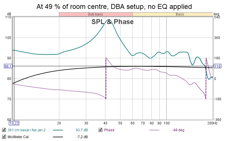

I guess you have a rectangular room and that the subs are positioned close to one end wall. Correct?
EQ:ing those subs should be the last thing to do, icing on the cake for one listening position. Before EQ:ing, it would be best to figure out best position for the sofa, to avoid placing it in a typical room mode dip. Dips and SBIR (speaker boundary interference response) cannot be EQ:ed well, while peaks at low frequencies are more manageable with EQ.
What are the dimensions of the room, LxWxH and what type of construction? Drywall all around, concrete or a mix? With the pair of subs at an end wall, your 1st length mode will have it deepest dip (node) and your 2nd length mode its highest peak (anti node) at the room’s acoustical centre. Avoid that place if at all practical for you.
I would place a long piece of tape on the floor right between your subs and starting from physical centre of the room mark it 0, -10 cm, +10 cm and so forth up to +/- 1 m or so from the centre. Then you make a number of REW measurements along the marks. Mark on the tape where you get the very lowest dip for the 1 st mode. It should also be very close to the highest peak of your 2nd length mode. That is your acoustical room center. Now, if you have a room with flimsy drywalls and behind it a room with a stiff and heavy outer wall, you may find that frequency / wave length of the 1st length mode says your listening room is acoustically actually longer than its physical dimensions. Check if your 3 rd length mode has its very deepest dip at the same mark as for the 1st. (It probably hasn’t). Mark it on the tape. Calculate the wave length of the 3rd length mode and mark its next dip with its peak in between. Calculate the wavelength of the 2nd and do the same. Suitable place for the sofa would be where you avoid sitting in a deep dip for any of the first 3 length modes as these cannot be equalized up with good results.
(I placed my subs at both frontwall and backwall. Hooked up in phase I get a huge peak for the 2nd length mode around 40 Hz. Going on REW’s Spectrogram it dies out quickly though with little ringing. Crossover is at 180 Hz which is shown with a deep dip. Good thing is that the 40 Hz peak can be eq:ued down, and with DSP a better change over / phase to the mid bass can be fixed. The increase below 20 Hz comes from the room entering its pressure mode and it ends up at about 101 dB at 10 Hz (if the calibration file of -7,2 dB / 10 Hz for the UMIK is to be trusted. Where in Gothenburg do you live by the way? I live quite nearby Åbytravet.)

Correctomundo Adhoc, rectangular room with subs next to the wall.
Room is 14,8 m x 5,5 m x 4,25 m
It consists of a living room of 36 sqm (where the sound gear is), open into a dining room of 22 sqm, open into a kichen of 22 sqm. Total open area is 80 sqm. Height in the living room is 4,25 at the highest (irregular ceiling). One wall is 3 meters high (where speakers are) back wall is 4 meters high. So, the volume is quite big.
I have come to the following conclusion so far... I need large speakers!
Your explanation/method sounds interesting! Will try this at a later stage in the project for sure. Thanks for input!

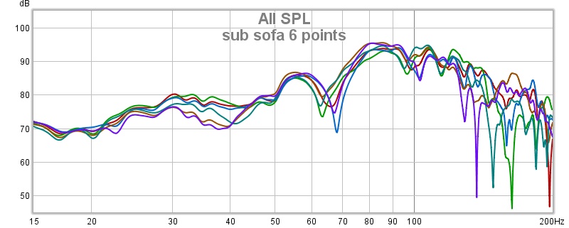

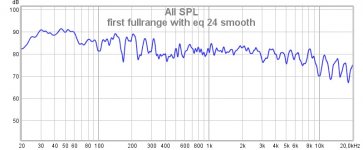

More measuring today and learning a lot. Hooked up my Minidsp 2X4 HD and applied a first filter from REW to the IB's. Crossing at 100 Hz both up and down just to test and sounds OK so far.
This is really fun! I'm amazed that this technology is so easy to get and the cost is so low.
Measurement at sweetspot with IB's and main speakers.
