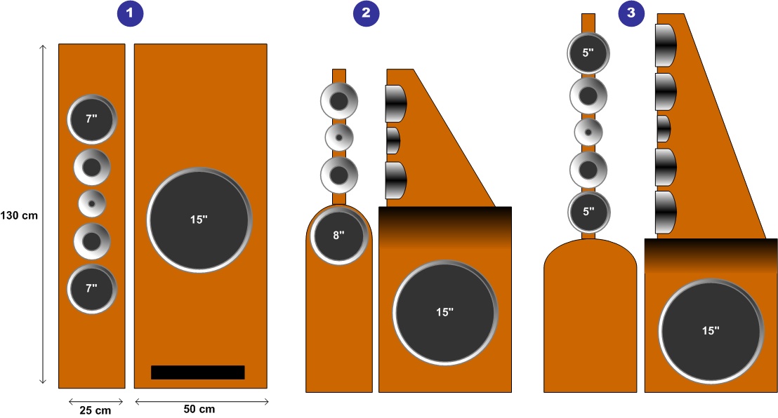

I am about to start a new 4-way project based on some drivers I have and other ones I could get.
I was considering one of the next three options (please see picture). From your experience, which one would you choose?
All drivers to be in sealed chamber except for the woofer(s) which are vented (low-side port).
Thanks and regards

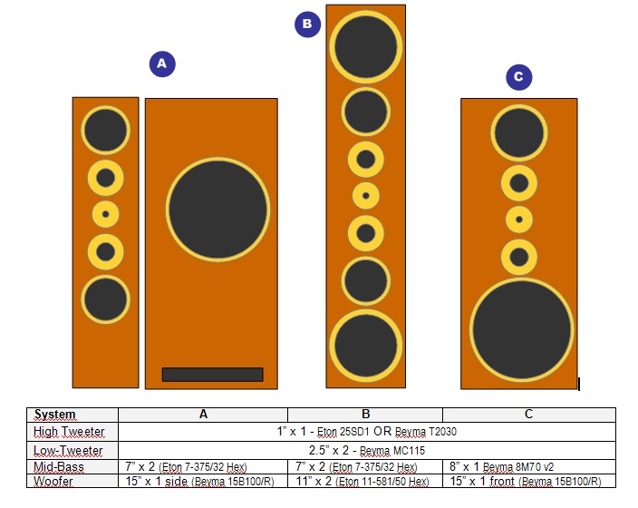

Take 2
Thank you everyone for the great tips.
I understand the multiple modules motivation, but the Beyma 15B100/R on vented configuration needs a 160 to 190L volume enclosure, making that impracticable. It can be done if used in a sealed box.
- On vented configuration 190L box it's at -3dB at 40Hz; on sealed 100L box it's at -3dB at 55Hz.
Since it is a 97dB unit, sealed is a viable if crossed really low and mid-bass units also work in the sub-bass. I mean, making it a 3.5 way and not 4 way design.
So, under your guidance I got to these 3 new possibilities (see new picture). First one vented 4-way, 2nd and 3rd designs sealed woofer 3.5way.
Design of these last two can be improved. Option 1 has to be a large box to provide space for the 15" woofer in vented configuration.
Please vote. 😎
