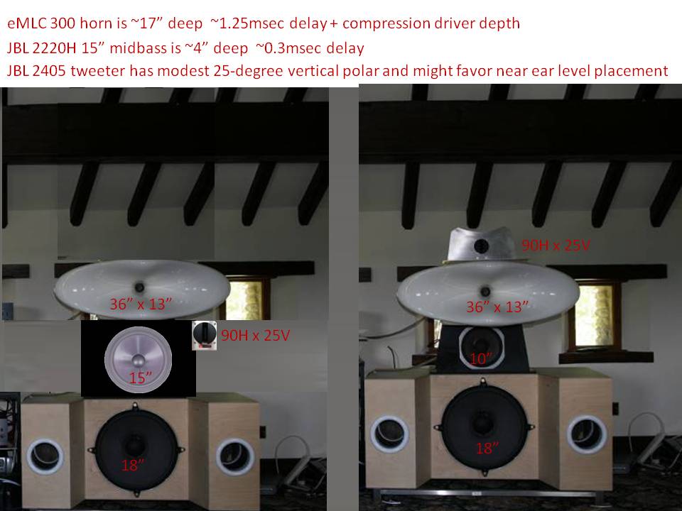

crash999, Did Santa bring you a pair of 15" JBL 2220H speakers for Xmas? (sketch of 18"+15"+eJMLC stack)
90H x 25V polar pattern super tweeters like JBL 2405H are often set near ear level, aimed at the listener, and distance-positioned by ear. Time and phase coherence across the listeners is not possible since 8kHz has a 0.4" quarter wavelength, and there is over 7" separation between horns. Lobing. I believe the main placement goal is to have just one lobe cover the seated listeners for even SPL and consistent sound stage.

I’m looking for mid Bass drivers to cross from the 2245s at 160Hz to the JBL 2450s at 800Hz...
Have you considered the JBL 2226? It is what JBL themselves often used for exactly this role.

David,My current system is still in "Beta Test" but similar to yours.
-Are the two 2245 woofers positioned away from the main midbass-horn-tweeter stack? i.e. the 2226 cabinet is at floor level
-What horn do you use in your current system?
-Where/how do you mount the 2405 tweeter?
___In-line above 2226 and below horn?
___In-line above the horn?
___On the side of the 2226 aimed at the listeners?
How do you set up the time and phase of the 2405 for the listeners?
No, the 2245 and the 2226 are mounted in the same stack, the 2245 underneath the 2226 but fairly close so they are acoustically coupled at crossover.
I try to deal with floor bounce with a carpet laid on sound absorption in front of the speakers.
At the moment it's an improvised radial horn, the final horn is around 24" wide plus transition radius to blend with the curved front of the woofer cabinet.
Around a 72 x 45 pattern, rectangular mouth, an exponential / constant directivity blend but influenced by Earl Geddes.
None of the above, I had it mounted above the 2226 but next to the mid rather than in-line, purely for convenience.
In-line and above the horn was my intention, but even at best it is impossible to maintain phase coherence over more than a tiny listener area. So the theoretically non-optimal side offset hardly matters.
It was aimed at the listener, as mentioned in your own post.
I do not have time delay options on the 2405 so phase/position was done entirely by ear.
I believe in measurement usually, but the response near crossover is so position dependent that it seems futile.
I just tried to keep power response more or less even.
When the final mid horn is finished I hope not to need the 2405.
They were purchased because the 2447 mid drivers that I tried initially needed just a bit more top end - or "air" (if I used that sort of subjective fluff term😉)
Best wishes
David
