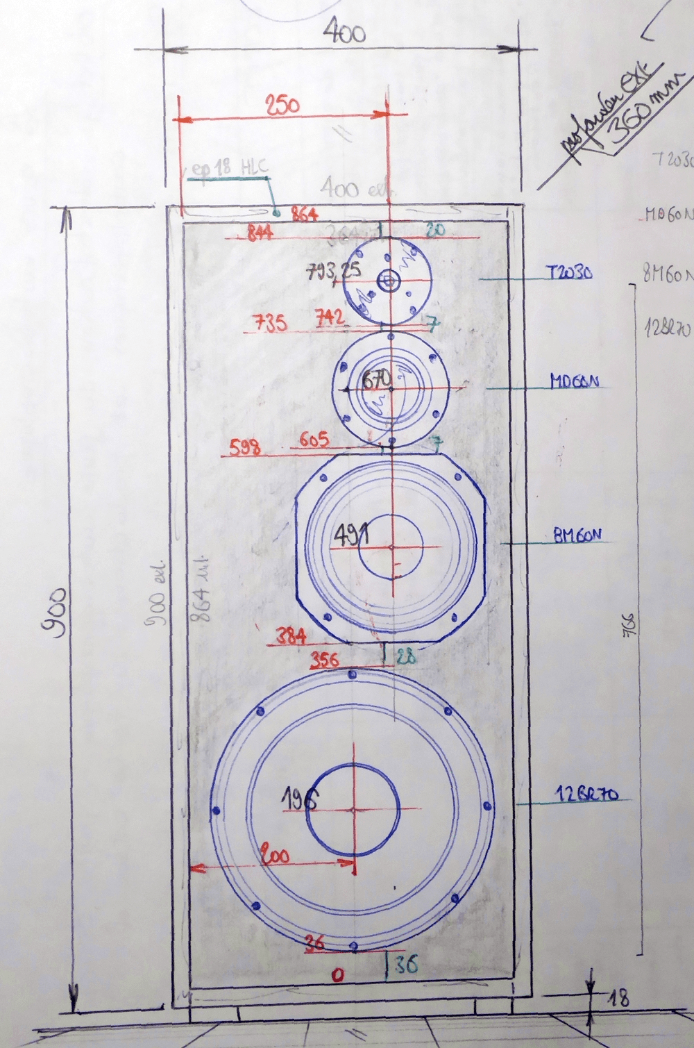

@jheoaustin,
Like you, I am planning to experiment a 4-way enclosure, now that I met success with my 3-Ways one :
This time, it will be a large sealed one :
Speakers are :
- Beyma T-2030 1.25" Tweeter.
- SB Acoustics Satori MD60N 2.5" Dome Midrange.
- Beyma 8M60N 8" Cone Midrange.
- Beyma 12BR70 12" Woofer.
Still with a passive serial/parallel Xover, the planned transition frequencies are :
W ---> CM = 300Hz
CM ---> DM = 3000Hz
DM ---> T = 7kHz
As you choose it equally, I opt for a large 8" Cone Midrange, in order to have a good low-mid tone, notably including the main part of the voices in its range. By the way, that's what I did on my 3-Way enclosure, and it's a very positive experience, offering a very lively tone, somewhere like if it was a "Wide-Band speaker completed with the rest", if I can say so...
T
Wow, this is very interesting, and congratulations on your success of the 3-way design.
On your 4-way design, your crossover is more like for woofer - mid - tweeter - super tweeter 4-way. Satori dome can go pretty low, so 3kHz seems a bit too high. Could you explain me your design choice here?
Anyway, I am very interested in the outcome of both 3-way and 4-way ones. Please update us on your progress. Also, what is the tweeter in your 3-way design?
