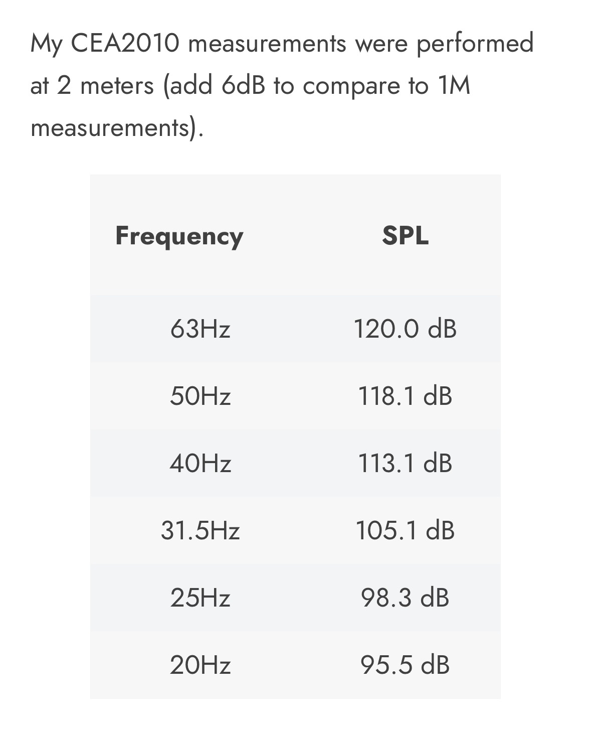

Let’s assume your SVS sub is the SB 4000. Under test it can produce at 1 metre
60 hertz 126 db
50 hertz 124 db
40 hertz 119 db
30 hertz 111 db
  • Room gain is an unknown variable so the above is only a guide.
  • It’s assumed you are using a single subwoofer.
These numbers reflect the displacement of the sub woofer driver and the max input power 1200 watts rms, 4000 watts peak.
Reactions: jheoaustin

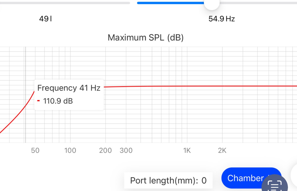

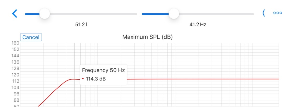

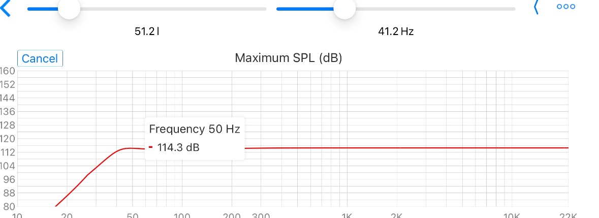

Now for comparison purposes l have constructed a simple model of the Volt 2500.1 using dual 2500.1 woofers.
The woofer is rated at 250 watts
The sensitivity is 88 db
Effective efficiency increases with dual woofers. The output increases +3 db
An optimum bass reflex tuning 42 hertz in 52L enclosure (two woofers)
Parallel connection
Max spl at 50 hertz 114 db Stereo 117 db
40 hertz 112db Stereo 115db
60 hertz 126 db
50 hertz 124 db
40 hertz 119 db
30 hertz 111 db
So to compare both the sub (single sub) and stereo dual volt 2500.1 there is a 6 - 7 db difference in the respective outputs at 50 hertz. This is being optimistic at the limits of the Volt drivers.
In real terms single you would need 4x more power to match the SVS sub. But the Volt drivers lack the displacement to achieve that.

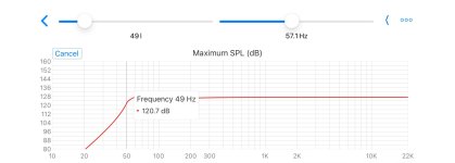

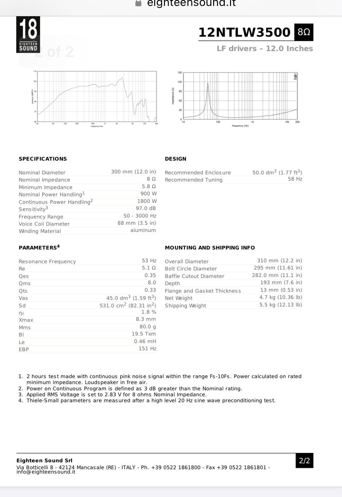

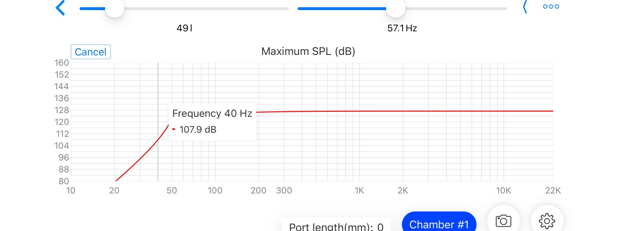

Now if we look at a single 12 inch pro mid bass woofer manufactured by 18 Sound.
The trade off here is efficiency versus output at 40 hertz compared to the dual Volt 2500.1 enclosure.
This is a high performance state of art dual gap differential drive woofer with excellent mid range resolution. The impedance curve is flat through the midrange.
Enclosure tuning 58 hertz 50 L
Sensitivity 95 db
Rated power input 900 watts rms
Enclosure tuning 58 hertz 50L
Maxoutput 50 hertz 120 db stereo 123.7db
40 hertz 108 db stereo 111 db
60 hertz 126 db
50 hertz 124 db
40 hertz 119 db
30 hertz 111 db
As can be seen objectively the 18 Sound single woofer (8 ohms) is a closer match at hertz and above. It’s also 4 db more sensitive (91 db versus 95 db ) and an 8 ohm load compared to the 4 ohm load of the dual Volt
In practice while an 8 or a 10 inch cone woofer may seem subjectively adequate as a stand alone music loudspeaker when paired with a sub like a sealed SVS everything changes. You may find the need to raise the sub crossover point to 100 hertz so the Volt main enclosure isn’t swamped by the dynamic output of the sub. If you are using a single sub a 100 hertz cross over point may be sub optimal.
This is a displacement and efficiency problem with smaller hifi woofers.
The 18 Sound driver trades the 40 hertz output for higher efficiency and displacement in the 50 - 1000 hertz pass band. This particular driver will most likely have lower distortion due to its differential motor voice coils.
Of course considerations like the WAF need to be considered. But some work on the front baffle can overcome these potential barriers to a no holds barred system.

https://www.madisoundspeakerstore.c...eas-excel-w22ny-003-e0097-08-8-nextel-woofer/
Out of curiosity l googled a Seas Nextel 8 inch woofer.
The above link describes the woofer under a sealed enclosure (Qtc=0.5) and a ported enclosure Fb= 28 hertz.
Suggested box alignments:
  • Vb 14 liters (0.5 cf3) internal volume sealed and stuffed, F3 about 68 Hz
  • Vb 40 liters (1.4 cf3) internal volume vented, Fb 28 Hz, F3 39 Hz, single port 2" x 5.6"
  • Vb 70 liters (2.5 cf3) internal volume vented, Fb 23 Hz, F3 35 Hz, single port 2" x 4.5"
  • Vb 95 liters (3.3 cf3) internal volume vented, Fb 21 Hz, F3 39 Hz, single port 2" x 4"
