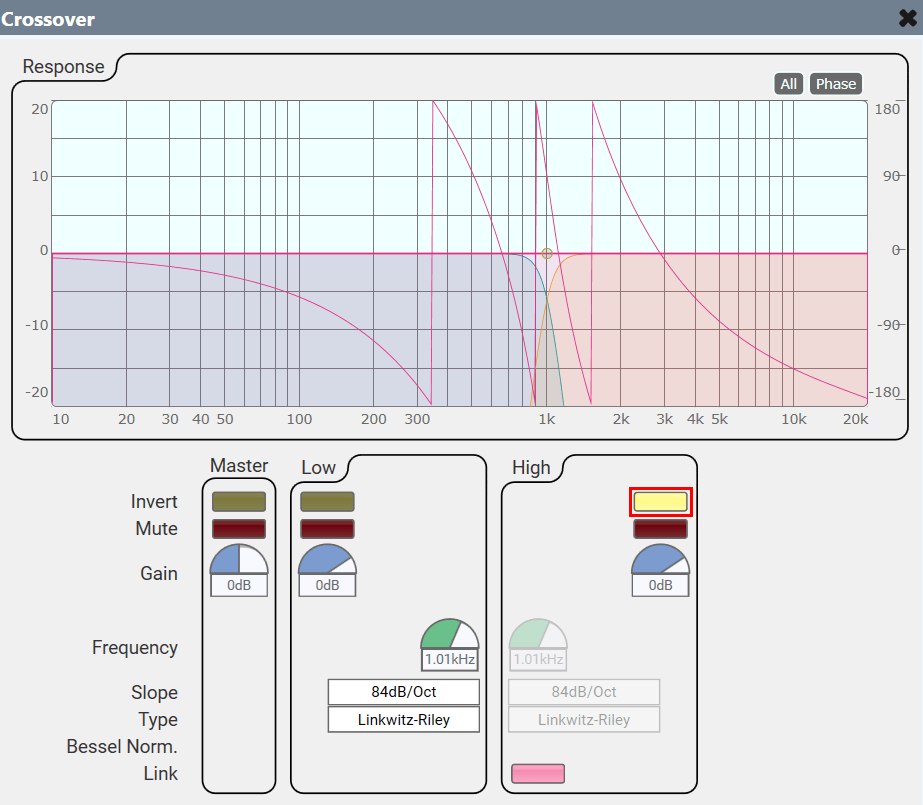

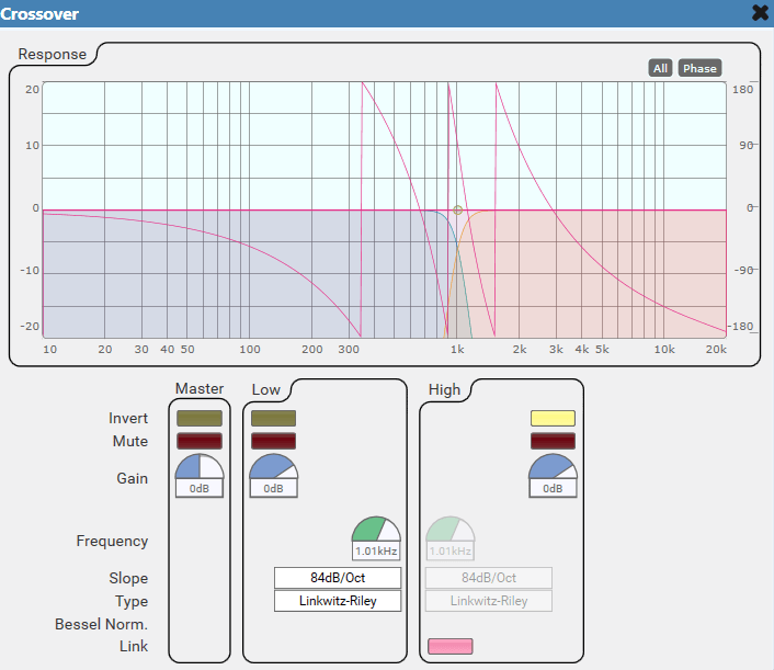

In IIR crossover filters, Only LR4 sums flat electronically. LR2 creates a peak and higher ones create dips. I wonder what they did when they were using LR8(48dB/oct).
All LR's sum to flat fluency magnitude response, with the odd multiples of 12dB/oct needing a polarity reversal.
Here's an example of a whacked out, never to be used, LR 84...just to show good summation (and the needed polarity reversal)

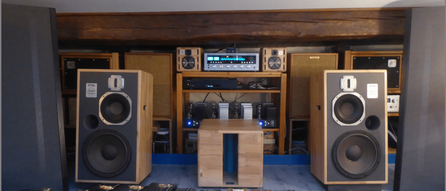

For EM, I often use a "multi-stereo" system - if I can say so - with my 375L 3-Ways driven by one amp (Accuphase E-560), plus my SMGb driven by another amp (MC-7100), and the subwoofer (with its integrated LPF/amp module) hooked to the SMGb as an infra-bass complement (<40Hz) :
Once balanced, the SMGb and the SW acts as an "Ambient Enhancer" to the 3-Ways 375L, providing a large sound in my small auditorium... For example with this :
Or that :
Among so many others !
On the picture above (taken from the listening position), my 4-ways project would take the place of my Heresy I HBR... Fortunately, the acoustics in my Tiny (dedicated) Auditorium shows no notable flaws and is fine for near-field listening (due to its size). No active filter, no DSP required...
