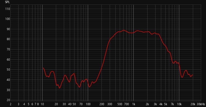

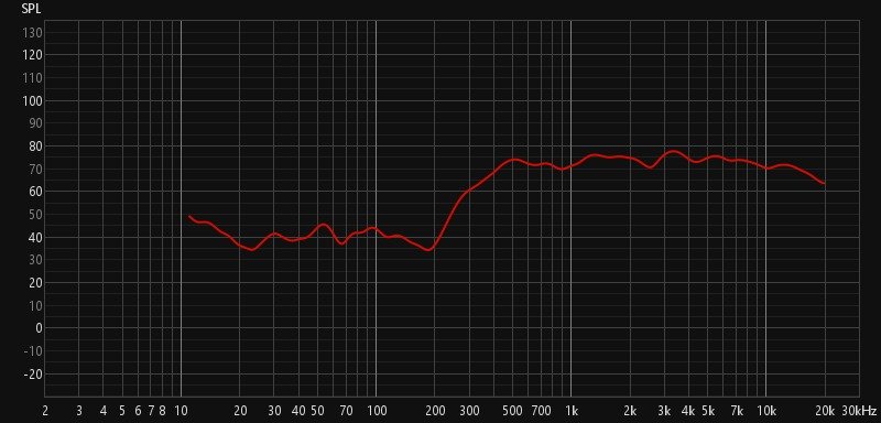

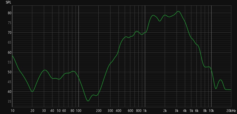

Previous measurements was with a bug in my crossover. But even with right crossover 400Hz-1kHz is way down. However with the right crossover it still sounds amazing despite <1k being way down on the mid driver / horn. This is a measurement of mid only. Around 1m from horn.

What value capacitor are you using on the input side of the autoformer?View attachment 1472977

Are you still using the resistor across taps 0 - 5?
4.7uF. And using - 12db tap currently. So that should give a reflected impedance of 125 Ohm. And a crossover of around 280Hz. (The tweeter is not connected with the autoformer anymore. Using lpads.) Will update schematic soon.
Forgot about the resistor. It's there. Obviously changing my crossover a lot! Thanks. Will remove and test again. I copied that from a different schematic but that uses big caps.. Duh.. I'm such a dumb *** sometimes.
