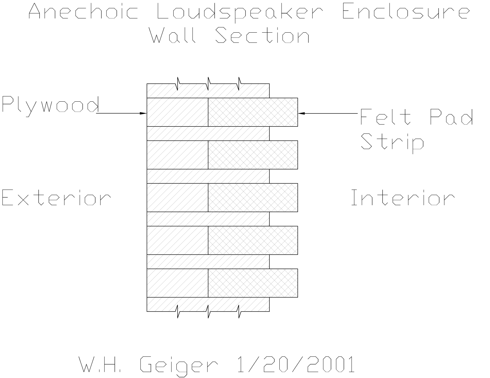

Rigid Mount Only
G'day,
Suspend the aluminum baffle from a wire and tap it with a hammer. What you hear should convince you not to attach it to an enclosure body using an elastic membrane or other such members.
WHG

G'day,
WHG
