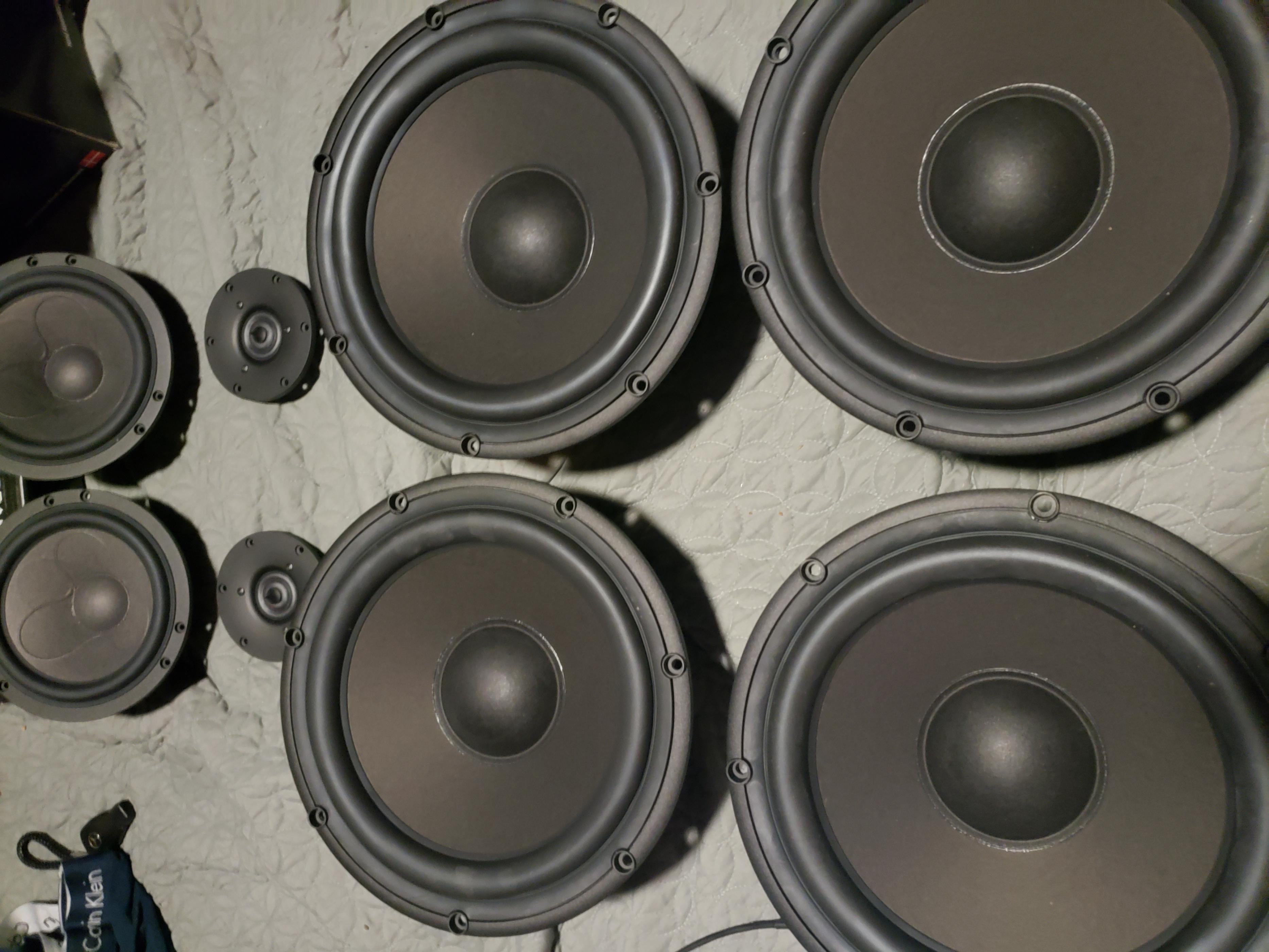

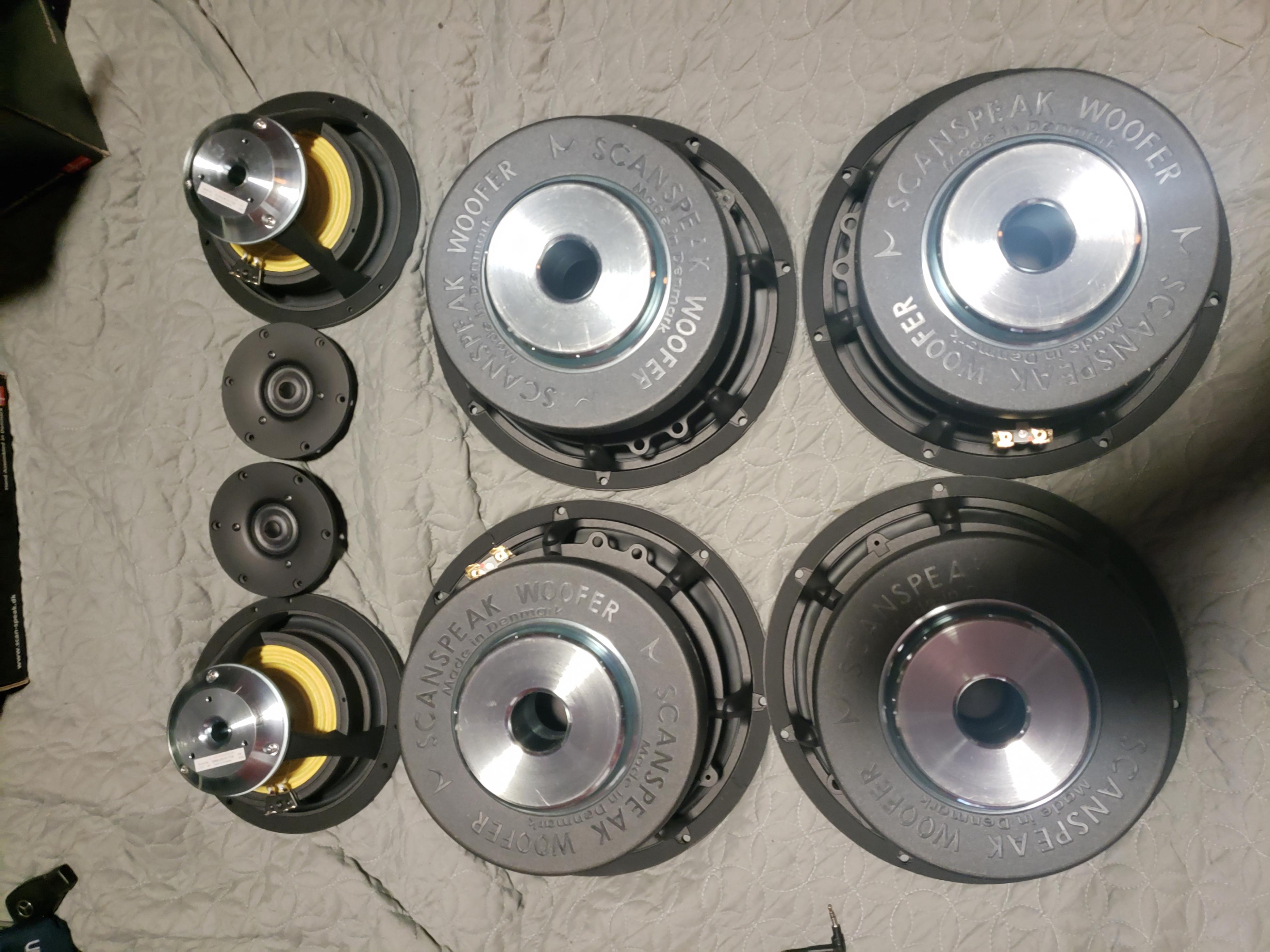

Personal 4 way active build all scanspeak
First items to arrive
4 x 11inch scanspeak woofers

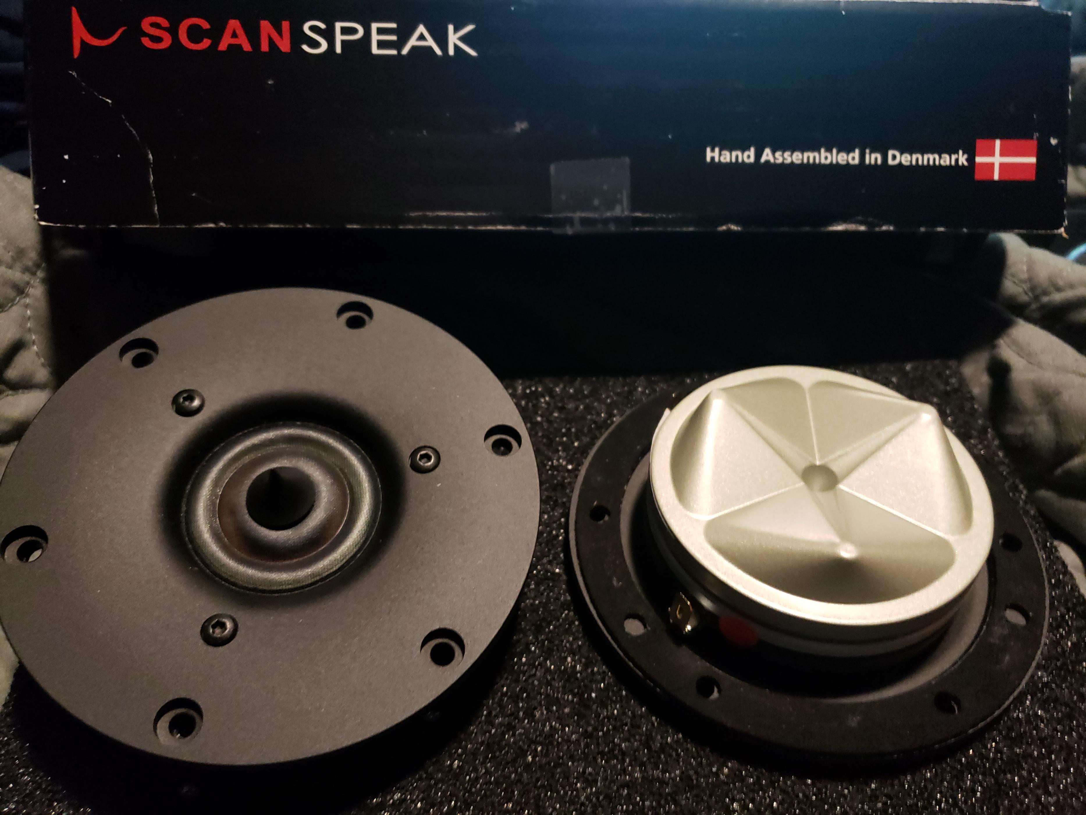

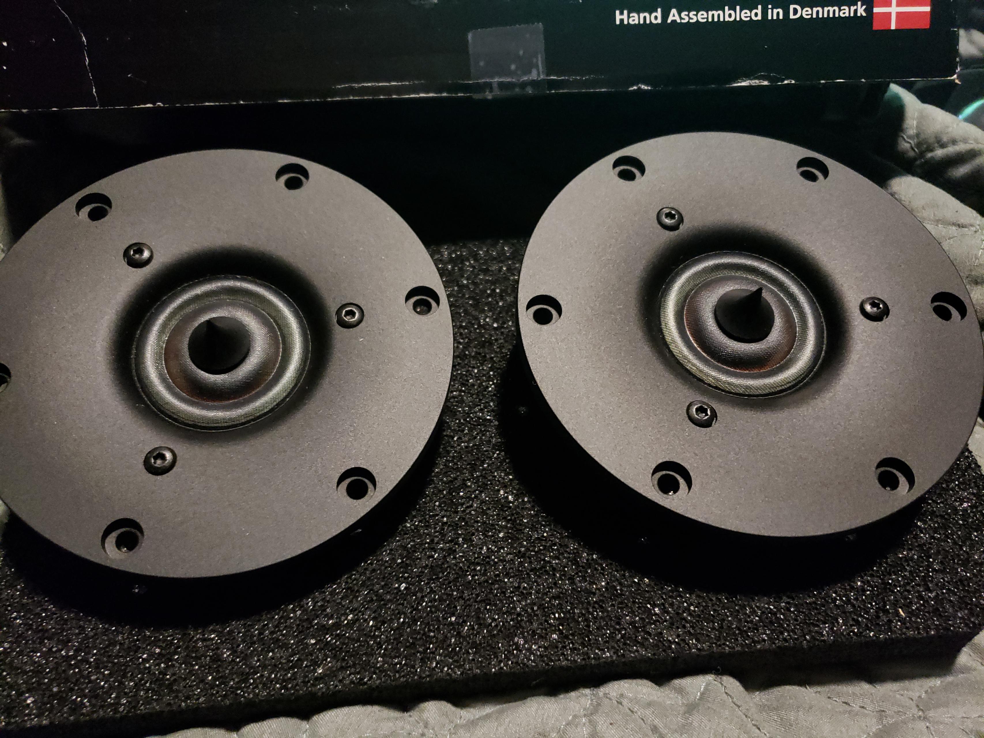

R2904 is ringradiator, generally ringradiators do not like low crossover points. Did you consider 7100?
I would suggest to add waveguide like wg148 or one of Augerpro waveguides, use 7100 and try crossover below 2k. Also cut both mids into waveguide to minimize CtC.
Bliesma t34b would be also step in the right direction.
+1
The Bliesma T34B would be an excellent tweeter for your project. It has very high output, very high sensitivity, flat response, and the distortion is low even down at 1 kHz (very hard to achieve in tweeters). I would be comfortable crossing this tweeter at 1.5k with 24dB/octave slope in a high SPL application.
