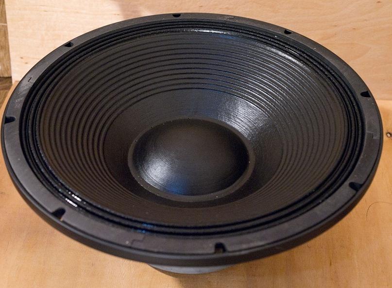

After some time a project changed a lot
Woofer - B&C 15ps100
Mid-woofer B&C 8ndl51
midrange radian 950pb + Yurichi Arai A-300E horn
tweeter Foutek neo cd3.5
dac pcm1794 apergio h-cmos (10v outup)
amp for woofer LME49830 2 pairs of sk1530+sj201
amp for mid-woofer LME49830 1 pair of sk1530+sj201
tweeter amp - power follower 99 with 2ск1529 and 10uf output polyprop cap
midrange amp - power follower 99 with 2ск1529 and 100uf output polyprop cap
steped 8 chanel attenuator
Rlc correction for mid-bass and bass session

the drivers will be recessedWhat does it sound like and why are the bass drivers not recessed?
it is 3d -model
it is 3d -model
What program did you draw the 3D model in it looks real?
3dmax+vray
the 3d-modeling is one of my real work.
all will be in cherry finishWhat's the final colour?
