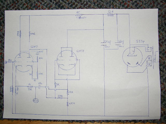

I spent a couple ofhours tracing the circuit from the board, leaving out the tone and volume controls, I'm pretty sure it's correct....

OK, you have cascaded common cathode stages feeding a cathode follower made from paralleled sections. Plenty of drive there.
The design uses both local and loop NFB. The common cathode stages don't have bypass caps. on the cathode resisters. That's local current NFB, AKA degeneration. The O/P coupling cap. feeds both the RCA jack and the NFB loop.
Even with losses due to degeneration, lots of open loop gain is present. That makes sense, as tone controls are present (not shown). TCs frequently "eat" gain.
