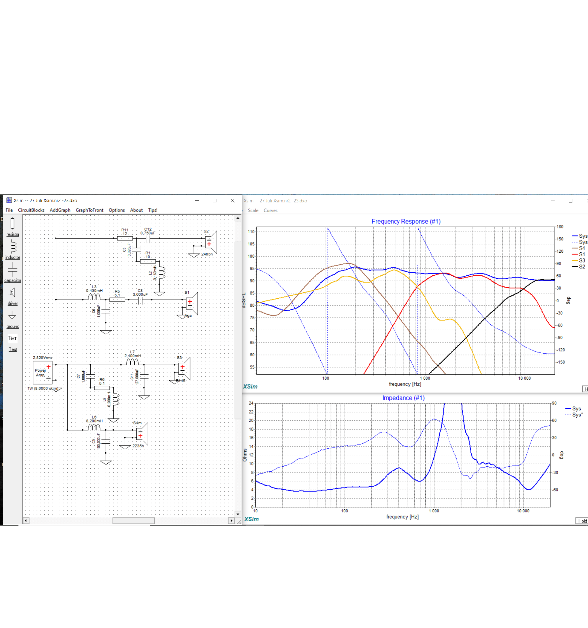

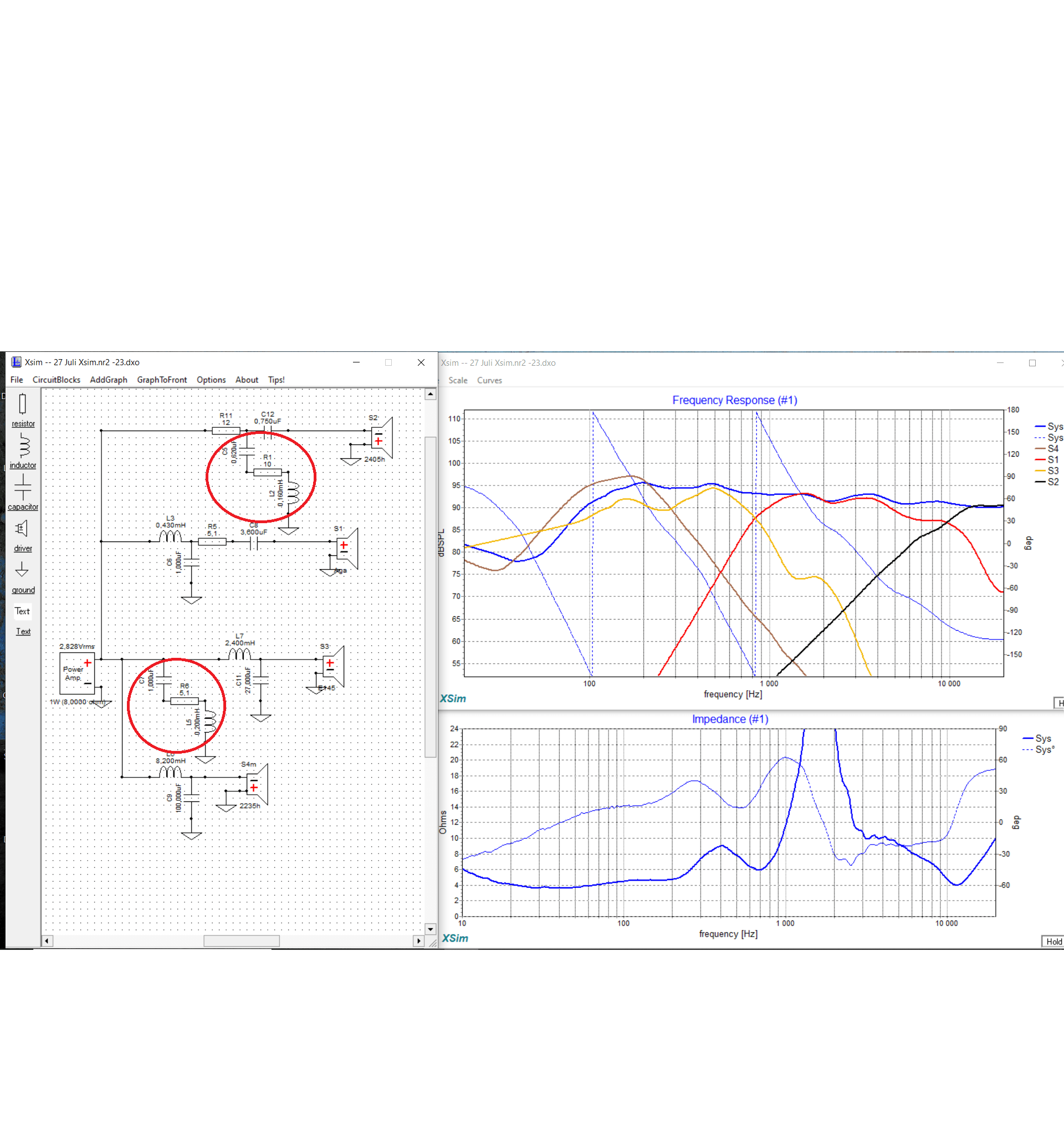

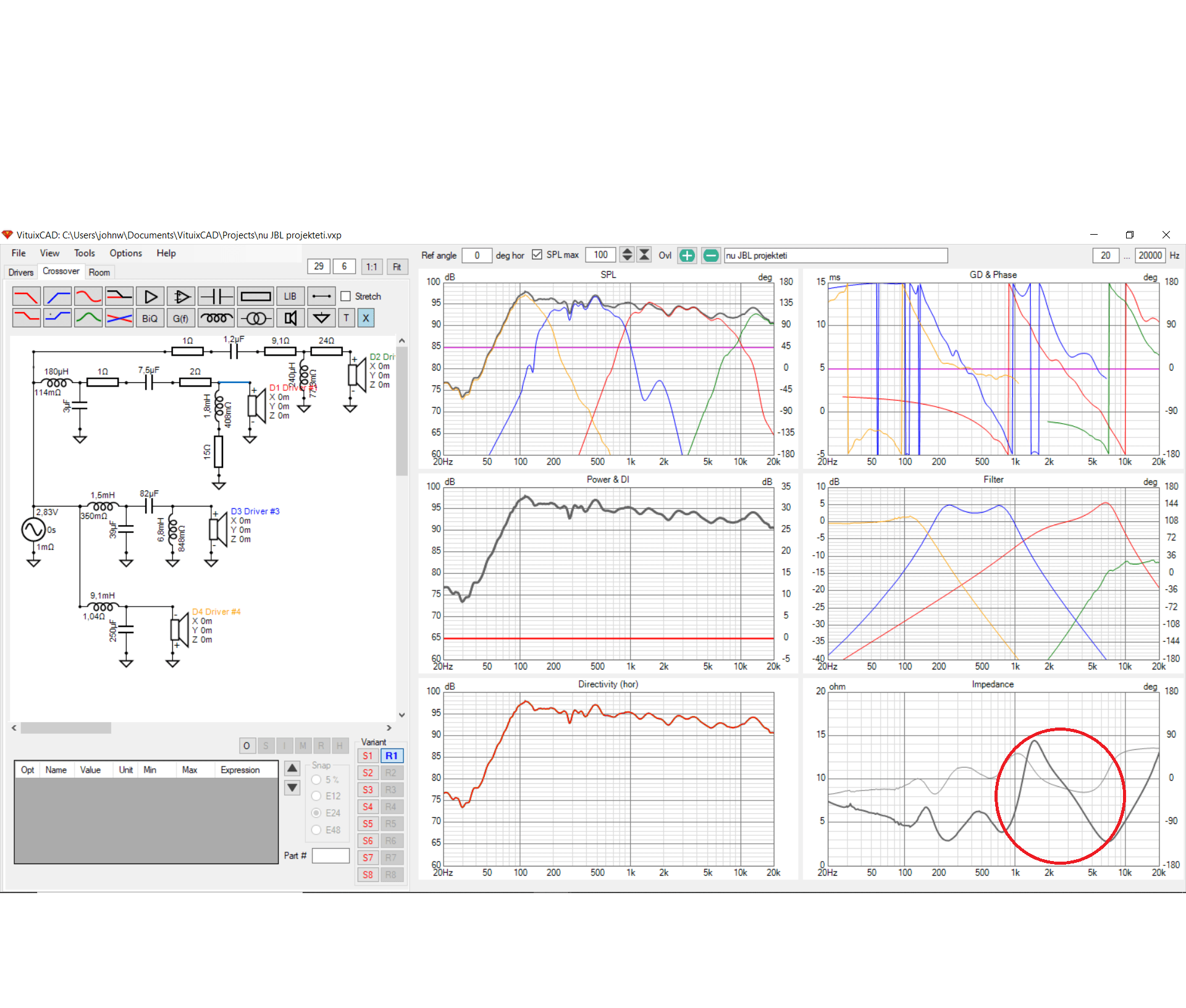

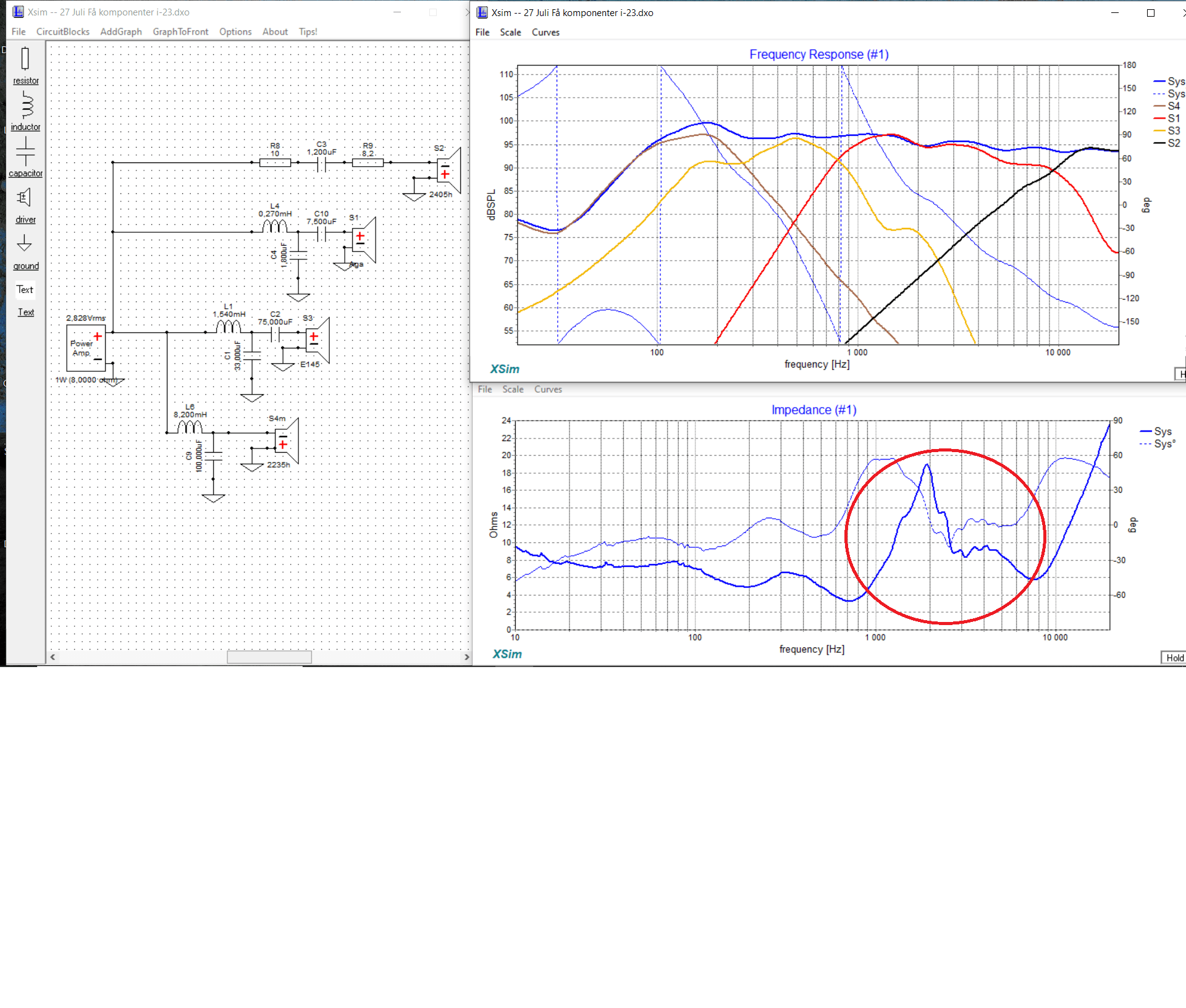

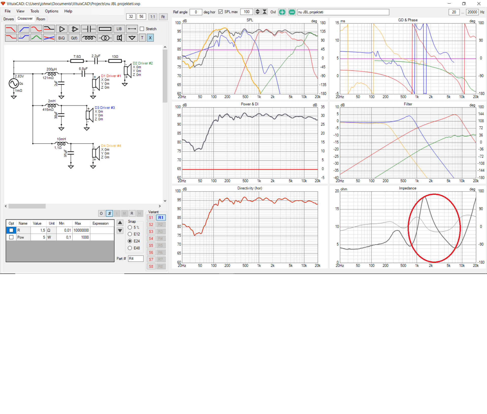

4 quite different passive 4-way xover with almost the same outcome possible?
Been simulating both in Vituaxcad and Xsim with my own measured 4 drivers, and made 2 simulations on both programs.
But have used the impedance curves from JBL specs, but DON´t have a impedance curve from the Aga cd working from ca 8-900-9,5 K!
So ignore the impedane markt in red circle on the simulations.
The drivers are Jbl 2235h, Jbl E-145, Jbl 2405h and a 10 kilo compression driver from Swedish Aga/Baltic in a 25 kg diy Jbl 2344a Bi-radial horn.
Xoverpoints are around 200, 900 and 9,5 K.
Can these 4 simulations be trusted, or do the low values of the components fool the program?.
Is one of the simulations preferable to the other, and if so why? (if you remove the financial)
Will all these different simulations sound relatively the same, or can the supposedly "equal simulations" sound very different even if they look alike?
I attached all 4 simulations separate, and one with all 4 in same foto.
Im in trying to learning some more about passive filter mode.
EDIT...Forgotten to tell that 2 are 8 ohms driver, one is 16 ohm and AGA cd is 20 Ohm !
Best regards John

There are broad differences that might have an effect, but would do so regardless of the crossover type. Eg the system response being the same when the driver responses are different. What effect specifically are you asking about? Also can you expand on your low value comment, what is low?

Thanks Allen for your response, your knowlege and experience is valuable 👍
With "low" i mean for ex caps under 0,8 uF, coils under 0,1 mH in combination with higer values resistors.
I can imagine that there are a lot of "changes" in an electrical composite circuit. because the components' resistance, current and voltage gain, capacitance and other properties are not constant, but can depend on voltage and current. (That we can see)
I also notice that if certain values of components are "above a certain limit", then an increased value (or decreased) of a component elsewhere in the electrical chain makes "no difference" at all.
And that things may happen in the circuit, which we or the simulation program cannot "interpret" or see
And what does a series of LCR-notches create in parallel in the tweeter and midbass circuit, apart from impedance adjustment?

Yes the values can go out of range of the circuit and become 'insignificant'.
Yes the interaction is complex, but you can see the end effect in the simulator. Look at the separate responses to see you are using the drivers properly. Look at the impedance to see the amplifier can deal with it.
Different circuits can give the same response, sometimes they are just the same. Other times the lower impedance is a concern.
Sometimes you have a second order filter, say a low pass that uses an unusually small inductance. With a high Q, the circuit will draw in more current and increase the response. For this to happen, the impedance falls.

Witch simulation in post #1 would you prefer ?
Fewer parts, cheapest, higher order ?
It's easy to point in the right direction and then to experiment... but to give a straight answer here would take more study, perhaps looking at polar plots. Working off responses as you are here is fine if you have an understanding of the behaviour of the drivers and cabinet.
Too steep and too shallow can both be a problem in some situations. You also have to fit in with the basic needs, such as avoiding cone breakup.
