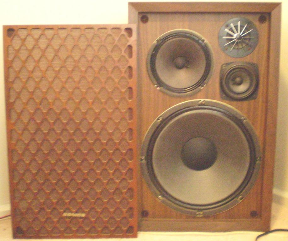

Hi there fellow DIY audio enthusiasts! i have started to build up a collection of solid state amplifiers, and until now i have used one set of 8 ohm speakers which seem to be more than adequate - however i was wondering what the difference between 4 and 8 ohm speakers is? how does it impact sound? are 4 ohm speakers suitable for vintage solid state amps? Appreciate anyones help!
It will depend on the amp but most won't, especially cheaper ones.pezza89 said:are 4 ohm speakers suitable for vintage solid state amps?
Typically with SS amps distortion Approx doubles when you move from 8 ohms to 4 ohms. Also current requirements for a difficult load is increased.
dave
dave
thanks for the help guys! so based on all that...i have a jvc s-71 which has a massive transformer and caps (approx 90watts rms) im assuming it will be safe to use 4 ohm speakers however being vintage I was a little cautious...maybe i should 8 ohms would be safer?
pezza89 said:maybe i should 8 ohms would be safer?
safer for sure, and likely sound better
