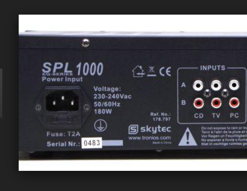

I'm not gonna sugar coat it.. you bought junk. That amp doesn't produce anything close to 1000w it's more like 130w/ch at 8ohm and the speakers aren't gonna handle much power or get very loud. And no you can't bridge the amp to get more power. I'd suggest you send all this stuff back and go rent some real PA equipment.
1000 watts? 500 watts RMS?
It draws only 180W from the wall.

Skytec lol their right up there with Pyle when it comes to power figures ie 1000 watts per channel measured into 2 ohm at 90 % distortion . Reality is the amp is probably around 50 watts per channel @ 10 % distortion into 4 ohm. .To be honest if it lasts the length of the party you did well. 🙂
