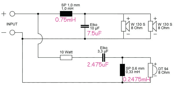

I have a project where I need help calculating a 4 khz crossover.
The configuration is
1 DT 94 8 ohm and
2 W 130 S 8 ohm in parallel.
The volume is 13 liter and I use two BR 6.8 tubes
I know that a 3khz Visaton crossover looks something like this, but the W 130 S sounds very good up to 4khz.
What would a 4khz Visaton crossover look like for this configuration ?
1 DT 94 8 ohm and
.... a 3khz Visaton crossover looks something like this,.....What would a 4khz Visaton crossover look like....?
Logically: each part adjusted by 3/4.
