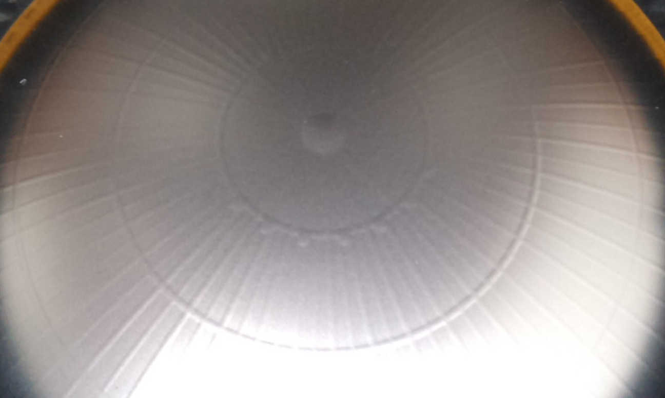

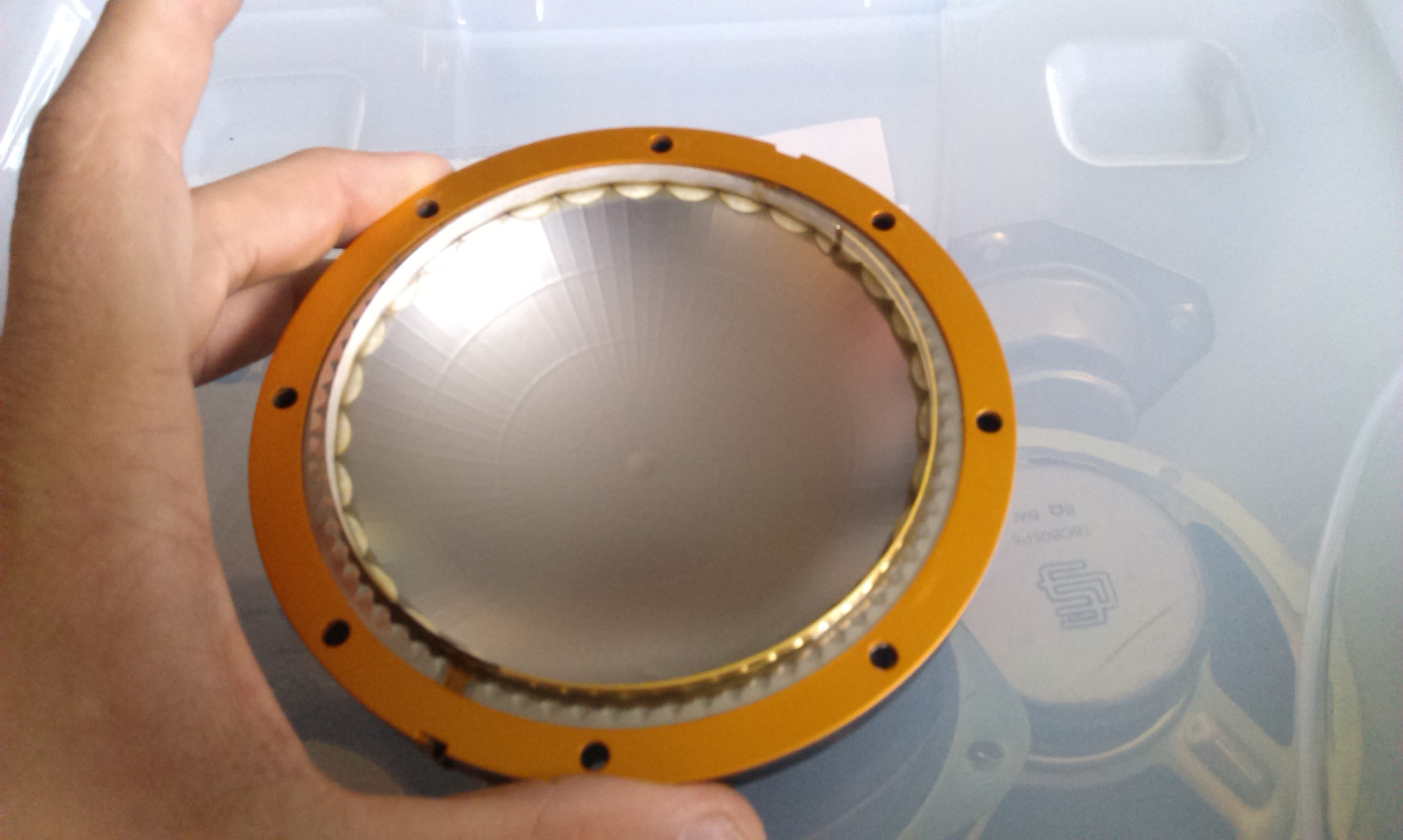

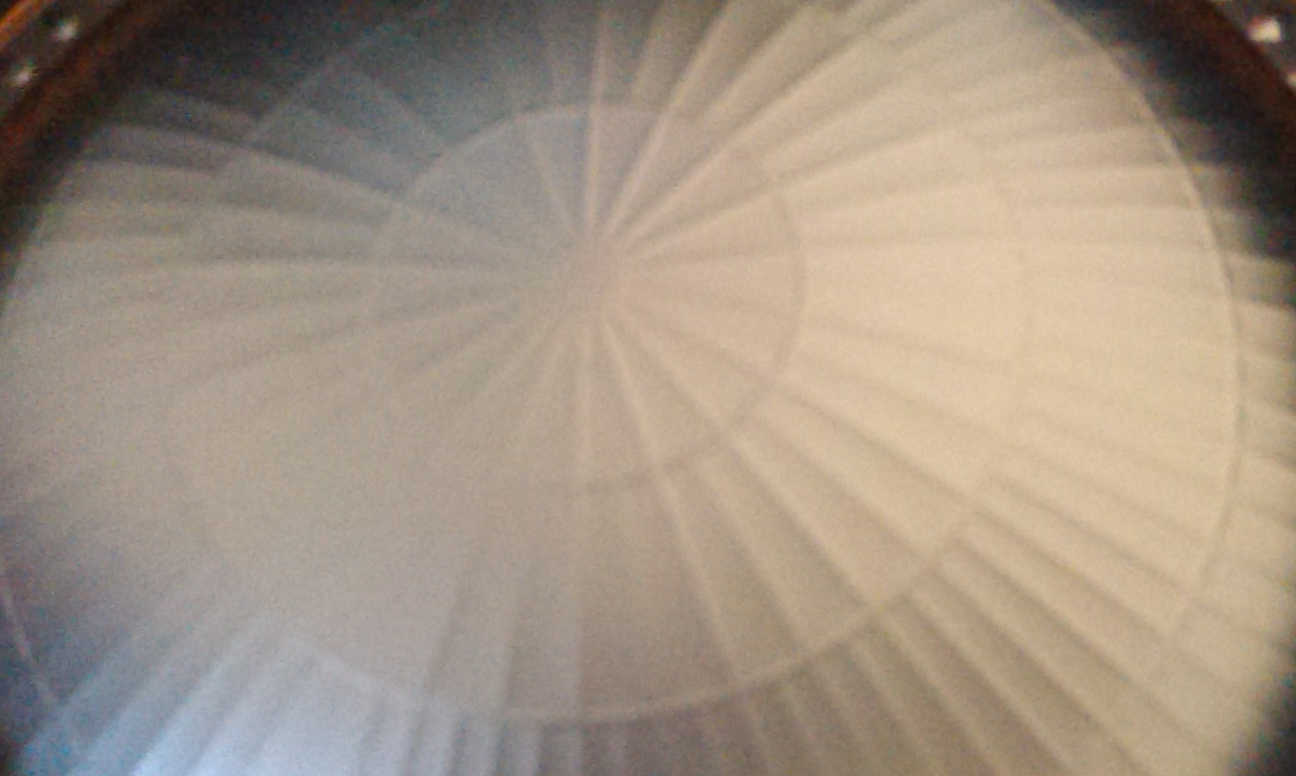

I have 2nd hand 2445Js and diaphragms of unknown origin. One has a normal-looking rib pattern, and measures normally. One has an odd looking rib pattern. It measures better. I'd like to know where I can get more of these! Does anyone know what it is / who makes it?
Visually, the difference is that the radial ribs are much fainter in the centre, and there seems to be some intentional asymmetry. They are difficult objects to photograph, but I gave it a crack.

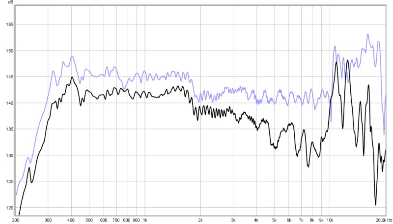

The attached graph is mic in morn mouth, with most factors the same: horn, eq (a low Q shelf to flatten the 1-8kHz range), and the the two old 2445J cores have consecutive serial numbers.
I shifted the graph of the unusual dia by +5dB to make it less visually confusing.
With the normal looking dia, I measured it when I first got it, then after cleaning out the gap, then removed and replaced the dia multiple times (going slowly, while playing test tones to avoid buzzes / rubbing) - and I never got it to measure any better than this.

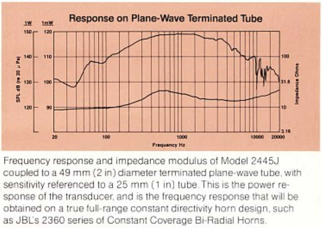

Thanks, Frangus.
This illustrates diminishing returns pretty well.
I started with a longer horn, then spent a lot of time extending it ...and it only gives ~100Hz more extension.
Ditto the HF. My mystery diaphragm measures well, particularly in the top octave... but after eq, yours also measure well.
Question: if you remove the smoothing you used in REW, does the extra resolution show a single bump at ~13kHz, or does it show multiple spikes? I wonder if the real effect of the ribbing (on later diaphragms) was to smear a single resonance into many.
