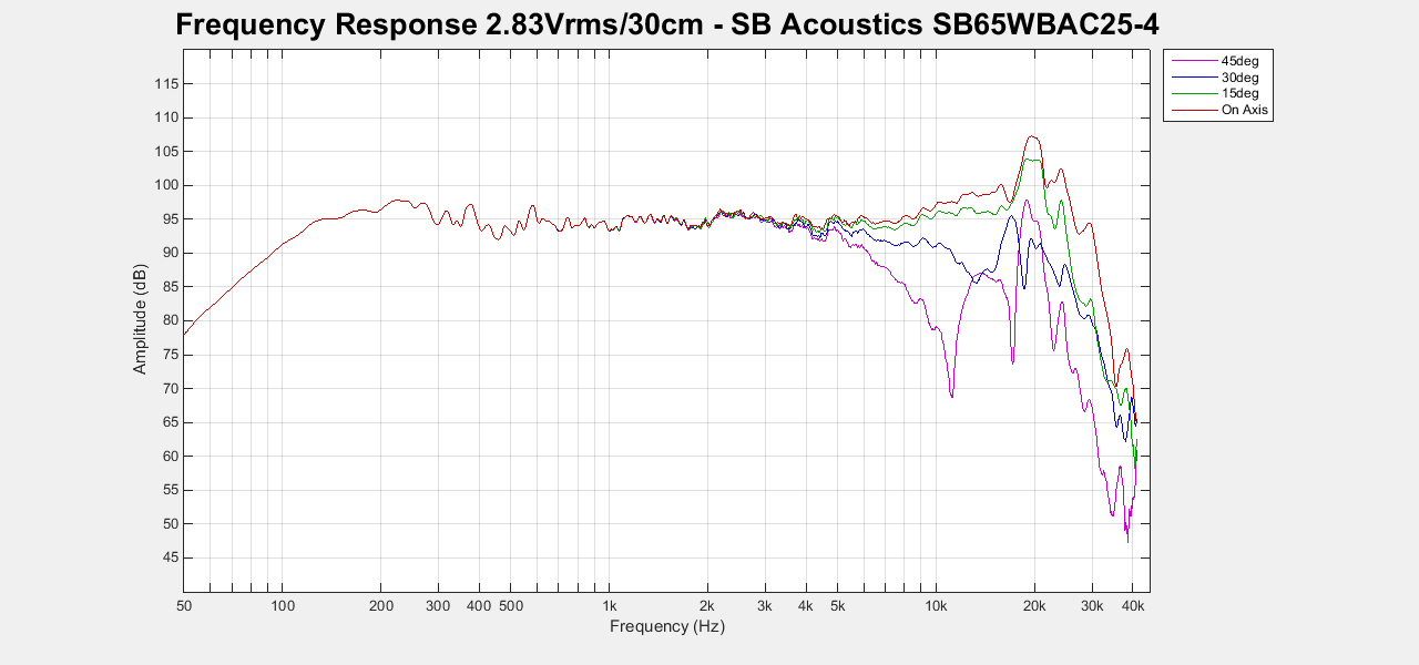

There seems to be different camps here, some listeners must have huge diaphragms for midrange use for a natural sound, and others wants small diaphragms for the same reson. What compomises are you thinking of?
In general, a large diaphram will move more air more easily so will play louder and potentially have greater “dynamic” impact. A smaller cone will typically have better dispersion aand mid/HF response.
The exact details of course are in the execution of the drive unit. Balancing these with my personal preferences (compromises i can most easily live with), is the Alpair 7.3eN (or A7 MAOP (very rare)). The new Alpai r7ms with no spider looks even more interesting, particualrily as a mid (or midTweeter). Here an example of a speaker that turned out fantastic based on the A7.3eN.

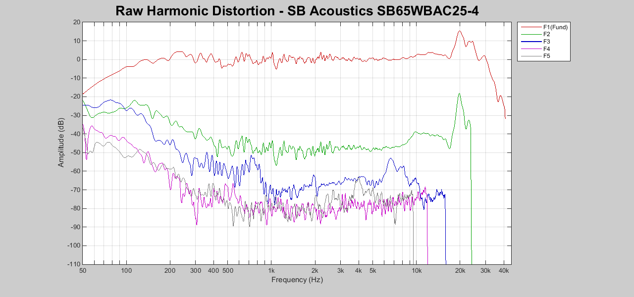

Damn, the Peerless Tymphany is out of stock for quite some time. Now looking at alternates Fountek and Dynavox
Dynavox LY302F 3-1/2" Full-Range Driver
..though the smaller diameter SB Acoustics drivers would be better for your application.
you wouldn't be referring to the 2 1/2 inch unit would you? That seems so small to be any good lol.
-and yet its performance is excellent, and with 4 drive units: very well suited to your design (..well, unless you have a slow roll-off high pass filter around 250 Hz.)
https://www.diyaudio.com/forums/multi-way/348122-4-inch-driver-recommendation-2.html#post6045921
..if you move the low-pass point to around 4 khz, then 4x 3 1/2" Dynavox would be (overall) better.
