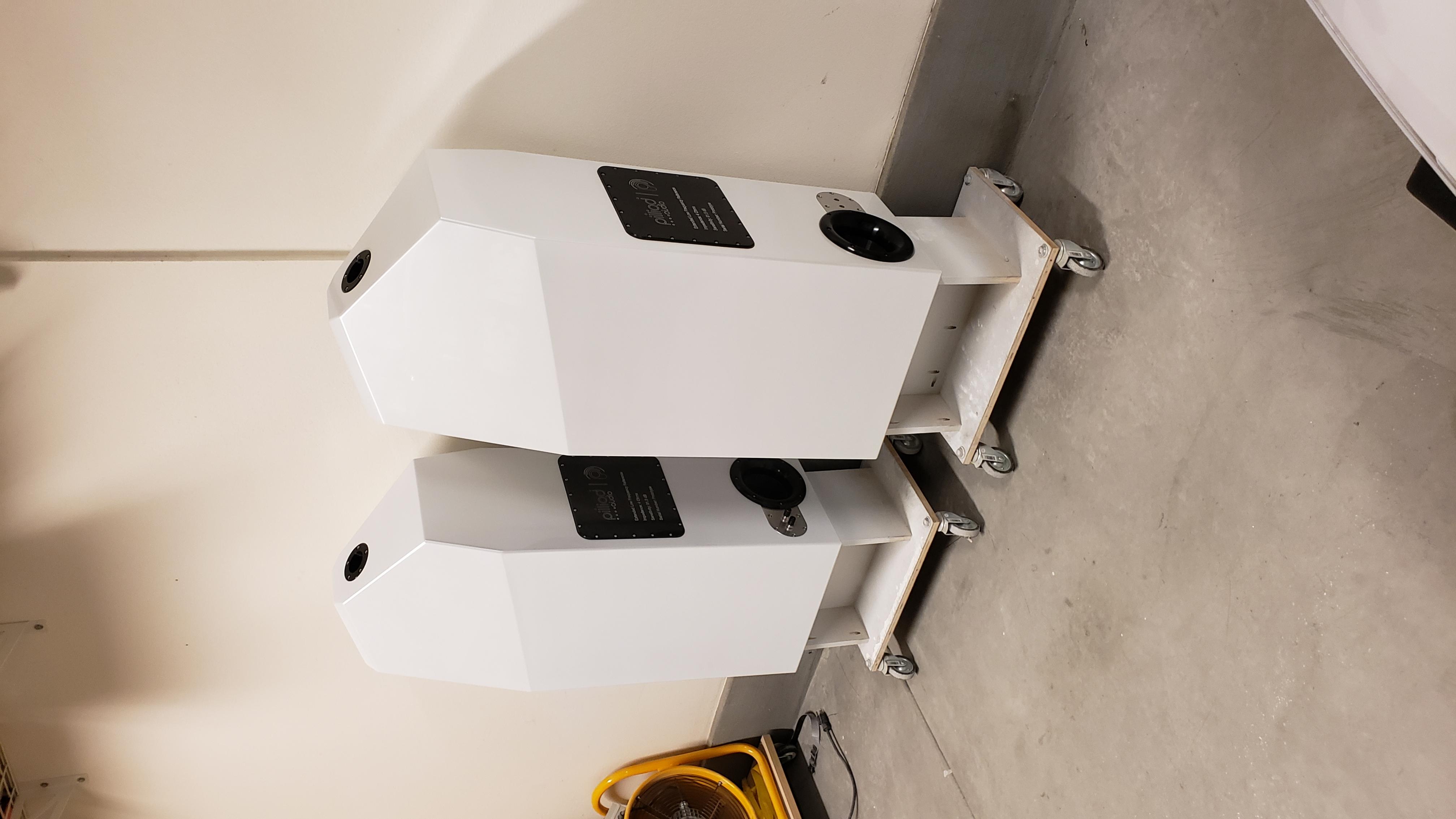

Finally done
These are the speakers that were inspired by this thread. Just figured I would wrap it up.

sorry for the images sideways
BTW, The material is 18mm baltic birch with a layer of thick dynamat on the inside. There are not mechanical fasteners in the wood and it's held together with normal wood glue and some polyurethane adhesive. The internals are reasonably well braced. The bass section extends into the top part of the cabinet for additional volume. The finish is polyester primer, followed by House of Kolor white DTS primer, followed by a custom shade of white basecoat, and 3 coats of House of Kolor Sno White pearl mixed at 33%. Then 4 coats of clear. The aluminum wash machined on my Haas VMC with Pierson vacuum chucks. and the port was sent out to a friend with a VERY expensive DMG Mori turning center. All the wood was cut on a heavy 4x8 router with centroid control and yaskawa servos.
The rear photo shows two ports, one small diameter near the top and one large diameter near the bottom.
Is the top port used for the midrange and the bottom port used for the woofers.... i.e. a ported midrange? Most 3-way designs use a sealed midrange as one of the main benefits.
Does the top "hole" serve a different use?
Excellent selection of drivers.
