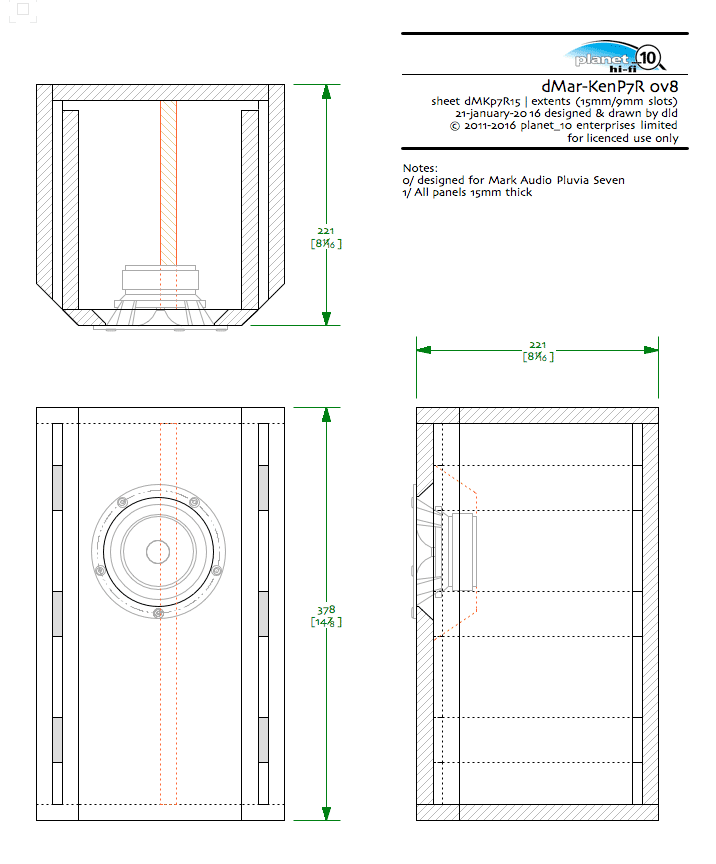

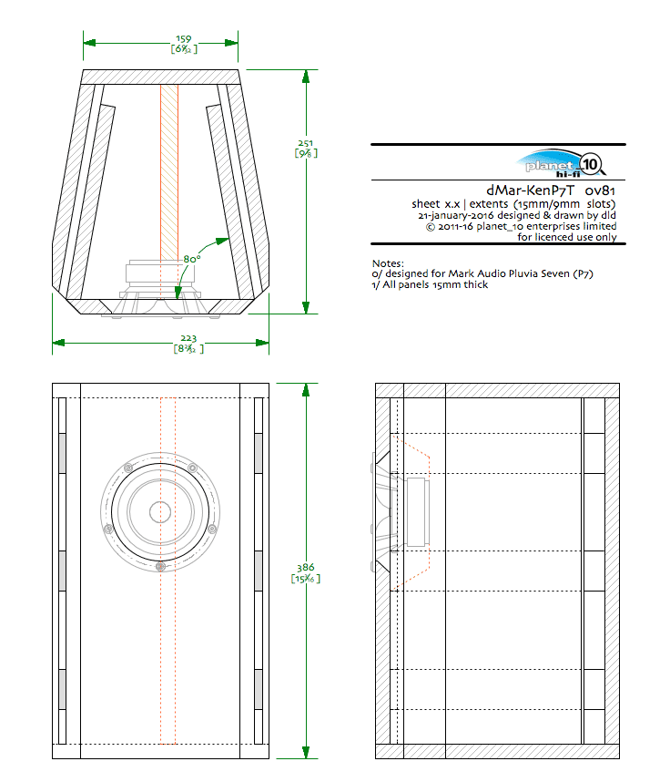

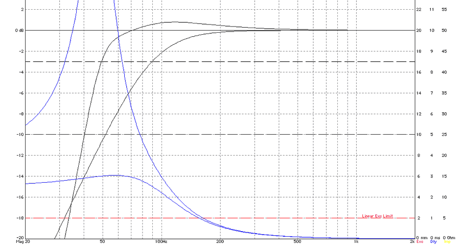

OK… it is not overly suitable for vented, a 9 litre miniOnkne with high R vents works to knock the peak in the sim down, the other is 9 litre butterworth sealed with no damping. To get a significanrt drop in Q you have to go real big, up to 135 litres. So as long as sealed is at least 9 litres you can make it as large as you want. Pay attention to F6, F10, not F3.
Vented does not work larger (or very well with a tubular duct)
These are the appropriate miniOnkens that would be repurposed.
Classic Golden Ratio. These are freely available, choose one ill figure the vent details. CGR dFonken125
The next 2 would require a planset subscription.
Rectangular miniOnken.
Full-on Trapezoidal miniOnken.

Thanks you so much GM!!!
I think I Will go for the Slim Classic GR dFonken125. It's necessary a driver brace for this speaker? If yes, the bracer as I understood is placed touching the drive?
Increase the length of the vent to a total of 174mm.
Brace kissesthe driver magnet. Just enuff to be solid, not so much as to stress the basket.

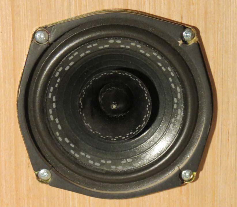

So I designed a TL Sl/So = 0.5, tunning to 50Hz. But I think the speaker is too close to the wood behind, there is any problem?
OK, a quick approximation in HR of your ML-TQWT [vented inverse tapered TL] yields a ~53 Hz Fp Vs the 1/4 WL calc'd. ~61 Hz and because it has so little net volume [Vb] it rolls off at ~2nd order [12 dB/octave] below 100 Hz, so not a bad design, just not 'fat' enough to go low.
Yes, ideally need at least 1.5x driver depth all the way around it and definitely at least cone depth.
Thanks, Gm. I don't have the Bl, so I guessed from a similar speaker set to 2,4. Is that a big problem?
Planet 10 the model Folded halfTower ML-TL v0.8 could be suitable for my speaker?
You're welcome!
Understood, MJK prefers to use Bl instead of Qes, which no way to guess other than looking at the magnet size AFAIK [FWIW I used 72 Hz Fs, 0.64 Qes, 5.06 Qms, 3.66 Bl], when all we really need is Qts' for calculating a box size plus damping 'fudge' factor [4-10x Vas depending on Qts'], so while his alignment is technically the most correct from a sealed or BR alignment POV, it doesn't account for the extra volume required to add damping and still get a ~flat response down to Fs and why I use to describe his TLs as having all the 'fat' trimmed off my much larger ones. 😉
