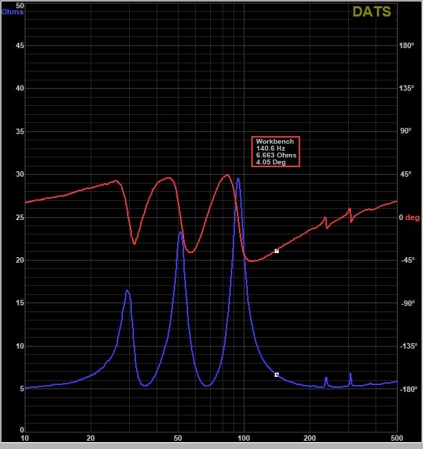

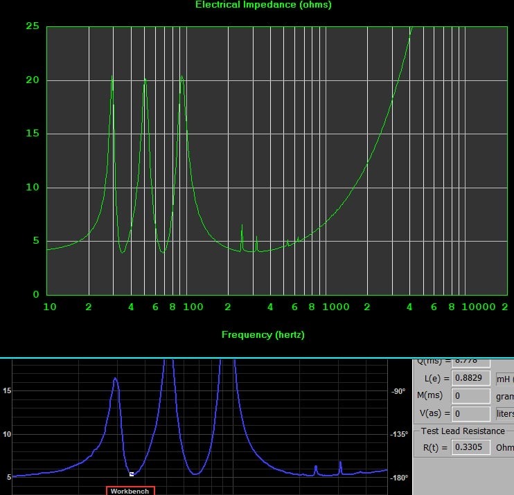

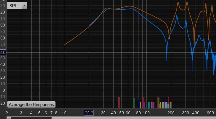

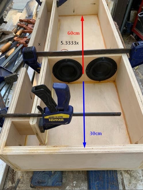

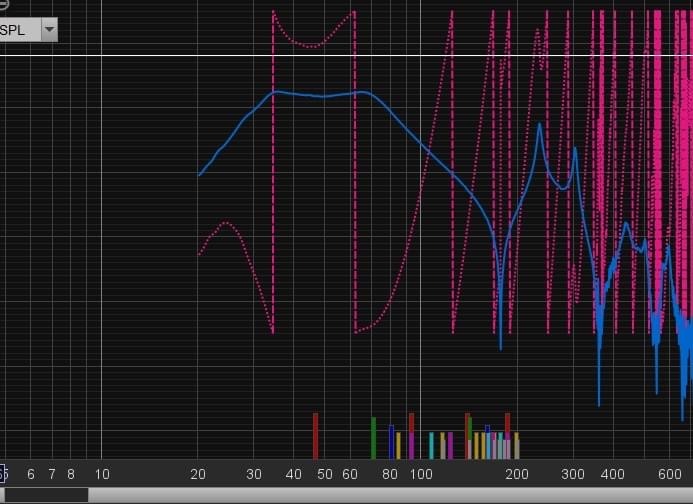

4” Dayton TCP15 in parallel BP
This is a breath of fresh air compared to the high order qw noise I’ve been messing with more recently. Nice low frequency without the extra ringing and funk up top .
traded all That for some port wind noises though….
good ole Mr McBean (horn resp)is always spot on when I ask him to simulate things 💚🙏🏻
