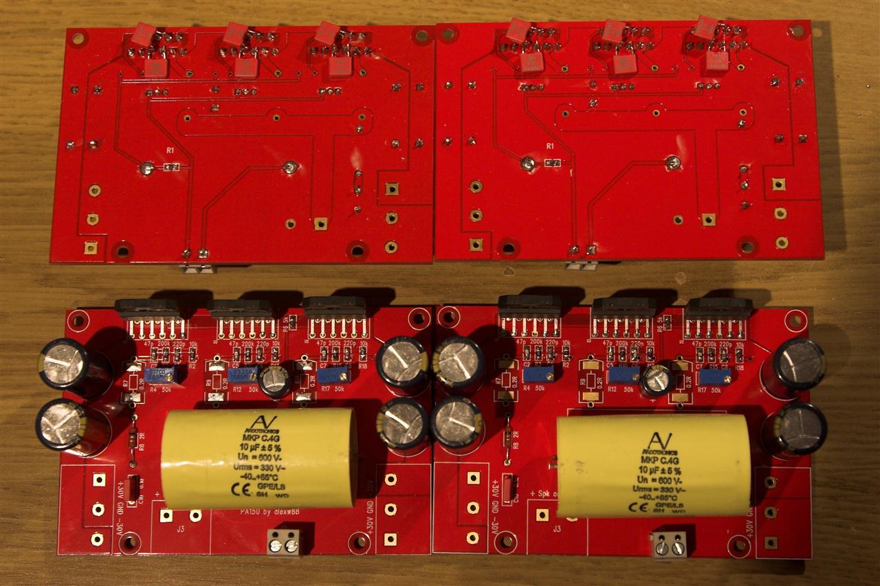

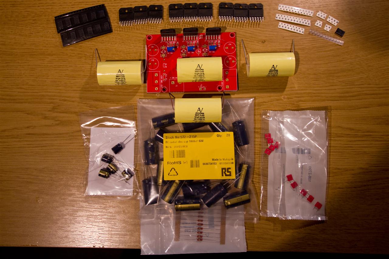

As promised a snapshot of the parts, not all, but the main bits. The strips to the top righthand side are the SMD components, which I am really looking foward to soldering! 🙄
Also fun to fit to the boards are the input caps, which are huge!! Guess that means I can do away with the cheap electrolytics that I currently use for DC blocking. 🙂
Lots of soldering

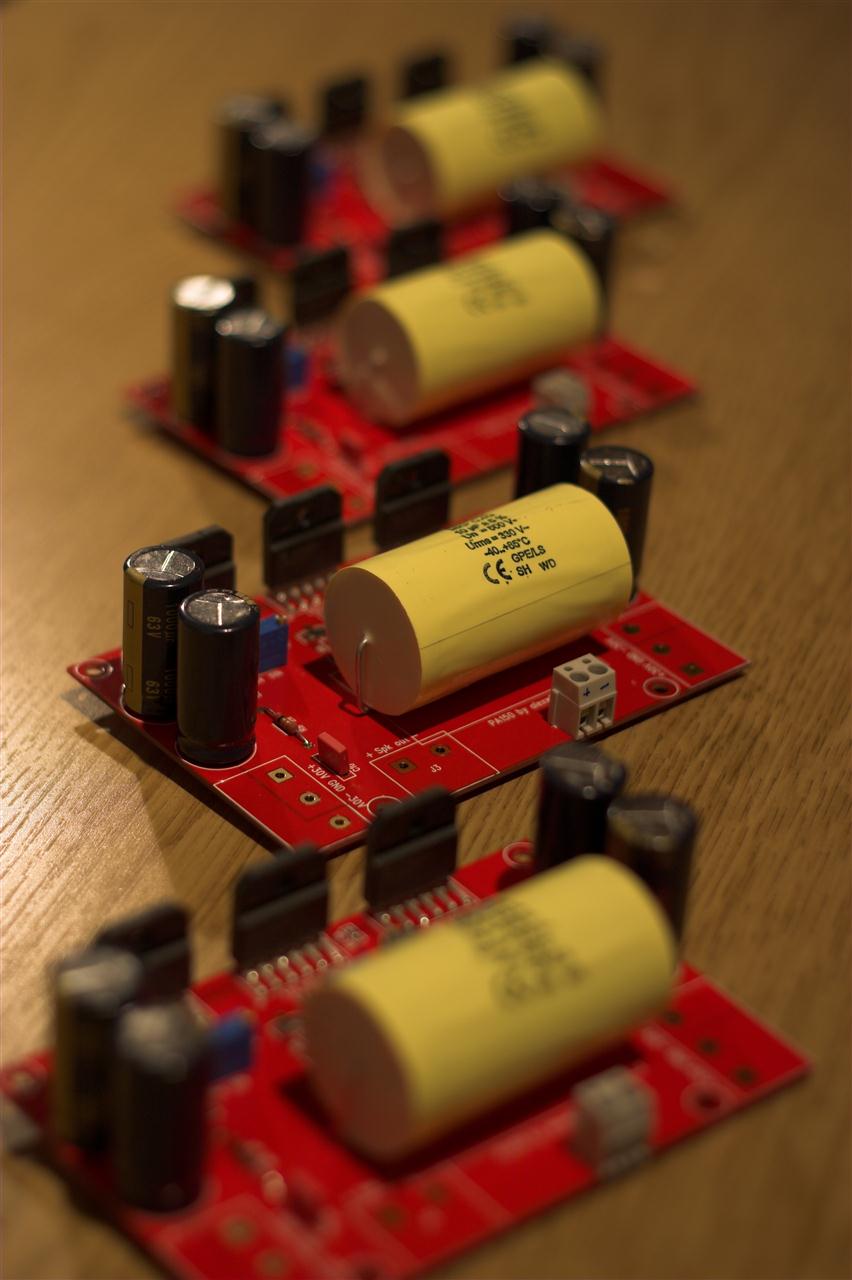

So I spent some time the other night and today oldering the components to the boards, which mostly went well, however there were a couple of challenges. The most frustrating was that a few of the square pads didn't want to take the solder which is clearly not good, however, I got there in the end.
The second was working with SMD components, which are easy to lose, as I found out after a resistor went shooting off out of the tweezers I was using never to be seen again. I'll be making a small RS order by the looks of it to get some replacements, good job 5 is the minimum order. What I should have perhaps done before I started the SMDs was looked to see if anyone had done a guide, as I struggled through 2 of the boards before figuring out my workflow. I'll share my findings:
This has the advantage that the components should sit flush with the board and you can position them neatly. I found it efficient to do a few components down one side, then turned the board around to solder the other side.
One ommisson you'll see on the boards at the moment are the output resistors, this is so I can set the offset of each chip before they are all linked together. At some point I need to set all my trim pots to a central position.

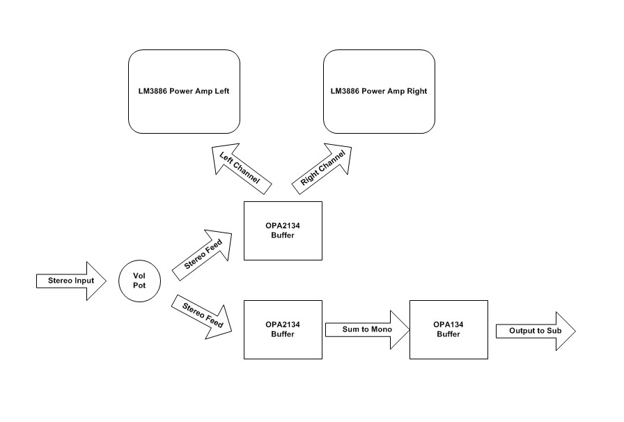

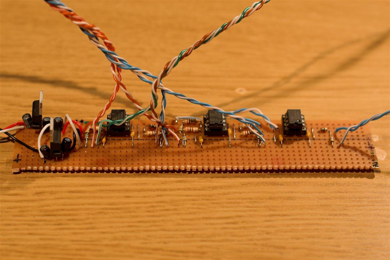

I have now completed (fingers crossed) the board that will drive the front end, which is based around an OPA2134 to drive the chipamp boards, then a combination of a OPA2134 and OPA134 to created the mono sum. I decided that I would use the 2134 to act as a buffer and prevent crosstalk between the channels, then combine them and drive the mono output using the 134. A block diagram attached illustrates the layout.
I have not tested this yet as I need to sort out the front end power supply. But basically this circuit will take a feed from the power supply for the chipamp boards and then regulate the voltage down to +/-15V to to power the op-amps. I've knocked up the regulator and op-amp circuits on some breadboard.

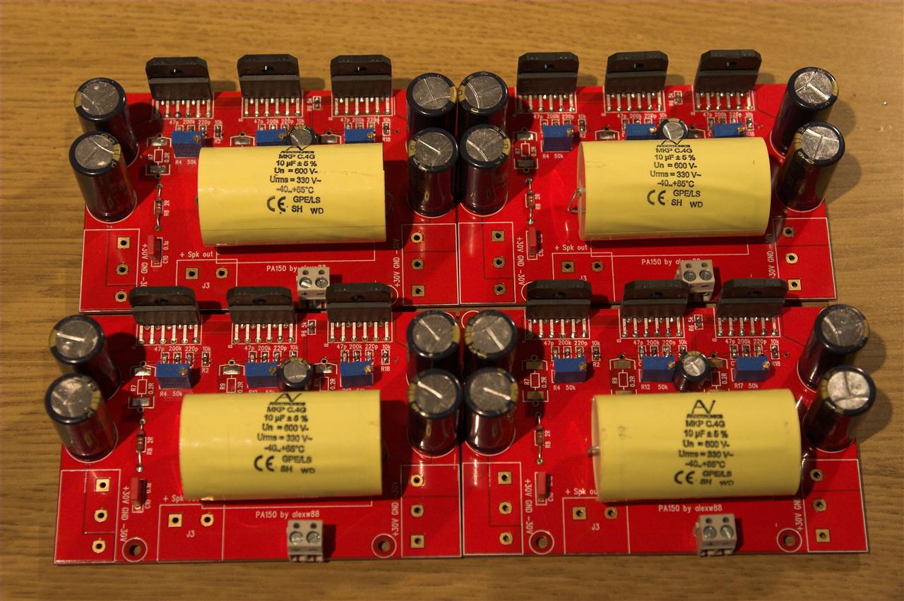

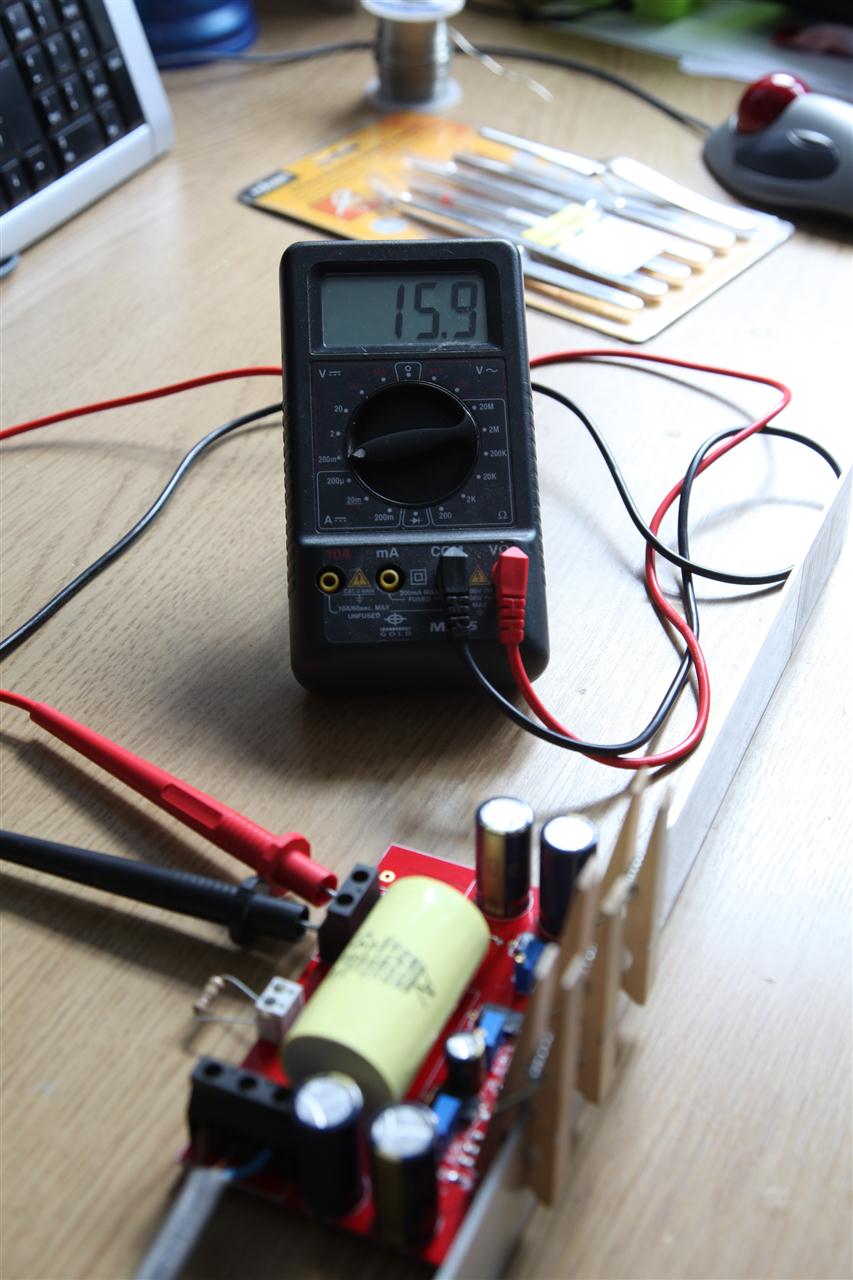

We have music

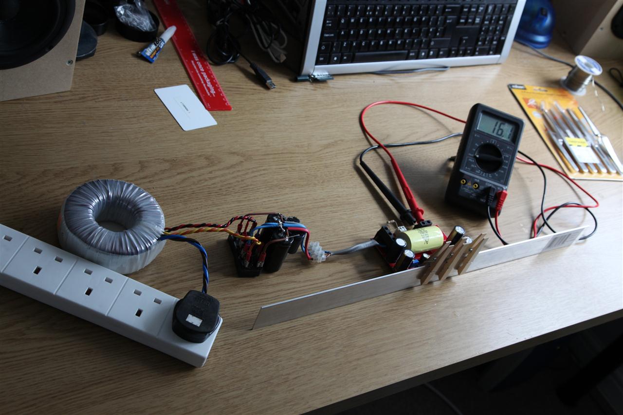

OK, so all four boards have no been tested and all set to 15mV DC offset, meaning I could install the Dale output resistors. So far so good and when I fired them up again, everything seemed to be working fine, a combined offset of about 16mV on all of the boards. At this point I was feeling pretty confident, so hooked up a little pair of speakers that came with a 4.1 surround system for my computer. We have a result! I then decided to up the ante and attached a pair of bookshelf speakers I am experimenting with.
The music flowed and it sounded great! I am really impressed with these boards so far. 😀
Since i don't have a case I had to use some strip aluminium to act as a temporary heatsink, which did an ok job, but the chips get pretty frickin warm. Am super excited about getting this thing built now.

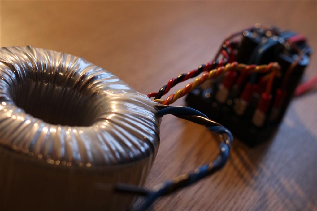

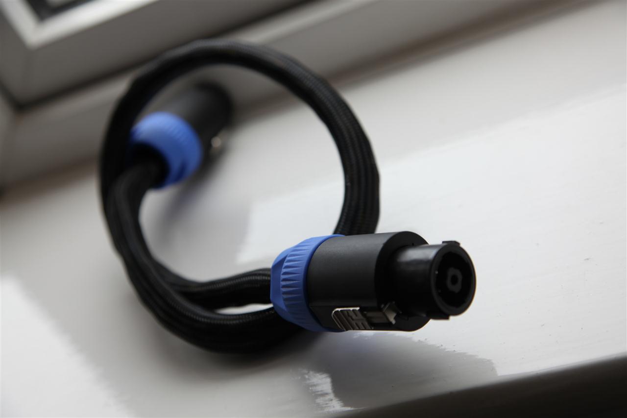

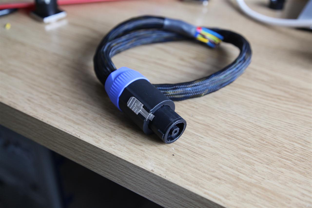

Since I am still short of a case I decided I'd progress some of the other items I need to be doing, such as creating the umblilical cord that will attach the power supply to the amps. This will need to carry power for the four amp boards and the pre-amp section. As previously discussed I bought the 8 way Speakon connectors for this purpose, which will allow me to use two independant supplies for the amp boards and a further supply for the pre-amp section.

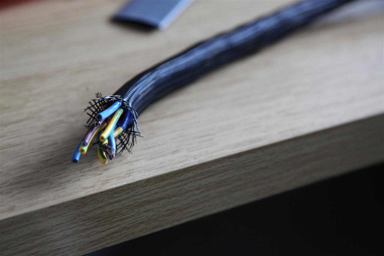

I have braided some 1.5mm2 copper mains wiring together then cut it to form three lenths, so 9 conductors in total. Two will be doubled up to form the 0V connection. The three bundles were twisted together, then covered in plastic cable sleeve and which were tidied up with some heatshrink. Wiring into the plugs was fairly straightforward and, it was only on the second one that I had managed to make six of the connections before I reallised I had forgotten to slide on the cable clamp! DOH
Thankfully they are screw terminals, otherwise I might have gotten angry.
Anyway, I think the result is rather tidy and having checked that all the connections match up with my meter it should hopefully work like a charm.

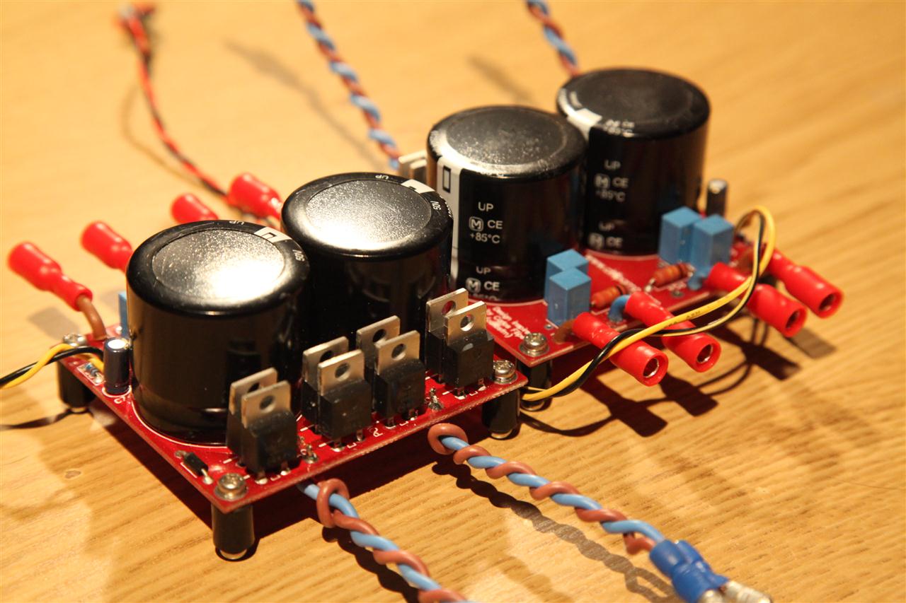

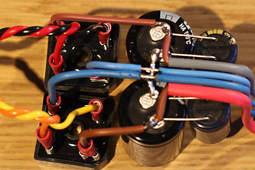

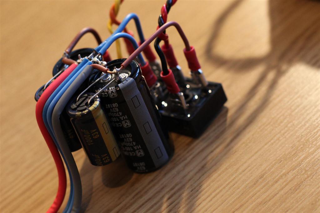

Regarding the power supply I built, that has now been transfered into the case with my existing 3886 setup, putting me one step closer to completing that side of the project for my friend. This means the transformers and rectifier boards have been liberated from the old amp and can be used to test the PA150 boards in anger.
However, the pre-amp section I made for my friend's amp seems to have an issue with the regulated power supply, so I need to do some more work on that.

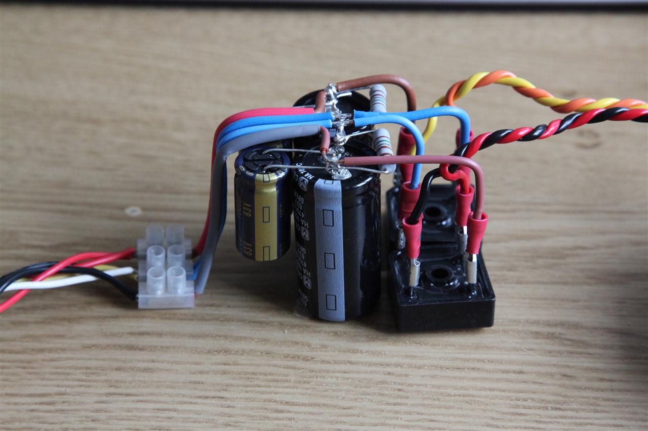

Power supply

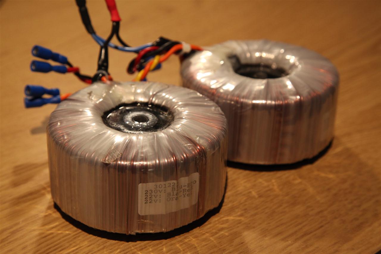

OK, so here are the two 300VA (2x22V) transformers that are going to power the four PA150 boards to begin with, along with the rectifiers and smoothing caps. These have been taken from the old amp. 😀

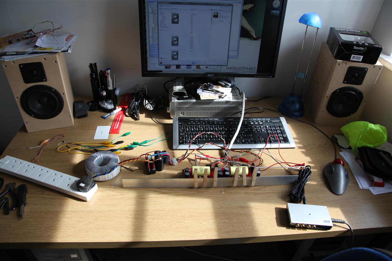

Bored whilst waiting for a case!

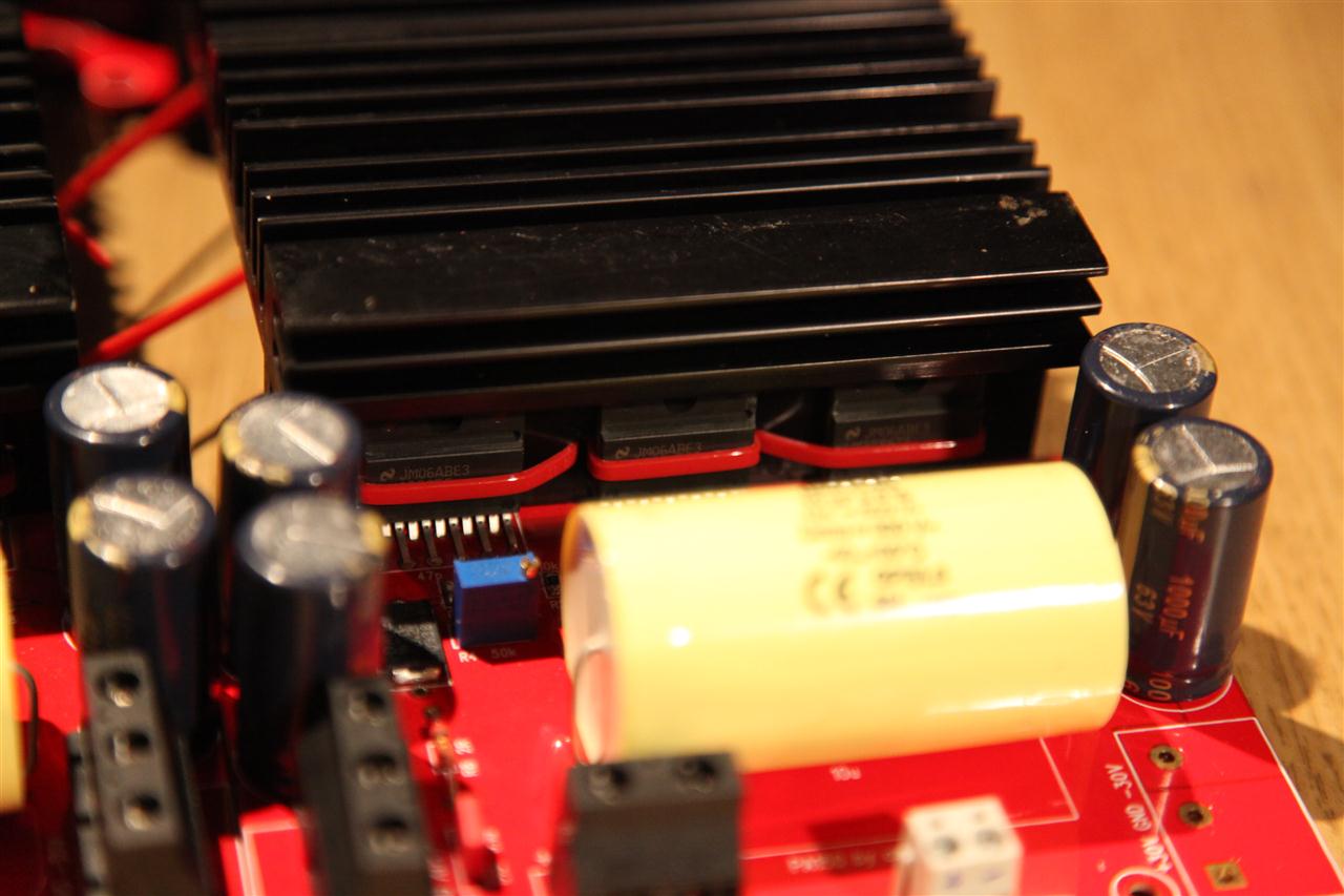

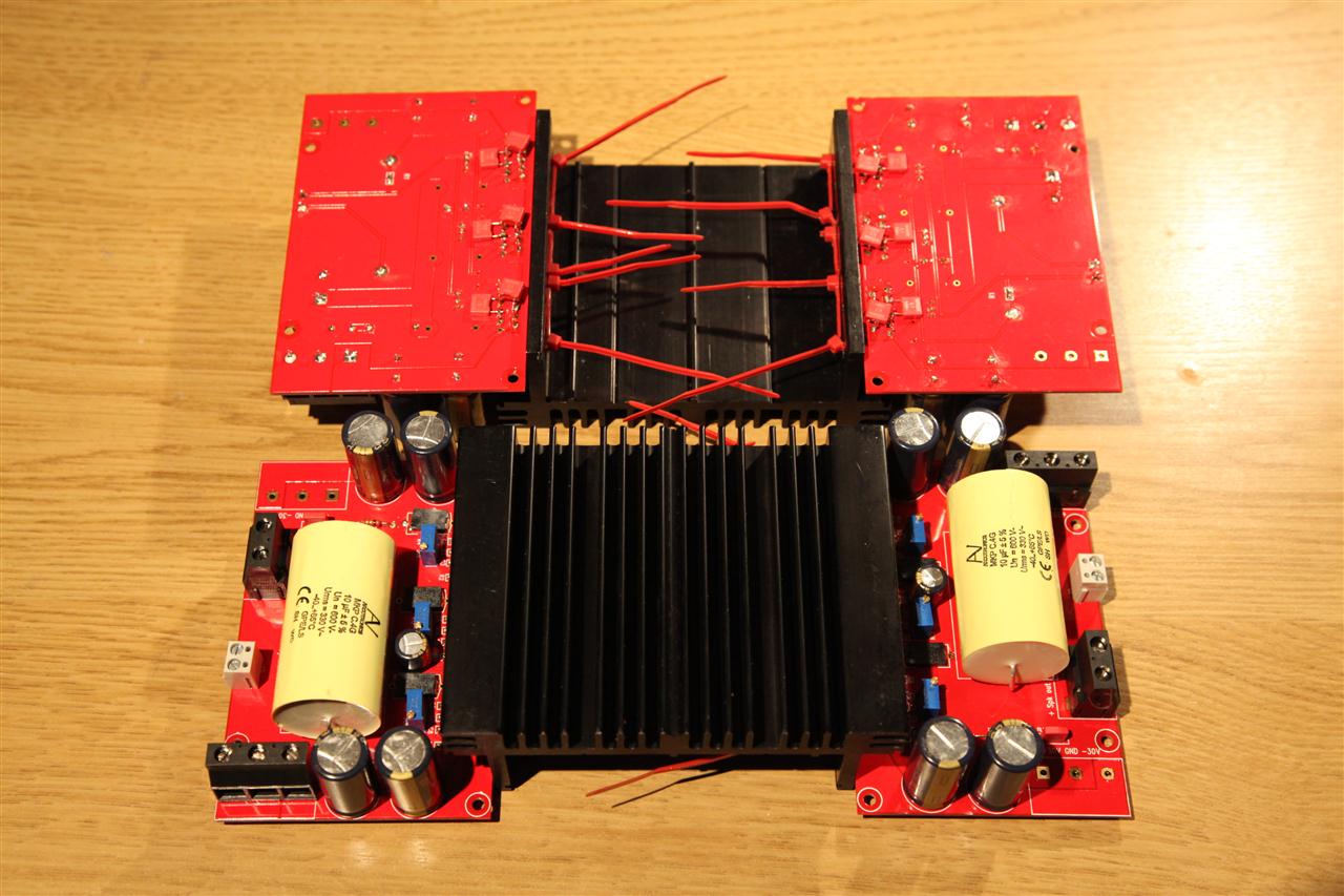

Also, whilst I am waiting for my case I was keen to test the amp boards some more, but needed a better form of heatsink than the aluminium strip I was using previously. I remebered that I had picked up a couple of heatsinks for a project from years back and they have been gathering dust in the loft. So these have been recovered and they are a nice fit for these boards. Hopefully they'll do the job and I can always fan cool with these if I need to.
You'll notice that I have taken a slightly unorthadox approach to attaching the chips to the heatsink and used cable ties. I am confident that these will do the trick for now and something slightly more sophisticated will be used in the final design. 😛

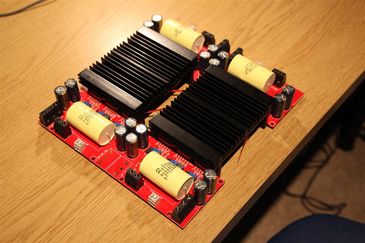

So I have mounted the boards as shown below on a sheet of chipboard and wired it up to my transformers and rectifier boards (as shown in post #17) and connected it to the preamp and speakers that are in my main system, the amps were wired to bi-amp my speakers.... and I got muffled music... oh balls! 😕
I went over all of the wiring a couple of times, then decided to try just one amp and one speaker, which was all good, so try again... ahh, the DOH moment! I managed on both of the tweeter connections to get the cable under the terminal block apature, thus no connection 😱
With that resolved, I got music... sweet beautiful music. Am just auditioning with India Arie, as I know the cd well and it is fabulous, crystal clear highs and nice tight, but extended bass. Suddenly all the effort and time is paying off!
Just to note, these amps seem to run quite hot even with no signal, at least compared with the single chip version (there are now 6 times more of them), so I have a fan mounted on top of the two heat sinks just to move a bit of air and stop them going thermonuclear on me 😀
