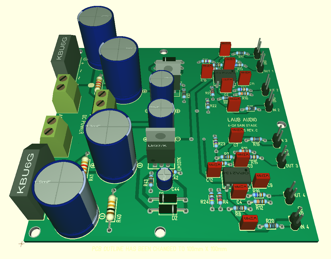

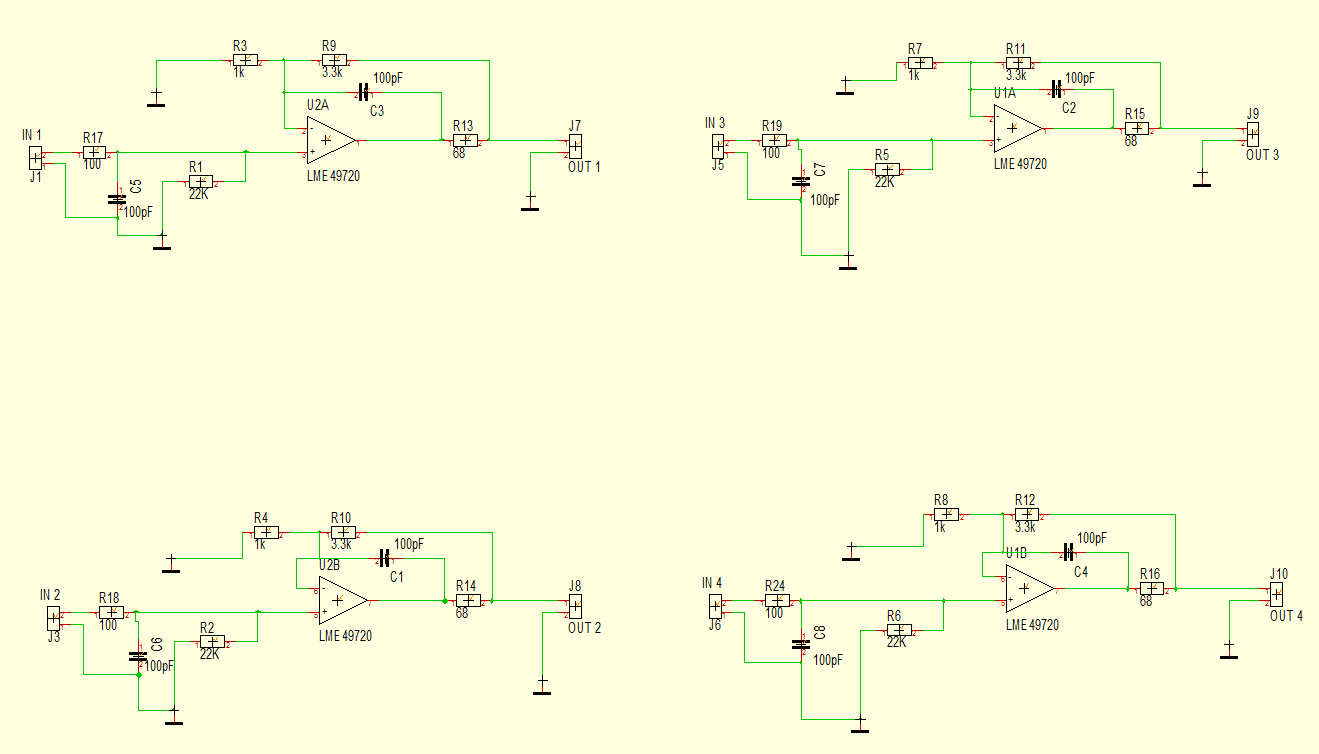

Charlie thanks for the boards. Is there a circuit schematic out there somewhere that shows the actual circuit on the boards? I see something in this post but not the complete circuit for the board.
See attached. Note C24 is connected backwards in the schematic (I labeled this in the pic) - I corrected this with a sharpie on the board I sent out.
Charlie quick question. Is this board setup to operate with AC power input or DC input? If DC then do I leave 317/337 off the board and associated components?
The board includes an onboard regulated power supply except for the transformers, which connect at the two terminal marked "AC". If you don't want to use the onboard PS, you can leave off all the PS parts except C22 and C32 and connect your power supply to the "DC Power" terminal. I envisioned it the other way around - that the board would export DC power via this terminal, but either way can work.

Good idea, I've attached the parts list.
What impedance could be expected at the output of the gain stage?
The miniDSP's 560 Ohm is on the high side, so if this could be improved at the same time as getting gain, it is a very interesting solution!

Hi Patrick,
The output of the gain stage can be set by the builder - I use 68R resistors in series with each output for instance. There is a HF feedback path before this resistor, and the gain setting feedback path is taken after.

Hi Patrick,

UPDATE: the gain stage board has been redesigned and improved. The gerber files have been posted in the thread linked to above, in this post:
http://www.diyaudio.com/forums/anal...el-gain-stage-power-supply-4.html#post4600044
Feel free to produce the pcb, build the board, and use this project in any personal/non-commercial applications.
3D rendering of the fully populated board:
