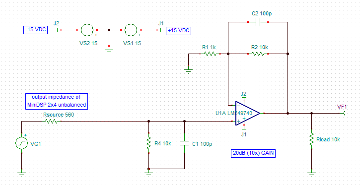

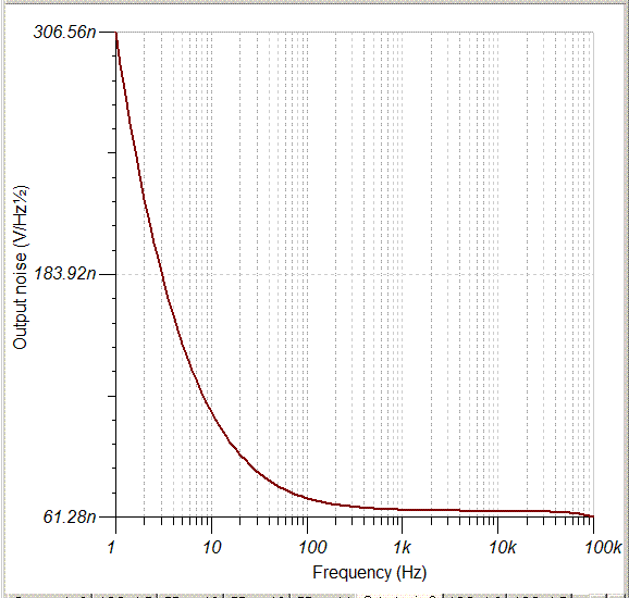

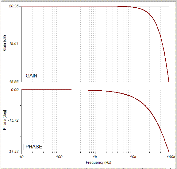

I did some modeling of the circuit today to plan the build using my "universal filter board". Attached is the circuit, FR+phase sim, and noise sim. Gain is set to about 20dB (10x).
I've used a LP filter on the input and in the feedback loop. The MiniDSP (2x4 unbalanced) has an output impedance of 560 ohms according to the spec sheet. This is probably the same for other models, but I am not sure. You can use this to form the LP filter without having to add a series resistance.
I hope to get this built today or tomorrow at the latest. Then I can test it and see if reality and modeling agree.
-Charlie

Charlie,
Have you considered bypassing the output stages of the MiniDSP boards and taking the output from the expansion port instead. You could build the filters into the buffers and it would allow the use of better quality parts.
For the 2x4 unbalanced the DAC outputs are on pins 1 - 8 and this is the application note passive output stage/filter for the ADAU1701 which is what is on the MiniDSP boards...
And this is the suggested active layout...

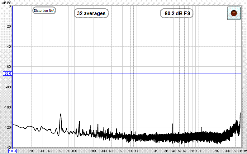

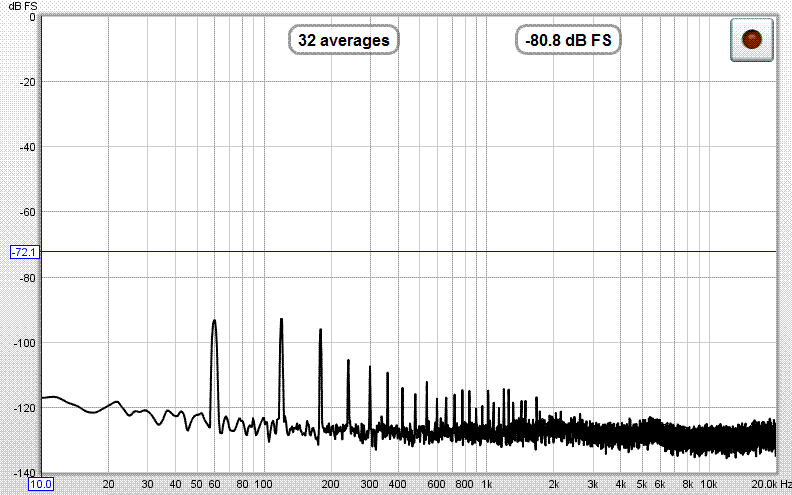

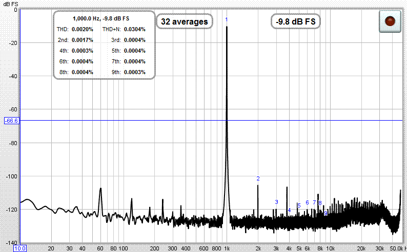

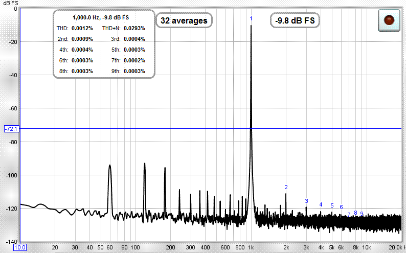

I built the circuit and ran a few tests at a few different frequencies using a dual rail PS that I happened to have out on the desk. This PS is pretty noisy (e.g. 60Hz mains and harmonics are dominant) and uses 7815 and 7915 devices, so I am sure one could do better in that regard. Computer and switching PS for other equipment is located nearby, and this probably inflates the THD+N level but should not influence the THD. I can try to put together another PS that uses 317 and 337 regulators with capacitors on the adjust pins and see if that looks better.
In short it looks like I am getting THD just above 0.001% at 1kHz. The THD level rises slightly to about 0.002% by 5-6kHz or to about 0.006% when the signal level is made to be very high. These numbers aren't bad at all, but probably could be improved if I reduce the feedback resistance.
For comparison, I have seen a THD measurement of the MiniDSP 2x4 itself at about 0.007%:
MiniDSP :: Topic: Re: MiniDSP sound quality test (1/4)
I have not confirmed these measurements, however, the ADAU1701 DSP processing chip used in the MiniDSP products lists -83dB (0.007%) as the THD spec when using the analog inputs, which is exactly in agreement with the measurements in the link above.

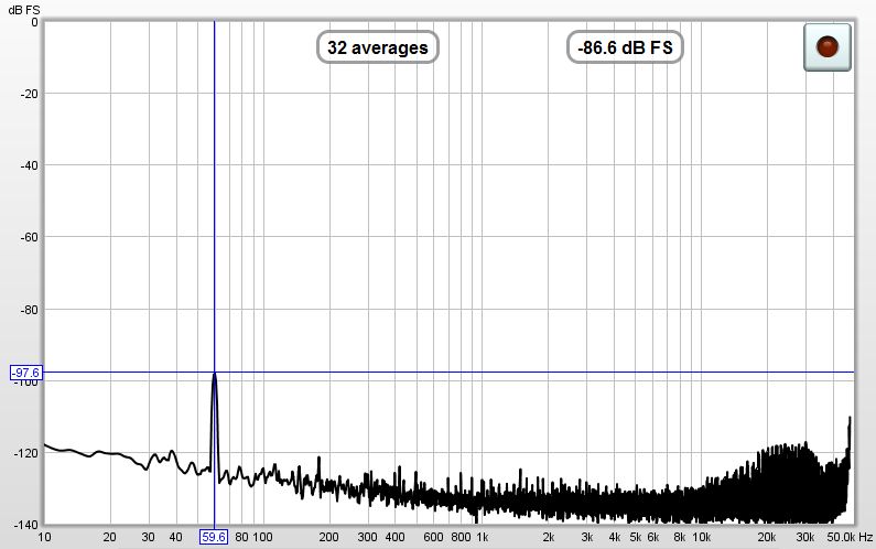

In short, as it stands now the THD from the circuit board is better than the MiniDSP but the noise floor needs to be checked with a better PS or perhaps inside a shielded box/enclosure.
Attached are screen shots taken using REW, one with the 1kHz input signal and the other with no input signal to show PS noise. Also a pic of the circuit board and PS connections out on desktop.
-Charlie

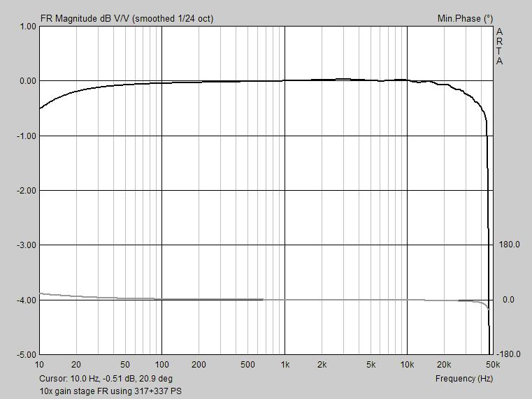

...and yet more tweaking. I inserted 10R resistors between the shield of the cables leading to and from my measurement system and the circuit board's ground. I've seen this recommended by several prominent authors for reducing shield currents, and it seems to have reduced the noise floor in this case by a couple of additional dB. I went back and checked, and these numbers are getting close to the noise and THD limits of my measurement system.
What remains is a peak at the mains frequency (60Hz) and I would guess that this can be reduced by shielding (e.g. putting the circuit board in a metal enclosure. Comments on this are welcome.
Also of note, the distortion no longer rises above 1kHz, remaining at or below 0.002%. I'd say that this is looking pretty good.
See attached.
