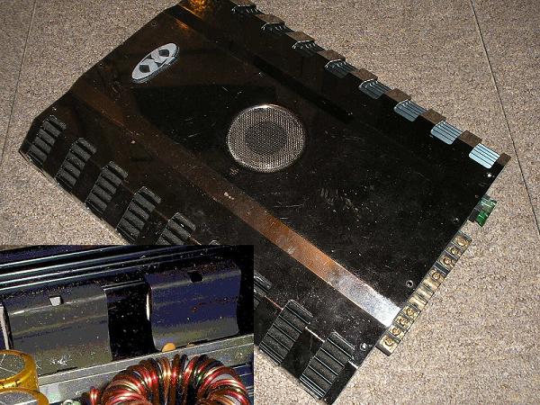

Hi all, just a quickie!:D
Would it be possible to take a 4 channel amp and convert it to a 1 channel amp? Don't get me wrong, I'm not looking for more power. I have a Maystar 4 channel jobby. I've had it for years and its never failed even though its had a bit of Pepsi spilt down the fan vent,OOPS:hot:it didn't die:angel: , and I'm running 2 of the channels in bridge mode for my sub. I can't afford to go and buy a new amp, but, am I not wasting unused amperes in the switch mode, because the other 2 channels aren't being used, plus maybe it would sound better if I just had a pair of transistors driving my woofer?
Or maybe a parallel pair?

Originally posted by iUSERTLO72p djQUAN has a psu, in which he says he drew a line across the board and cut it, (obviously in the right place). I've looked at the board and at first glance, there's more than just +/- and Gnd tracks, djQUAN if you read this, how the heck did you decide what/where to cut?:confused: [/B]
there are actually two V+, two V- and one gnd tracks because it is a dual supply amp. both V+ and V-'s have the same output voltages but are independent of each other because they have separate power transformers, rectifiers and output caps.
just look around the circuit and trace the copper running from the output to the rectifiers, inductors and output capacitors and see where you can cut a nearly straight line. just make sure if the powersupply has some feedback path for regulation, don't cut that part. ;)
cutting was done using a dremel type tool and a cutting disc attachment.
you can use only two channels on a 4 channel amp and if it has a single supply (most likely it does but I'm not sure) then using only two channels rather than four is not wasting any power but even better for the PSU since it has extra juice from the unused channels that can be used by the other two.

Even if you run all four channels into one mono channel, you're not going to gain any more power output (assuming you keep the same woofer). The current capability of the amp could theretically go up, but since the amp will still be running the same voltage in the power supply, and the woofer impedance is staying the same (because you can't buy a new one, and I'm assuming its a single 4 ohm version since you haven't stated to the contrary) you will be using pretty much the same wattage. The damping will change slightly but the amp's voltage maximum will be the same. That is why I suggested changing the woofer type to require more current from the amp.

Hello, I just wanted to improve the amp. I assume that using 1x 4 ohm driver, sorry should have said:D , that I could build a better quality amp. I don't know how the power rating would change. I just wondered if the powersupply could just run one set of transistors/or parallel another pair, to give the same power as 2 channels bridged. I was thinking that the crossover distortion created by the bridge be removed and maybe THD/Damping or whatever goes into making an amp stage perform well.

I don't think you could squeeze more than about 200 watts off that power supply.
the transformer has a 6T:12T primary to secondary turns so that means about 25V secondary supply voltage.
you're probably getting about 50watts cont x 4 at 4ohms or about 200watts cont x 2 at 4ohms bridged.
I don't think you could change the power output much since it is already maxed out. as for sound quality, you might as well build a new amp from scratch since you would replace many parts or redesign the amplifier section.
I'm not trying to discourage you, just letting you know what you're going to get into. :)

I can't even slide the bl**dy board out! Those clamps and the heatsink compound must have it locked tight.
I have heard a JBL GTO at the same power sound warm in the bass, where as this sounded thin and dry. Thats why I was curious about being able to do this. I'm assuming the JBL to be a better amp, it was a GTO somthing or other.
