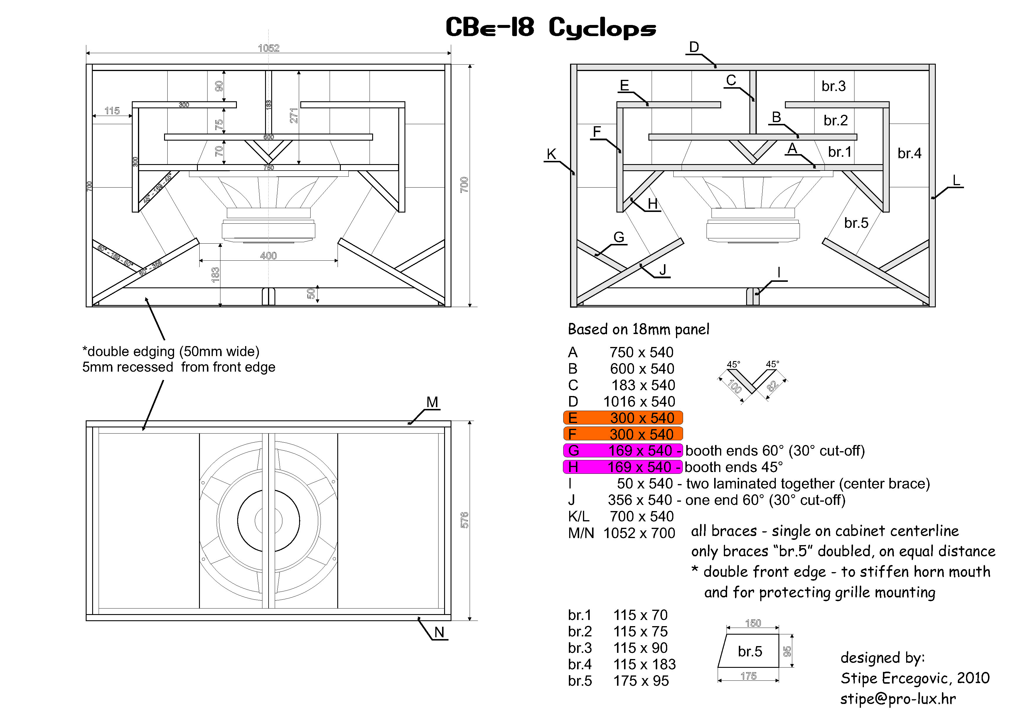

I've heard of the xoc. I've never heard an xoc. I looked into building the xoc when it was in the early stages of discussion on here. only reason i went with the cbe, numbers looked good also, was that i like things symmetrical. just personal preference. i don't regret. they are not as heavy has others would have you believe on here. mine have wheel boards that attach to the front. easy flip over and push out.
