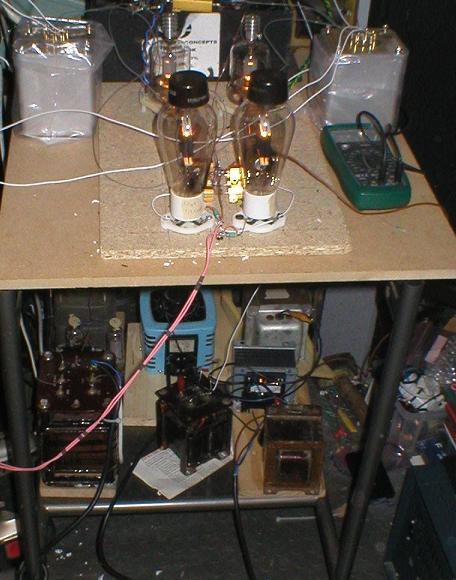

I am using the 4-65A at present and have traced the triode curves on the tester up to 400V . 845 curves are close enough , Ra is around the 1.6k mark , mu of 5 . Currently running mine with James 6123HS at 530V/50mA , really these need to be run at around 650V / 55mA to get some decent power . Here's a pic of the Mk1 breadboard with T20 driver , it's totally different now and has LCL DC filament supplies , I would recommend implementing DC fils with all the big Eimacs with spiral filaments such as 100TH , VT127 and 4-65A . Also don't forget the heat dissipating caps !!!!!!

I don't know about using the 4-125A as a tetrode but as a triode it's probably no good unless run zero bias . It will have Ra over the 2.5k mark and would require running the G2 way over it's 600V limit . Also think about the filament rquirements . I had problems getting the 4-65A quiet with AC . Tried different variations of hum pots , CT filament transformers etc and gave up and went to LCL DC filaments . The 2 x 8mH@10A input chokes , filament transformer and 2 x 30mH@5A isolation chokes added 18kg to the amp's weight .

A CCS load set to 10mA was used for the T20 . Currently running 3C24 with the same loads with the output taken from the 'mu' output of the CCS . A Valab 1200H plate choke was also tried . The seller claimed -1dB @60kHz driven by a 6SN7 . I measured -1dB @ 13kHz with a 6SN7 section and much worse with the T20 so out they came ! Better off with a lower Ra driver . I'm thinking of ditching the linestage and going for a 2 stage 'integrated' : CCS'd 3C24 input stage with plate choked 316A driver DC coupled to the 4-65A .
ps If you are really considering using this valve , look up the James 6123HS output transformer . More or less a perfect match for the 4-65A and a bargian at $180 per pair 😉
