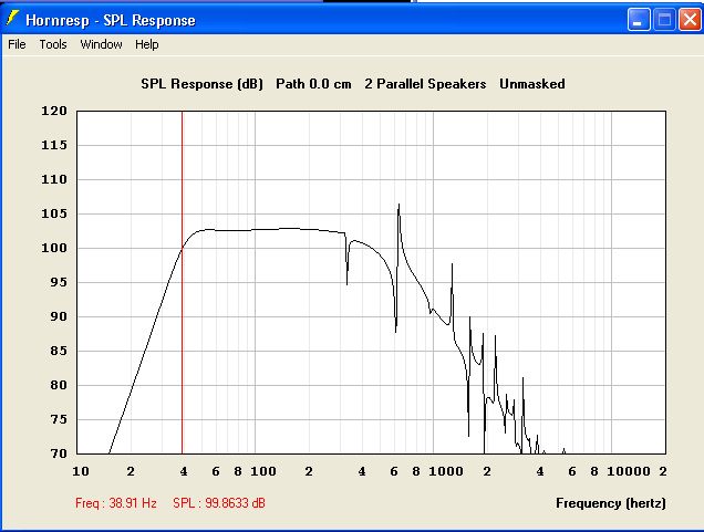

Thanks for the reply 🙂
Well I did some playing around, and with some Delta 15 lf 500w drivers (2 in each cab) it reckons I can get a solid 70-80Hz. Which tbh, from 15" in a small cab, isnt bad I don't think. Lets hope the maths doesn't lie.
For me 70-80Hz as my first system, ill be pleased with 🙂

given the size of the cabinet is approx 118 Liters per driver you could probably tune for a lower response than 70hz. Driver recommendations are usually dependent on your location. I suggest you add your location to your profile as this is a global forum!
Practical port size depends on what you can fit in the cabinet. Personally I would probably try for at least 6 X 10cm diameter ports for a double 15" to keep the port velocity down.
A pair of Eminence Kappa Pro15LF2 should be capable of a -3db response at 40Hz in this sized cab.

I hadn't looked so closely at the cabinet volume - looks like there's plenty there (I've seen other 2x15" cabs where the drivers barely fit in the cabinet, and assumed similar).
The driver that Xoc1 has suggested will do about 125dB per cabinet, down to ~40Hz.
You could run a 1kW amp into it fairly safely: excursion goes to ~8mm one-way around 60Hz (that's probably the most I'd ask from them). The progressive suspension used in most PA drivers ought to stop them bottoming out, but listen carefully to check if the drivers are being abused.
For high power use, adding a low-cut filter below port tuning is mandatory. The cabinet provides no resistance to the cone motion below Fb, so the drivers will quickly bottom out.

Undersized cabinets give higher cutoffs. WinISD will show you (to some extent) what you can get away with.
Block the existing ports, add your own at the back - you'll have far more control over the system performance.
The biggest problem with small ports is that they work fine at lower volumes, but when the cones start moving, they can't move the air fast enough (too much friction) so kind-of "lock up": you won't get much more output from them.
Alternatively, go sealed.
