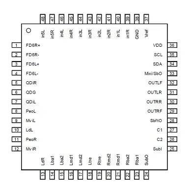

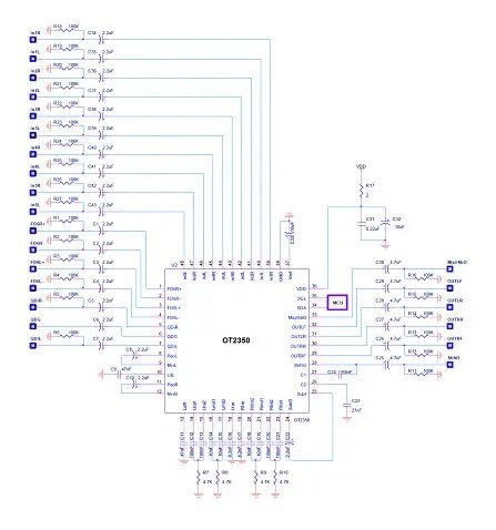

4.1 channel audio processor OT2350 DC output and datasheets
