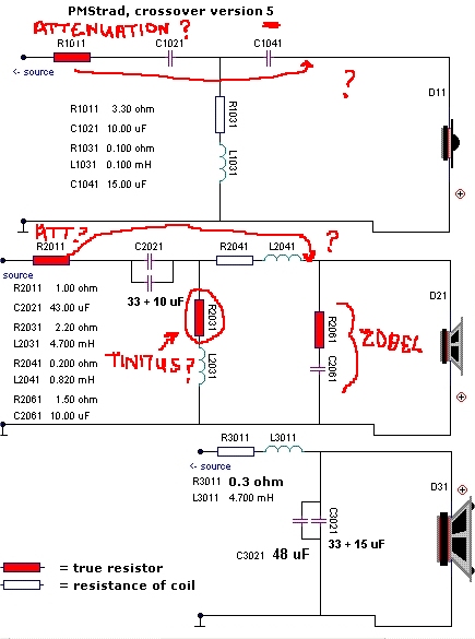

Sreten, Hi,
Cautiously, I may be finally 'there'! (I hope), that is, I think you may have answered my question.
Quote: "So using Troels data for his baffle and BS responses for his baffle and your box you subtract TGs baffle and add your box response".
So, I very much hope that I have understood you correctly and presume the following approach is valid:
SPLTrace all 3 responses, ( ie, *1* = Troels PMS (pseudo) Infinite Baffle MCA response, *2* = Troels MCA BStep
response in PMS box, and *3* = the MCA simmed in my box in 'the Edge'.)
Then, numerically SUBTRACT *2* from *1* (by dB's per frequency) giving *4* and then ADD *3* to *4*.
I hope this process is what you intended. I'm being overly specific here because I need to get this right conceptually and also I don't want to cause any unnecessary confusion.
If this is correct, then, I'm now on my way! The only problem is that Troels has not specified the MCA BStep PMS box graph. I guess I could approximate a curved baffle of PMS dimensions in Svante's (flat baffled) 'Edge'?
Btw, I think I understand this now Q: " or subtracted from the box response (now at ~ 100Hz - -6dB = +6dB) to get the infinite baffle response." It took a while for me !, but hey, Thanks! grant

Hi Omni,
Are you about? Where are you 'at' now , please, building-wise? I hope its all going well for you. I've hit some more 'snags' along the way. It seems that I have to buy Office 2000 to get XL to proceed.
And then, like you did, go through all the steep learning-curve process!
I tried several more times to model your FRC CA15 frd's in SW, but had insufficient data, and I could not get the 'calculate' ( +, -, and times/divide) options to work. No joy as yet on the SW new forum either. So, regarding baffle-step, ie, how to compensate for the MCA15 in my box, like you said, I'm baffled!
Anyway, I still truly want to pursue this. I'm an obstinate old f_rt! lol I believe it can be done...but how?, without proper measurements, is the question? The FRConsortium tools are my best alternative, imho.
I'm now seriously considering Troels 3WayClassic, the baffle dimensions are similar except for 200?mm difference in height. I modelled both the MCA12 and 15 in both boxes in Svante's 'the Edge' (similar driver placement on both baffles) and there was not much difference that I could see. The P25 Vifa woofer I think will
be fine, because as Sreten said the test-box and my box are very similar. Also, he said?, (because the MCA12 and 15 responses are so similar....I hope I'm correct) the MCA15 might give a reasonably 'approximate' result. Which is what I'm looking for 'after all'.
Btw, just for fun, Tony Gee's Modulus design looks very interesting still. Sreten, I think said it was esoteric? But nevertheless, excluding the 'smallish'? open MT baffle, and series XO, maybe looks modifiable for my proposed drivers? Just a thought. I know all of this is irrelevant to you Omni!, sorry I'm just *thinking* aloud.
best wishes to you (and everyone else!), grant

Hi Sreten,
Thanks for your further Modulus info, yes, I'll discard the idea of trying to modify it with the Seas drivers. So, I'll continue with the 27TFFC and MCA15's in my box, and still try to find ways to model things
adequately without most of the FRC tools or measurements. Re: my previous overly simplified post about adding and subtracting BS; I have not as yet been able to get the SW Calculate function to work. thanks, grant

Hi Tinitus,
I've been intrigued since you mentioned your notion of resistors in series with parallel components in parallel xo networks and the benefits to be gained.. At one stage I did model an 'Omni XO variant' for his scenario and found a 'positive', that is, *good variance* with series resistors on parallel components (dB wise, albeit small, but still possibly discernible), so I was surprised and I must also say, delighted to find the resistor in Troels 'PMS' version 5 XO. Am I correct here, please?
Please see Troels G. circuit attached. Does this indicate what you are suggesting? And , if so, would the resistor's value need to be subtracted from the coil's DCR? Also, I thought attenuation resistors should be placed next to, but preceding Zobels?...from the Amp? If you know what I mean...i.e. just before the Zobel across the driver. Would an L-Pad be better here to maintain a more constant impedance, do you think?
Also, Vivaldi... the Four Seasons - is great! thanks, Tinitus.....best wishes, grant
grant
Hi, the very short answer is no, and yes you could use a 2.2R air core, 🙂/sreten.
No, I must admit, its not the same thing
First...att. resistor....I have never understood why people place the tweeter series resistor before filter....it is presented to a whole lot more power
I can see its convenient, because it dont affect filter function in the same way if you change its value
But fact is that to have the desired attenuation a series resistor needs to be much bigger than that of a L-pad .... and smaller does have a tendency to sound better
And with L-pads you can make VERY small adjustments to the filter function, by adjusting the L-pad
As to the series resistor on paralel components
The one troels place on the coil is insignificant and merely to adjust dc-resistance
Now, the one he places on the paralel C is a bit bigger and may have some effect to filter function, but I guess it mostly affects Q-values in this way
At the moment I have 12ohm on midrange paralel C
It surely does a number of things but mostly corrects impedance load ..... what ever adjustments I do, doesnt change the sound much ..... but it clearly has an important influence on phase ..... I think the key word is ambience and precision in soundstage
Ah, I forgot.....at the moment I am playing with "notch" filters
Too bad I cant document anything
tinitus said:No, I must admit, its not the same thing
more power I can see its convenient, because it dont affect filter
Ahh..... but it does.
It affects the source impedance driving the network which is no
longer effectively a short (amplifier output impedance) but the
value of the series resistor you use.
So it changes the Q of the filter, and makes amplifier output
impedance pretty much irrelevant, transistor or valve.
It is true the resistor sees more power, the inductor current.
🙂/sreten.
