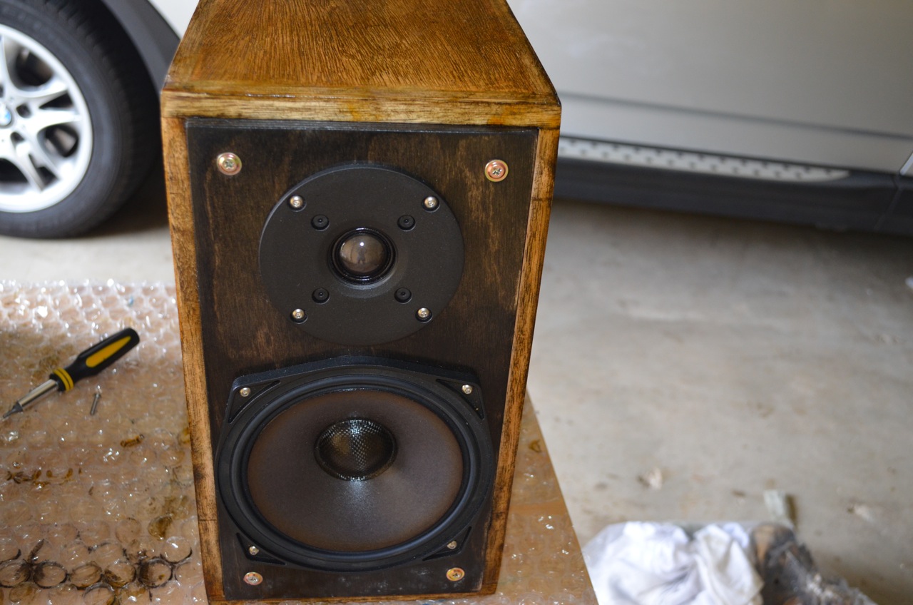

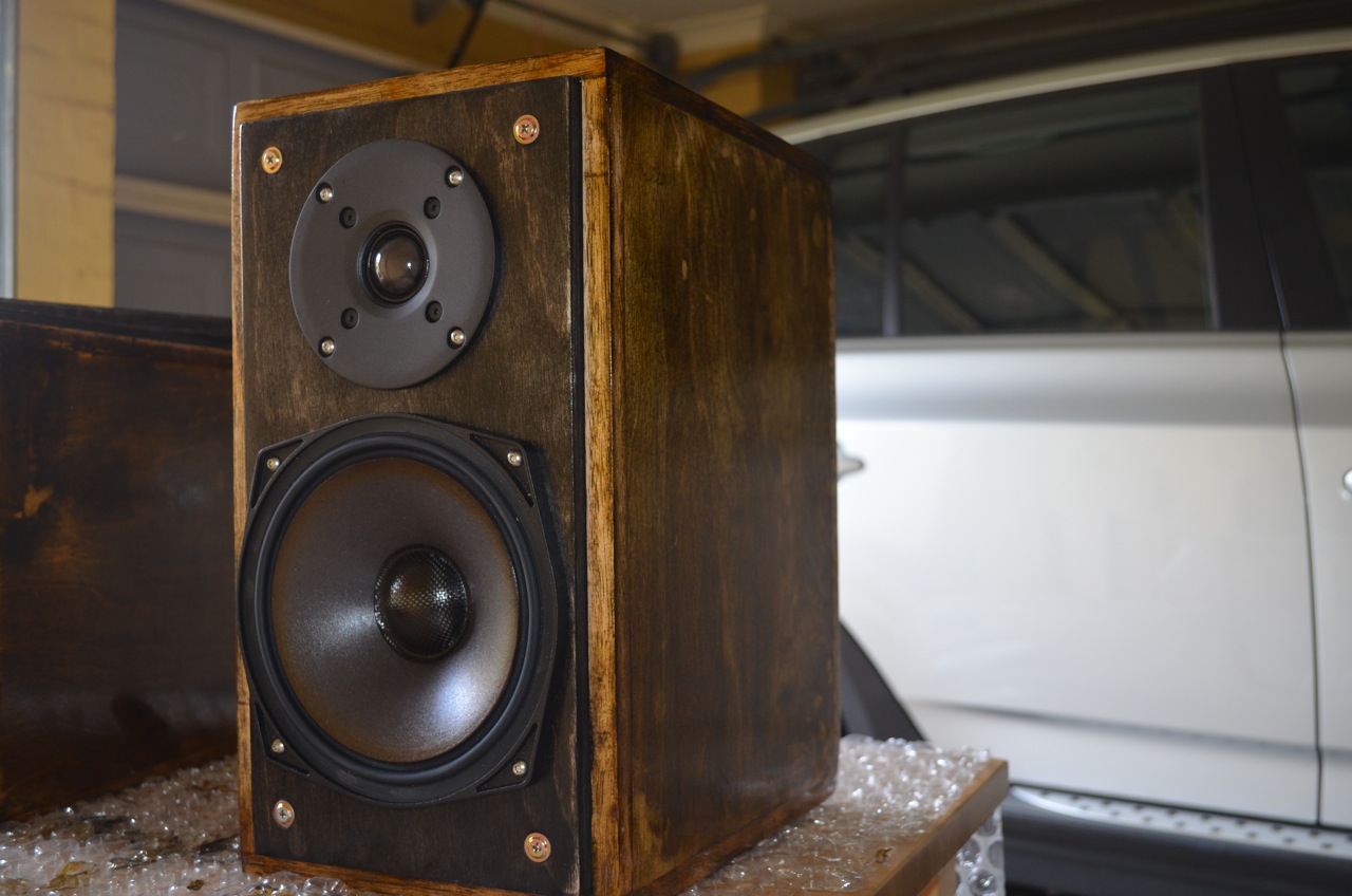

This is a version of MT on top of my bass bin with Eminence 3012LF in 85L box.
PHL 1220 in 10L sealed box, birch ply, bitumen layered and heavy stuffing, although i wanted to flush mount the tweeter, i messed up 2 previous baffles, so ran out of patience and just put this on 😀
I want to try antique finish, this one consists of minwax stain, french polish and minwax polycrylic, looks ok but i think i should done better 😛

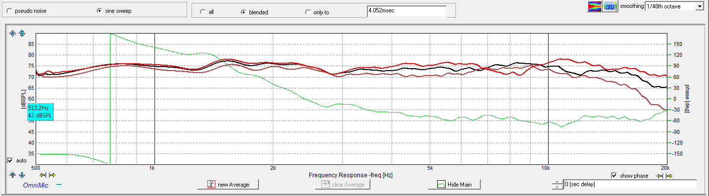

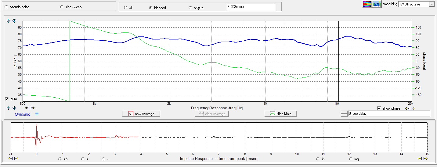

some measurements.
Mic at 110cm, Tw axis, 4msec gating with OmniMic V2
The dip 2900 and 8000hz are because of not flush mounting the tweeter, although this even out on 10-15deg off axis.
