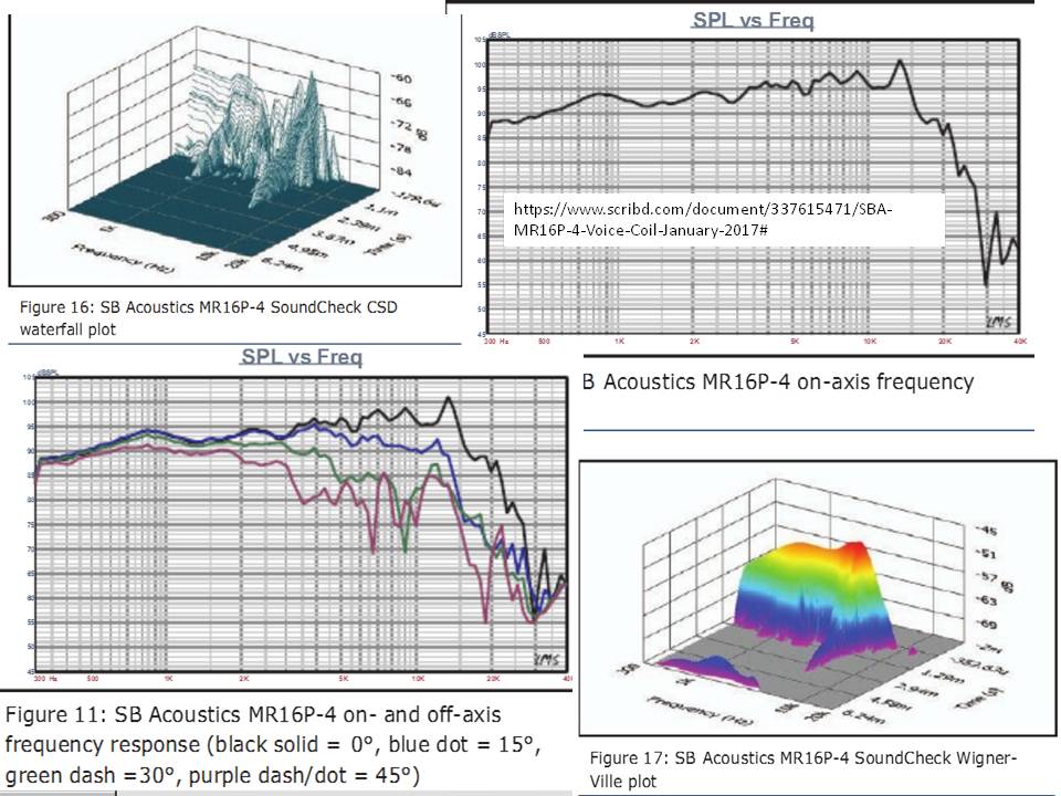

Satori MR16P on axis and about 45 degrees. I think 2.7 Khz is good point for xover with tweeter.
But my urgent problem is cabinet. I did some SB23NRX TS measurements and my data is close to manufacturer's. And what i have to do? 🙂 Whom i have to believe to? Optimal volume of vented box differs significantly. 40-43L by Troels or 65-74L by factory datasheet. 😕

The SB23NRX45-8 I used matched the SB_specs, and worked well in a QB3 ported 2.5cuft(70l-75l) volume tuned to 28Hz with flanged 3" port 7.5" long. Combining a room sim before you cut wood couldn't hurt.

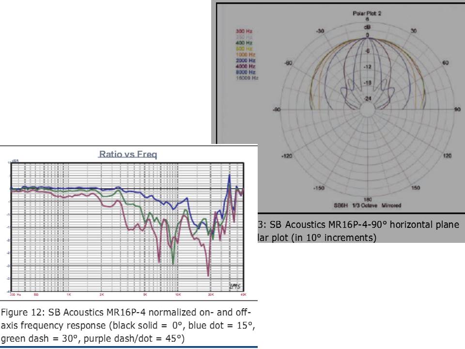

The Voice Coil Jan 2017 measurements on the MR16P-4 suggest that a crossover under 2kHz is desirable to maintain a 2-Pi polar pattern match with a dome tweeter. Voice Coil also has measurements on your tweeter.

2.7Khz can be doable but if you load the tweeter on a waveguide, and if its the SB26st series, its very concave so not a good cnadidate for such use. Otherwise, follow the advise above and crossover lower, these tweeters can handle lower crossover point with no issues.
