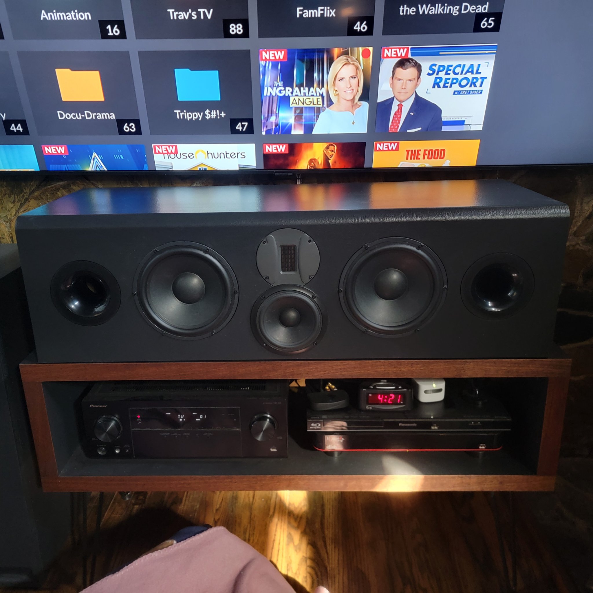

Im building a center channel and have some measurments questions. The drivers im using are:
Tweeter: HiVi RT1.3WE
Mid: 5" SB 13PFCR25-8
Woofers: (2x) 8" Silverflute W20RC38-04
Target crossover points are:
300mhz/3000mhz. (80Htz crossover to sub)
Tools im using:
Dats V3
UMM6 usb mike
REW
Xsim
Question:
When making the FRD and ZMA files for the two woofers do i measure them indiviualy or wired in parallel like they will be used?
If measured together are they still represented in xSim with one driver?
-Travis

I don't know the details of the software.
What I would do is wire them in series for 8 ohms, and measure them that way. Then estimate a 2nd order filter for them at 300hz. Lower would be better, but with everything, there are compromises. Low x-over points will make the response increase in the bass range. Can you fix that with EQ from the AVR?
Will these be placed close to the screen, or other reflective surfaces?
Question:
You could do combined output acoustic and combined impedance, and put it in xsim as one driver.
You could do separate acoustic and impedance measurements and put it in xsim as 2 drivers.
A combined representation would fail to capture some of the spatial aspects, but xsim is aimed at on-axis only, so not really a deal breaker IMO. VituixCad is aimed at also simming off-axis, so in that package it would be better to do the separate representation.
Since it's two woofers a fair distance apart, this brings up some questions of near-field vs far-field measurements. I think you'd want to take your acoustic measurement from a ways back in order to capture things correctly. Since your intended low-pass is lowish for the woofers, prob no issue. You might look into this if you haven't considered it already.
You mention having a USB mic, are you aware of how to capture phase / time of flight? USB has non-fixed latency, so some care is required.
EDIT: Now that I look at your pictures, it appears that your woofers are sharing a volume? In that case, I think you probably can't measure them individually, as failing to drive one speaker would impact both acoustic and impedance measurements.

I will measure them together then, is 1 meter enough?
You want to get into the far field for these drivers. Normally it would be the diameter of 1 driver, but you're running 2 so it's the distance from one to the other... You can research near-field and far-field on line. But probably you want to catch baffle effects like the baffle step and possibly diffraction, so you should go for far field relative to the longest dimension of the baffle. I've heard different multipliers for this length, 3x, 5x, 10x. This can become troublesome for large cabinets. I usually go 3-5x.
You'll see +6dB over the individual woofer responses on the tweeter axis, regardless of the separation. (Moving back for the baffle still applies, of course.)
