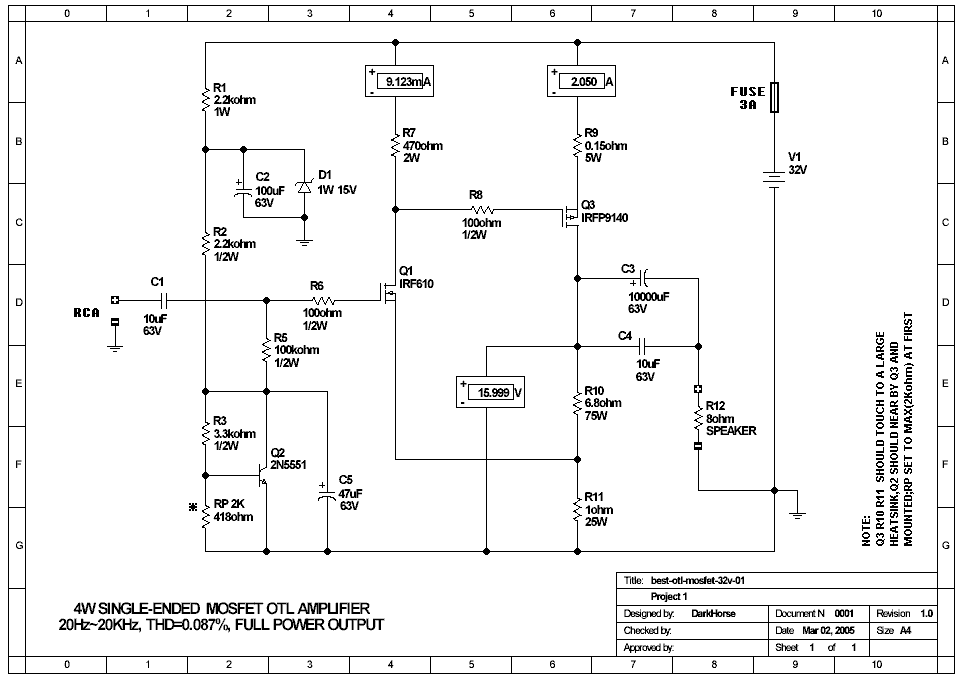

3W Pure Class-A AMP
Upupa Epops said:
This distortion is too high, later you will be not satisfied with him 😉 , belive to " old tomcat " 😎 .
ahaha..OK,I trust you that the 14W class-A amp's distortion is too high(full output state)!I will consider let this project push rear!
at present,I will do 4W class-A amp first..
as a young man,I need more experience in DIY practice!

Upupa Epops said:
4 W are for ...., it is only to the bedroom, not for serious listening 😎 .
:smash:
yes,4W(RMS) seems too low today,I want to build this low power
amp just for proof my idea.

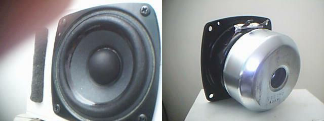

and I have several 3inch full frequency loudspeaker(SONY joint-stock unit,4ohm,20W),sensitive seems OK,series-wound two is 8ohm,haha..it is so cheap($2 each):

Those speaker are wonderfull, if you used it well tuned
I have here, a Sony speaker, made of plastic, and they are using those speakers...my God!
The small ones beat, not in volume, but in quality, all i have related home systems here...those you buy in shops, not hi end amplifiers and hi end speakers...i am talking those Systems...with CD, FM Radio, and sometimes with cassette decks...those are disappearing, those cassete decks.
Also, it can reproduce 30 hertz, and sounds very nice...will depend the speaker tune.
My speaker size are
25 centimeters large
25 centimeters deep
30 centimeters high
Has two tubes inside, tuned ducts, 2 inches diameter and 20 centimeters long...one from front panel to back panel, and the other from back panel to front panel.
The small Sony System that use it is some 10 RMS each channel boom box, have reinforced bass.
But i tested those speaker with other amplifiers, and always sounding very nice....and with big bass...believe it or not!
regards,
Carlos
hi,carlos:
your sound box is so magic!is it using 3" SONY unit?
and how much 3" unit per box?
I have a crazy idea:build a sound box using 8 PCS unit which I have Posted earlier!and it's sound quality will be more stronger than using only one unit.and can load more power,oh..I dreaming ..

Upupa Epops said:
God bless the Earth, if all Chinese start make amps with this efficiency 😉 . But seriously : look around, exist many better connections 😎 , think on Gaia. 😎
hello,Upupa Epops:
a long didn't take with you,are you join to green peace^@^,
many chinese not like me---with a little crazy dream...
but,I think it is so fit to me,except it's low efficiency...hohoho
it expense 64W each channel,stereo just about 130W,lower than ZEN2(72W~80W/per channel),of cause it's output power not much as ZEN2(10W)...
happy everybody!

To Winco : Don't take as example Zen, it is stove, where sound is waste product of heating 😀 . Try to find for example schematic of Accuphase A 20 V, if you need realy good amp in class A. Yes, it is little bit more complicated, any two transistor " miracle ", but efficiency have cca 30 % and sound is superb. 😎
