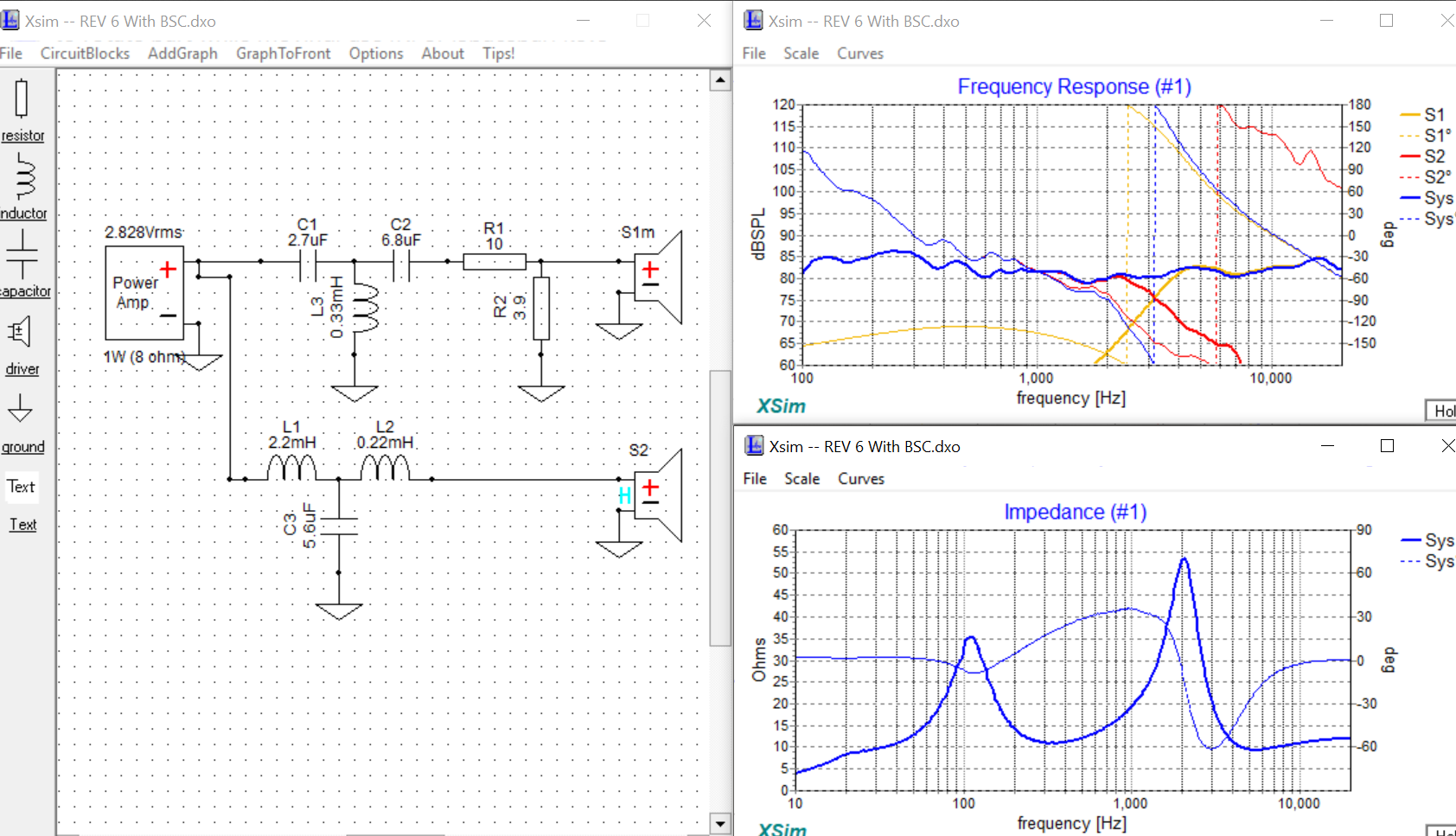

I found the driver in my storage room. How it got there I don't know
Ok, so I came up with this and in the impedance graph it has a peak at 2khz. What does this mean and how do I correct it?

the last combination seems to be better. The tweeter is still to high in level
You have to cosider the DC resistance of the coils, add a seriell resistor.
You also have to consider the baffle step
you do not need to compensate the impedance
Your amplifier should not have a problem with it. A crossover normally sees an impedance peak. Yours is a little low in frequency, it makes me wonder how you arranged your filters, or the traces..
Yeah, I don't really trust the traces. But, I will try to build the crossover anyway and see how it sounds. But, before I build it, will the impedance peak cause any trouble to the amp or to the speaker? How will the impedance peak affects the sound? Thanks for your help!
Also, how do you integrate BSC into a crossover design? I read that using a larger coil on the woofer is one way. Is there another way? Thanks!
A parallel inductor and resistor - both in series with the woofer (first components after the source / amp). The inductor provides only DCR impedance from 0Hz up therefore no cut to bass frequencies. As frequencies rise, the inductor starts increasing in impedance (baffle step) and current sees the lower impedance path through the resistor thus providing the fixed cut needed above the bafflestep. aka low pass shelving filter.

It's a combination of acoustic, driver and crossover related things. While it's possible to explain each variation of the impedance, it's also possible to see different curves leading to the same result. Some make sure it's drivable by the amp, some try to optimise it and some study it for what it reveals.
