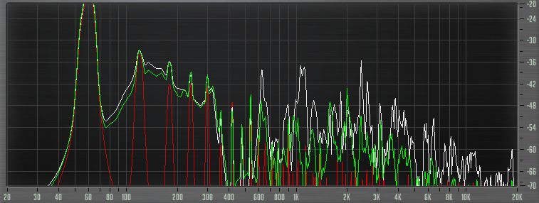

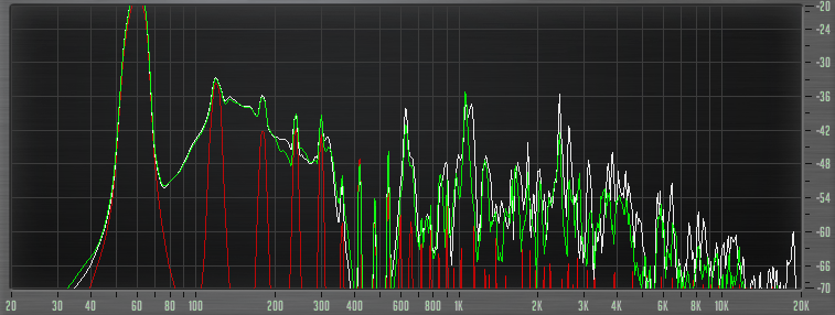

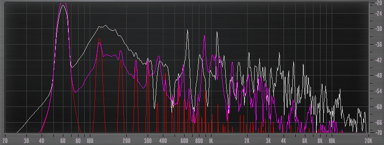

To follow up, here is a graph showing the cabinet wall frequency response using my DIY accelerometer system. Red is power line hum components, so you have to compensate for the effect on the remaining curves. White is the bare cabinet walls.
Treatment #4 (above). 3 mm layer of liquid nails sandwiched with multiple 1/2" x 1.5" pine strips (violet). As noted above this is very effective over most of the frequency band, except for a large peak at 900 Hz.

Treatment #6. Here is the effect of a single layer of the mat covering about 70% of the enclosure wall (green). As you can see a single layer has very little effect. (Presumably it is more effective on metal automotive body panels.)

Treatment #7. Here is the effect of two layers of the mat with a 1/2" x 1.5" x 7" pine strip epoxied at a diagonal onto the mat sandwich (green). This eliminates all peaks above 500 Hz.
attachment.php
Conclusion. Although a little more expensive and harder to work with than treatment #4, treatment #7 may be worthwhile.
