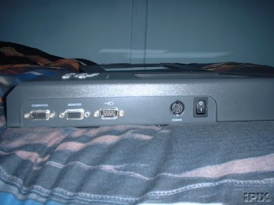

do you have access of a pic of the power input/ panel? that may help in finding what it takes. PS wise
Power supply photo!
Hi, here is the only pic I can get. It is unclear whether it is a 5 pin din AT type socket. Working on pure assumption (and we all know what assumption is the mother of), I'd imagine it to be fairly likely to be an AT keyboard type socket as they are very standard

Theres something about psu's in the good panel bad panel thread, heres the relevant part
Hi Acravero and all of you...
I am new to this forum but I have been messing around with LCD panels for a while. I will do a review of all of the ones I have in due course.
The power supply that I use for my Proxima Ovation panels is nothing more than a PC power supply with the cables hacked into. It was the
cheapest way I could find to get +5v +12v and -5v with sufficient amperage! The 5 pin DIN plug is obtained from radio shack, however,
I have been known to just stuff the wires in the holes. The great thing about PC power supplies is that they trip out when you short 'em!
Just turn it off and on and you are good to go again!
Looking at the side of your panel, from left to right in the semi circle of pins in the power input plug, connect the following from a PC power supply...
0v - Black / -5v - White / 0v - Black / +12volts - Yellow / +5v - Red
Check the power supply outputs if you are unsure whether it is a standard AT power supply. You will 99% of the time find that the color codings
are right no matter what manufacturer it came from
If you wanna get snazzy, buy an enclosure and some fairly heavy 5 core cable. Keyboard cables do NOT work, they will not carry sufficient
current to the panel even though it is tempting to use the connector.

LOOK 6150 pics+manual
Hey hope this helps, its for a 3M 6150, I got no clue on this stuff but should help u out, the manual says in the spec -
Power supply unit, 100-250 V~, 50-60Hz, 1.2A
Power Supply 7 pin DIN plug.
Hope this helps
I can add pics if u like

A close up phot of the socket wd be great, but the following would suffice without a photo:
1 - you said 100 - 250 v that's the INPUT voltage, there would be another figure there somewhere for the output voltage - probably on the transformer block on the mains lead. 1.2A sounds about right tho.
2 - on the 7 pin connector, are all the 7 pins in a continuous arc, evenly spaced out, or are they irregularly configured, ie 5 -space- two or something?
3 - is the socket itself the same size as a midi or din type plug? I assume it is.
