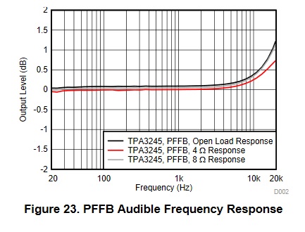

I think that this picure is the answer;
theres a +1db in frequency response a 20Khz due pffb on 8ohm load.
That's why TI added a 330pf feedback capacitor
on op-amps in pffb. I initially didnt put this because
the TI implementation does not suit the 3e-audio board:
in the latter, the op-amps using se input are cascading,
so there would be 2 low pass filter on 3255 non-inverting input
and just one on the inverting input.
This is a flaw on the 3e-audio pffb implementation,
in fact they reccomend to use balanced input,
where op-amps are not cascading.
Since I use SE input, I added just one feedback 330pf capacitor on main opamp, and treble seems to be better.
