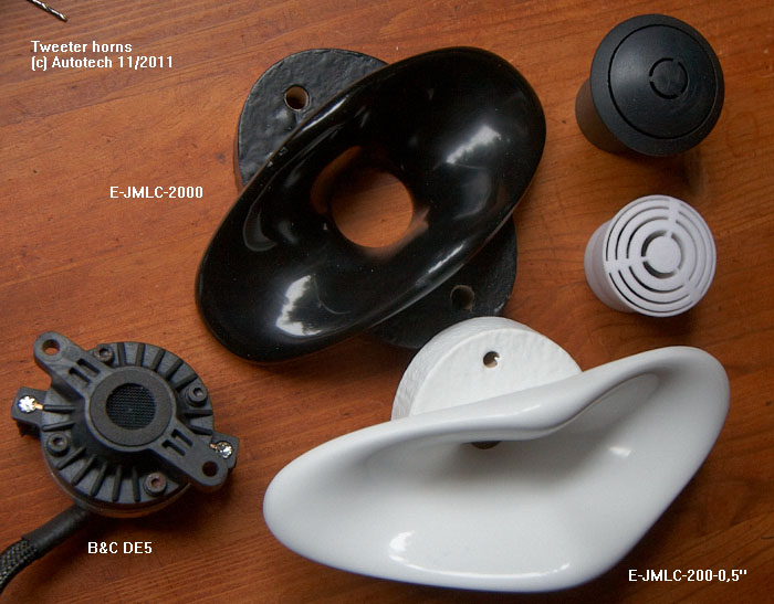

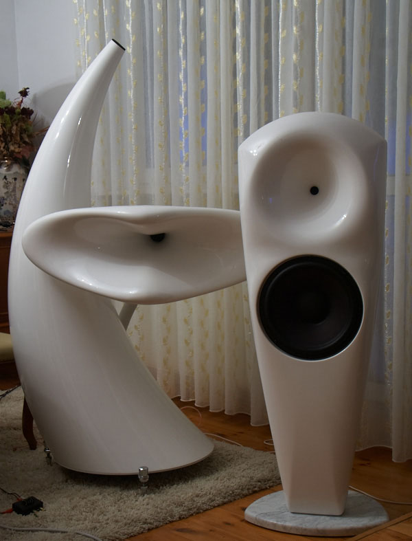

Did you 3d print your proposed phase plugs? What about your JML style waveguide/horns?
These look cool but a bit vulgar. Something about the look.... 🙂
All above were my designs. 5 slits was properly drawn and no improvement - to many slits. Previous prints were based on badly designed plugs - suprisingly an improvement 🙂 PP must be tight to diaphragm. Less slits are better for 2" VC. Just experiment: Fresnel, Tangerine, bone structure, WG curve down to diaphragm etc. - more to come.
This small ejmlc 2000 is fine - my friend have used with Beyma 12BR70:

I've used largest ejmlc-300 (want one for AMT):

Cool stuff. Can you share the ejmlc .stl file with us?
