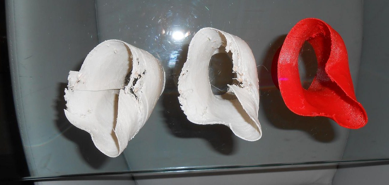

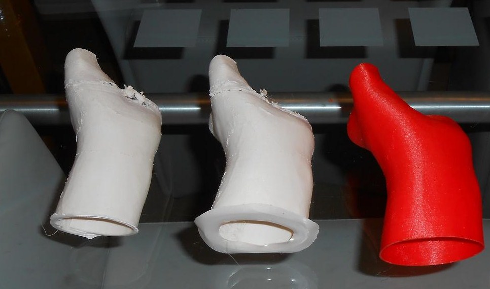

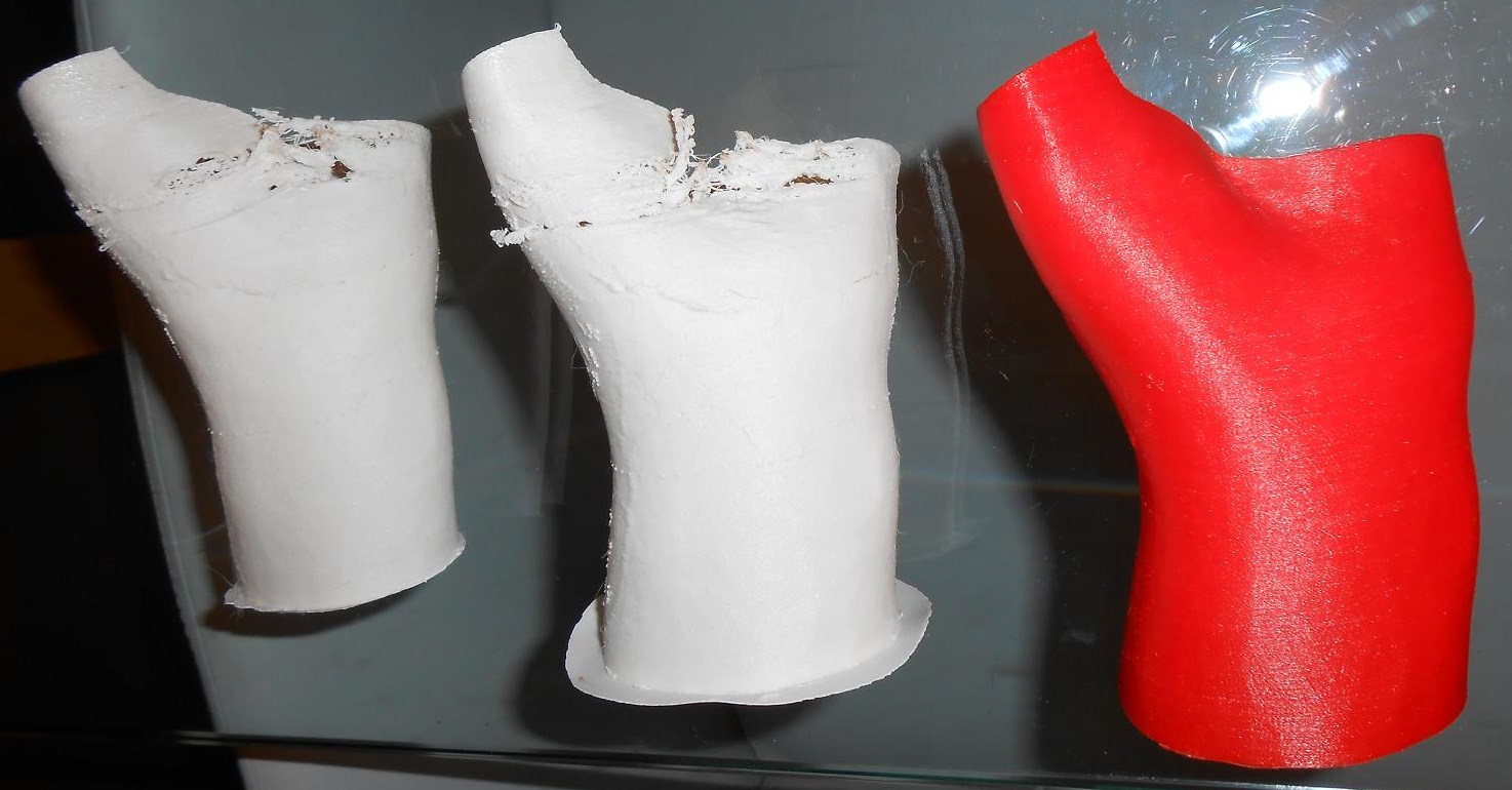

3D printers also have a hard time with the combination of warped surfaces and large curvature changes.
See for example a wrist brace, printed in 3 different plastics.
The rough spots on the inside and outside are the result of surface peak anomalies in the model.
This one was calculated from different angle images, the screen image of the model doesn't show these peaks.
One would have to smoothen the model at numerical level, to remove them. Also a downside of modelling from digital images with current available software, makes a scanning cabin more rapidly pay off its expenditure.
