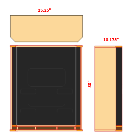

Nope, I'm still changing the cutlist from the cabinet for the previous (but never built) version of SmallSyns so the new horn will fit in it. Then I have to go get more plywood, don't have quite enough to do it.
Then find the time to get back to sawdust (work on the house is taking priority at the moment, have some shelves to put up).

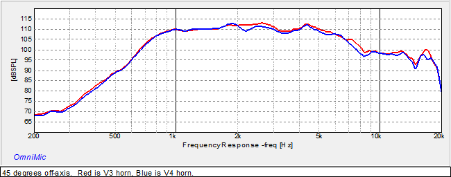

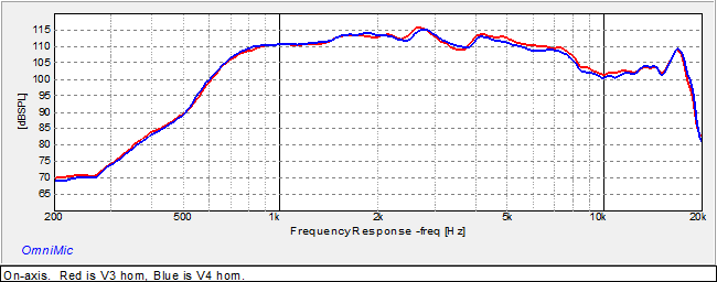

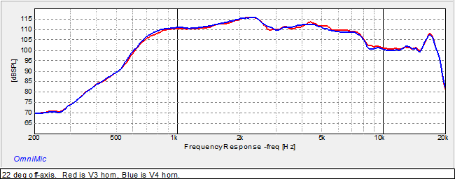

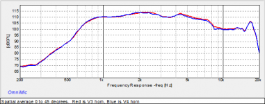

Since deciding to switch to the DNA360 for the tweeter with these horns, I changed the 3D print model so that the throat angle matches the exit angle of the DNA360. Takes a while to do that, then a while to print the two horn halves (not to mention to screw up some on the prints). Anyway, out of interest, here is a comparison of frequency response with the two horns. On axis, 22 degrees off-axis, and 45 degrees off-axis. Red is old horn, Blue is new horn. Also a comparison of the spatially averaged (only of horizontal) curves.
Not a huge difference in measured frequency response magnitudes.
(note: these are with all midrange and woofer apertures open and only the DNA360 installed)

Interesting that the measurements don't reflect much of a difference between the two waveguides.
