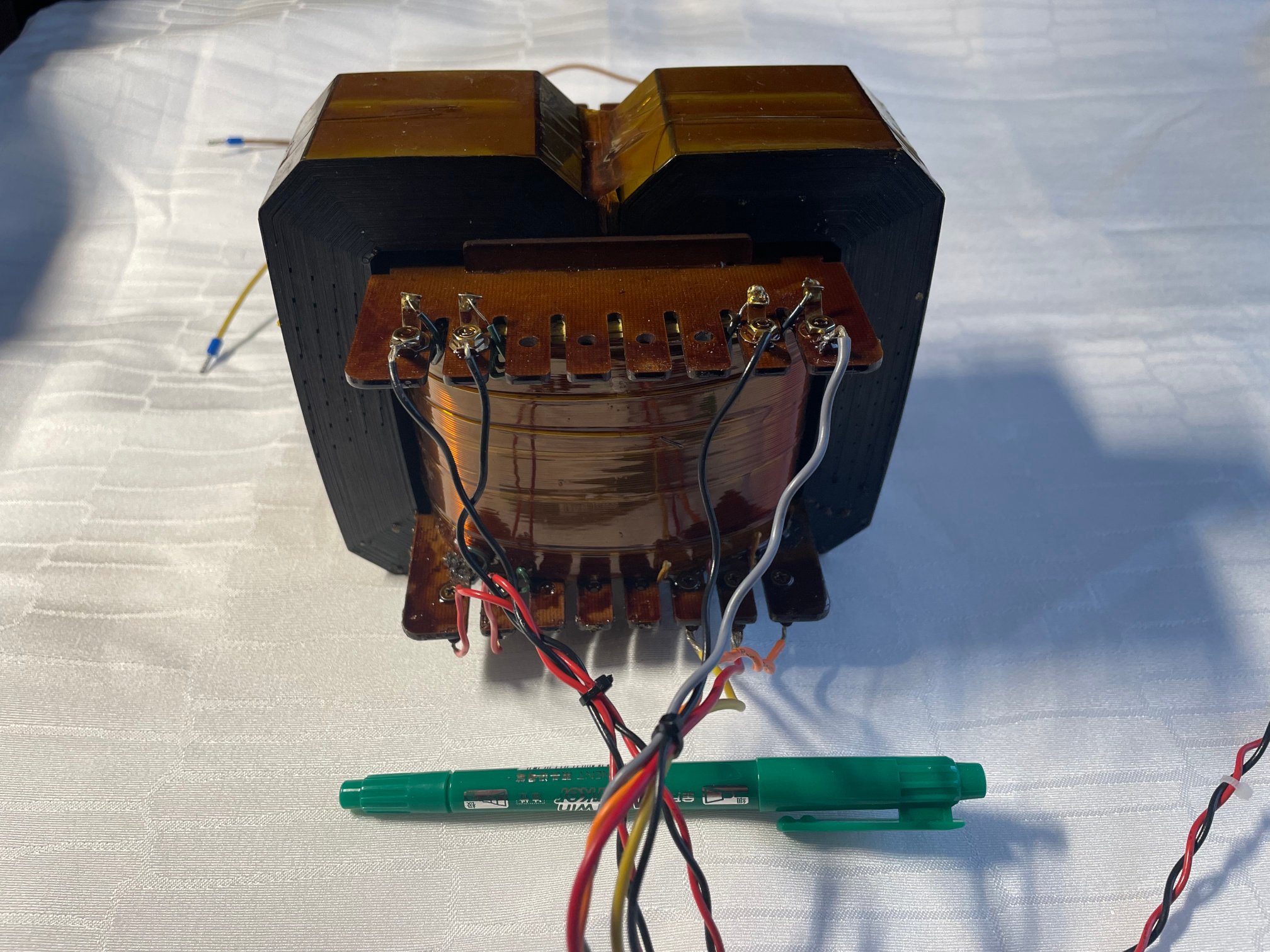

Hi, I printed bobbins on Creality K1. I even made a freeware software for bobbin design:
https://www.vacuum-tube.eu/wp/?p=821
Please note PLA deforms even at direct sunlight; PETG have thermal distortion resistance till ~70C; Nylon is horribly slow to print, requires heated chamber and filament dryer, more or less reasonable choice is Calibram BT.
I would suggest to use my software and cut bobbins from presspan with laser. Its cheaper variant, you can even impregnate finished transformers in the oven at 140C.

Thanks a lot for your suggestion and excellent work! Your interlocking bobbins resemble classic ones that were made from 1 mm phenolic board. Anyway, I'll need to find a way to reliably fix the inner flanges of two or three chamber bobbins.
Best regards!
Use cyanoacrylate glue or non-acid construction silicone available in many shops. Removable spacers between inner walls (flanges) can fix them while glue settles up. BTW, you can 3D print clamps (just a brick with inner slots) which hold all walls/flanges parallel while glue dries.
