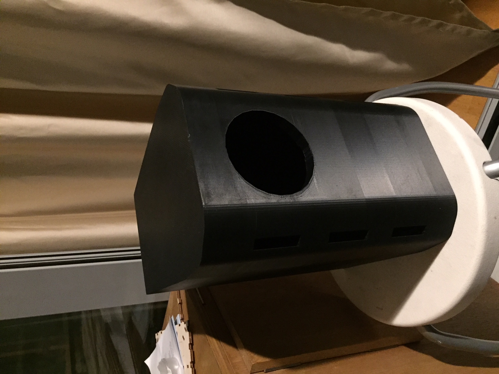

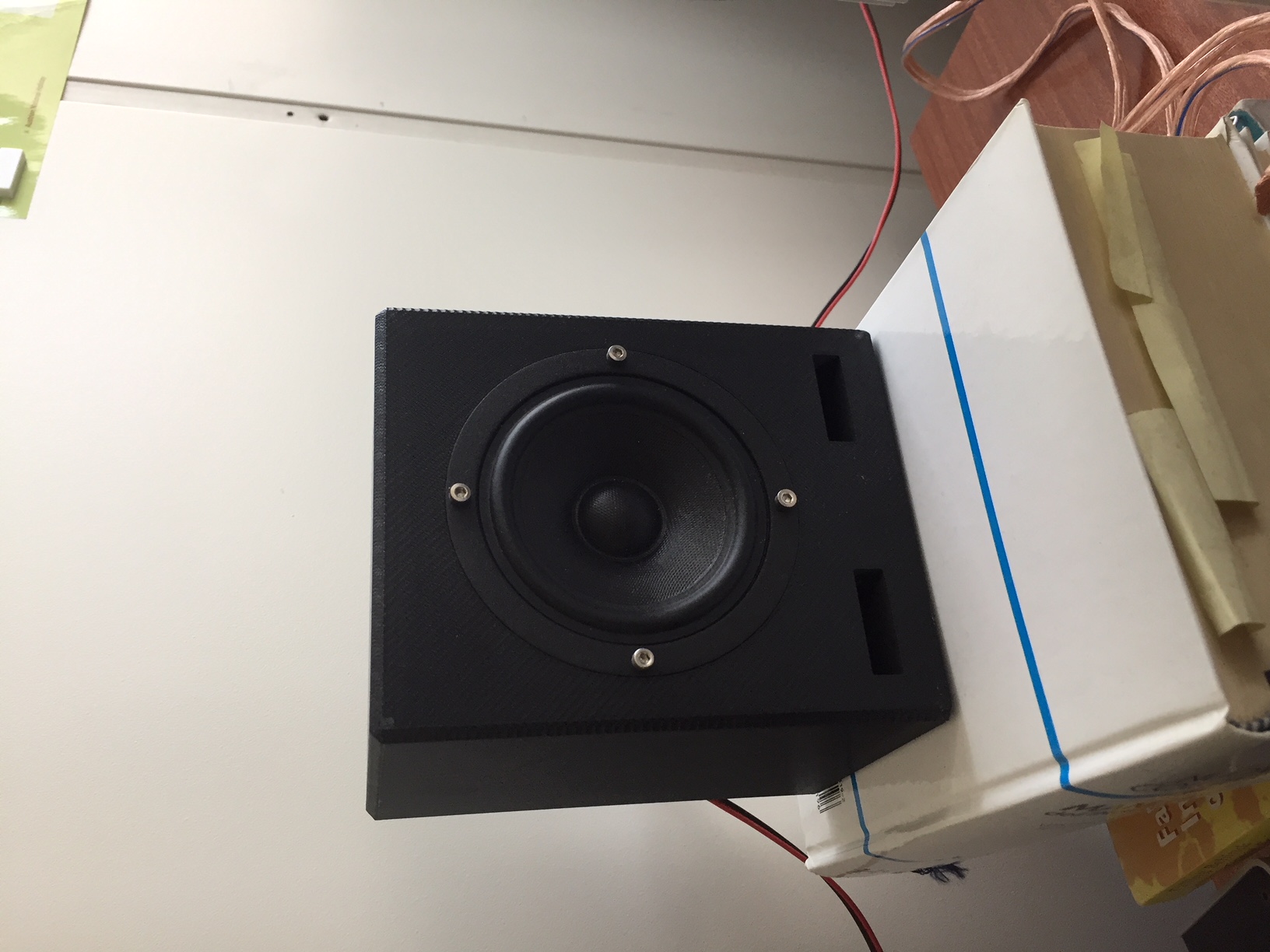

Dear All,
I built one pair of speakers using a 3D printer and I am in the process to make a second one. I was curious if any of you has tried this.
The 3D printing allow to realize fancy and complicated shapes and it come as a monolithic structure, so in principle it is very rigid. The printer I use makes an honeycomb structure inside the bulky objects in order to save on raw material.
Attached some pictures.
D.

I have been very interested in using 3D printers for speakers and have some ideas to try… no 3D printer yet. Neither Chris or Bernie like building the smaller trapezoidal miniOnkens (like Davide’s 2nd picture & smaller) because they are too small to easily clamp.
dave
