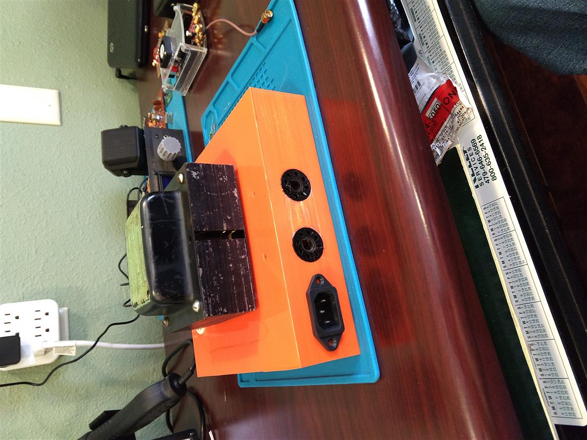

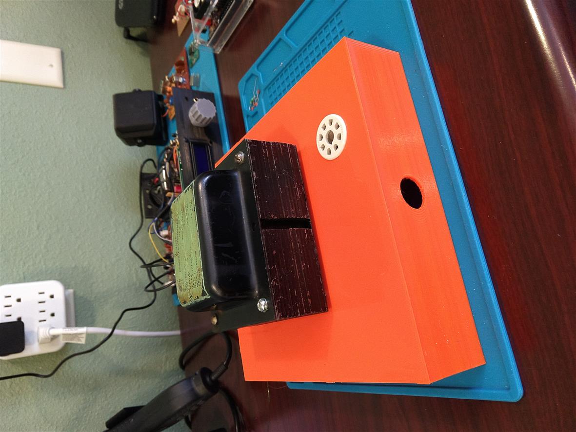

So, here is power supply test article number one.
This was printed here at the lake, on the $100 USD box of parts printer, with ordinary PLA, 0.2mm layer height, 50% cubic infill, at 50 mm/second speed.
It's not a thing of beauty, but looks satisfactory for the immediate purpose as an experiment / test mule. It may look a bit better when the support remnants are cleaned out of the holes. Or it may not. But it's a start; you have to start somewhere. The article used about $4 USD worth of plastic and printed overnight into mid morning.
The deck and side walls are 5mm and physical strength appears to be completely satisfactory even with this very heavy transformer, at least with the transformer cold. At operating temperature may or may not be different, but I still have the earlier print out of the test transformer template that can be used as a strengthener or spacer if need be.
The overall height is 50 mm ( 45 mm usable ) and this looks to be marginal for vertical mounting an IEC connector, and for interior parts guts. I like things compact and low profile, but article two will likely be at least 60 mm overall height, maybe taller.
I put a rectifier tube socket hole in the top, which I will likely install to see how the ordinary PLA responds to the heat source, since rectifiers run with the heat of all the B+ going through them. I added a hole for some choke leads, but am not sure what choke I will be using, so I left mounting holes out.
I may skip a choke, and use something more modern like a MOSFET ripple filter. I am also leaning toward using the 5 vac taps on the power supply to power the 12AT7; this would eliminate one transformer, but require using something like 6AX5 as the rectifier, which was proven very satisfactory in the child resistant SSE. Or sand.
I probably won't do anything else on it over the weekend; I brought my RF travel kit ( a 16 inch tool box ) to the lake with me, and it is almost completely SMD / SMT parts, not a lot of through hole since they take up so much space, even in the smallest form factors. I am making up a high voltage / electron tube travel kit, but getting a decent variety of parts in it, considering the physical size of OPT's, power transformers, tube sockets, leaded parts, etc., is challenging. In any event, I left it back home.

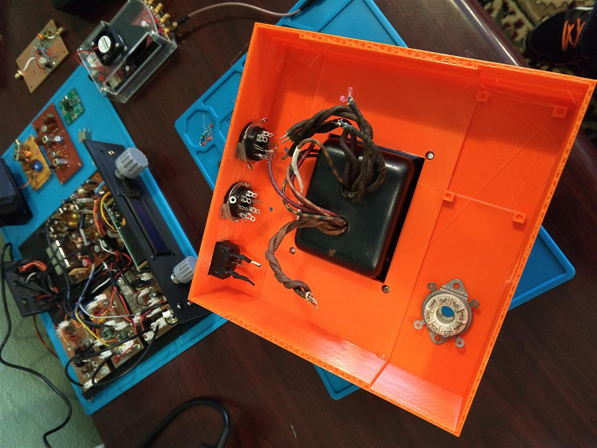

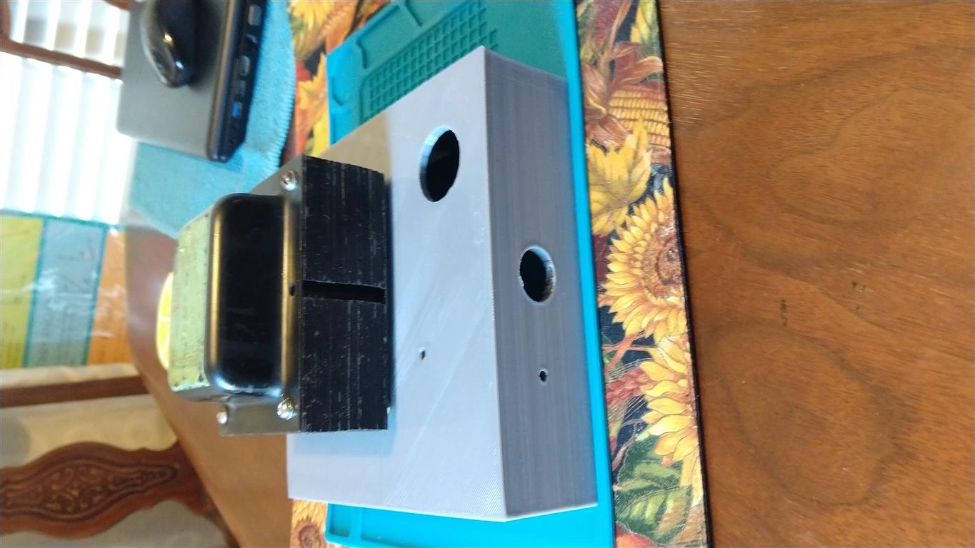

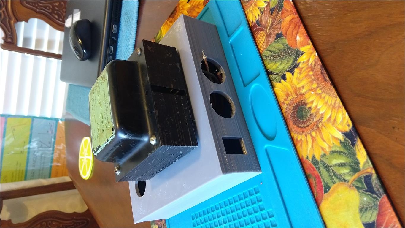

So, test article 1 was certainly strong enough - I could stand on it without stressing it, but the 5 mm top and side thickness made it difficult to mount the other stuff in a cosmetically acceptable way.
Test article 2 is constructed differently, it has extra strength over the top and sides where the heavy pwr xfmr is located, but the rest of the article is substantially less robust - about 2 mm. I also used considerably less infill - 20 %.
It looks and feels adequate, but for one issue - the plastic between the two octal sockets on the rear panel simply failed to fuse for unknown reasons. From a cosmetic standpoint, the rear panel is the place to have an issue, if one occurs. From a structural standpoint, it is a bad place and there is a real possibility that this will be a significant issue. I put some glue into the delam spot to try and stabilize it, but that may or may not be helpful.
I don't know that I will get a chance to wire on it tomorrow. Print time was about 26 hours. Material cost about $4 USD.

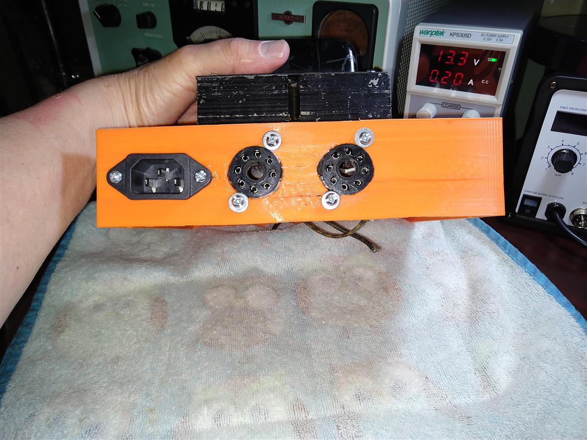

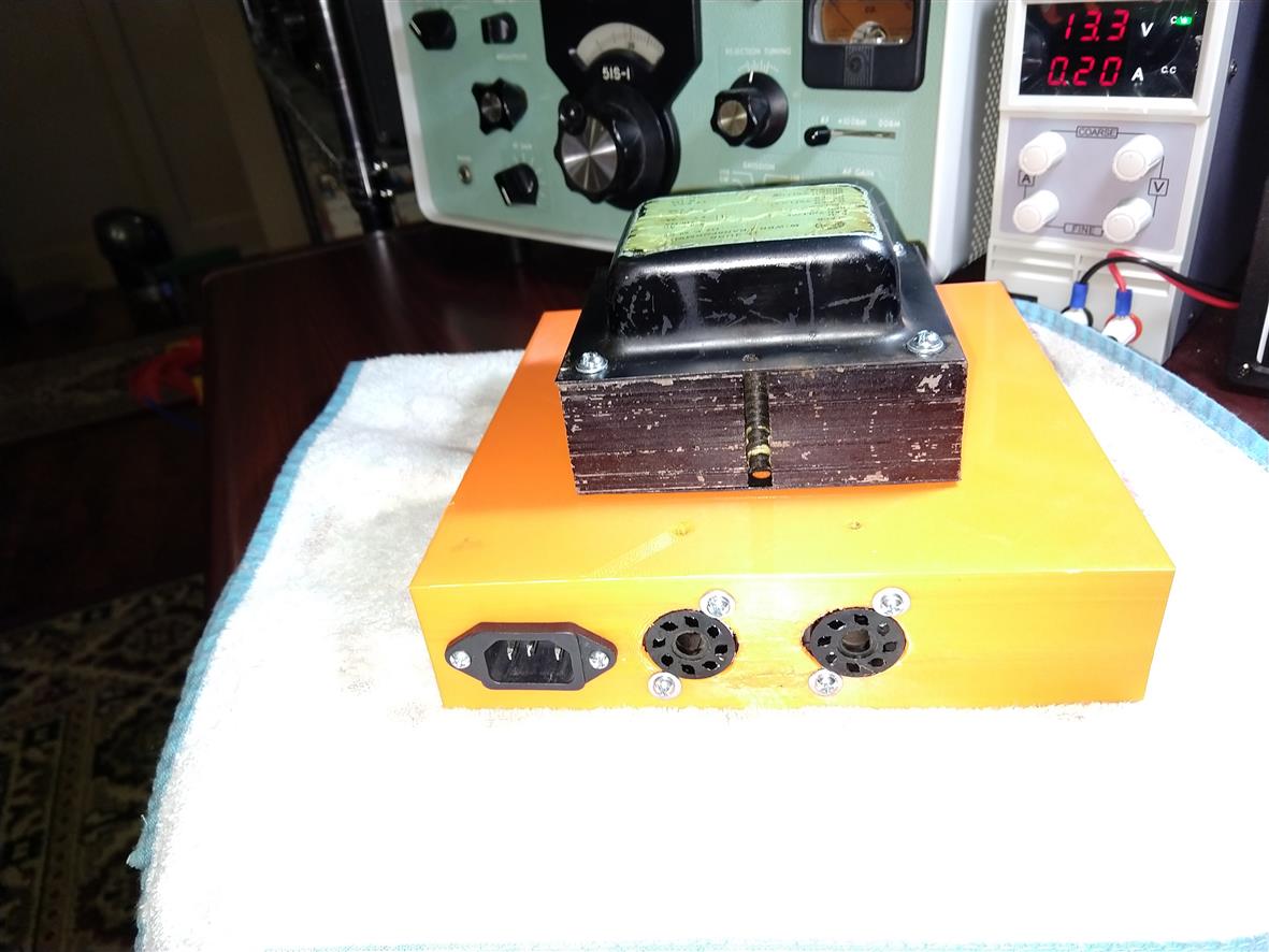

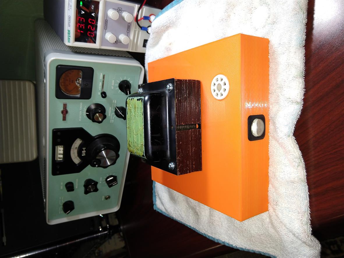

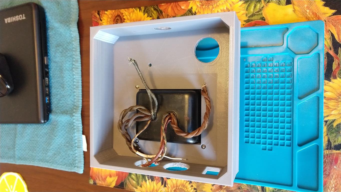

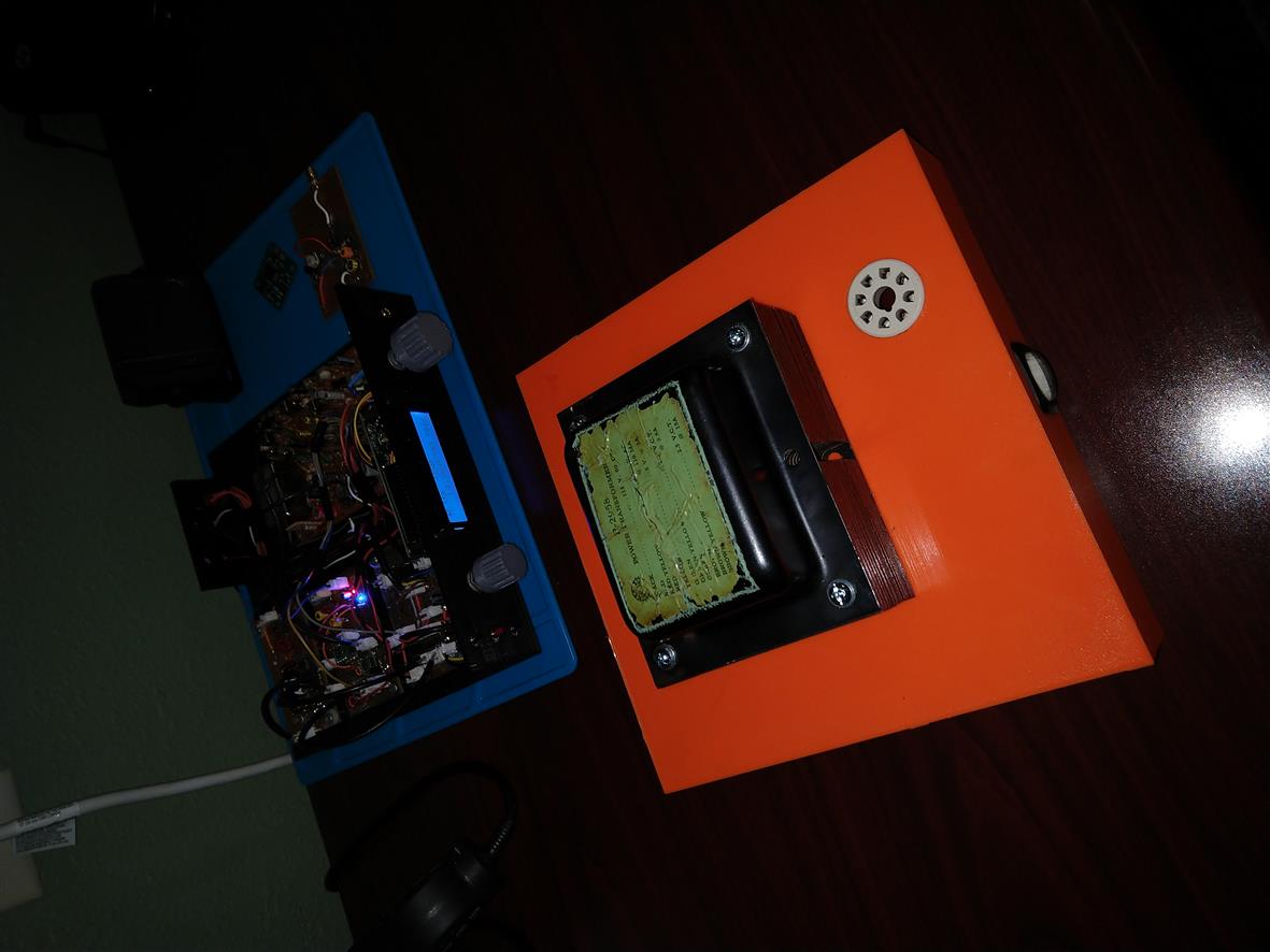

Not a good DIY day.
Worked some in the morning on another project - nothing worked even close to satisfactory.
So I decided to wire the power supply for this project. When I went to mount the front panel on / off switch, it would not fit. Checked the dimensions in the tinkercad model, and those dimensions were wrong, at least for the switch I wanted to mount today.
When that was "fixed", I decided I had to deal with the back panel around the octal sockets where the plastic did not fuse. The original intention was that the sockets would fit tightly enough so that no mounting hardware was necessary, which is not possible at present. Unplanned and hastily conceived plan B ( for "bodge" ) was to use mounting hardware, and, as I was drilling out the fourth of four holes, you guessed it - the weak back panel split from the edge of the IEC connector all the way to the opposite edge of the panel. Since I was trying to stabilize the brittle plastic with my finger while I was drilling, I also managed to drill a hole in my finger.
After I got the bleeding mostly stopped, I stuck the sockets in, screwed the mounting hardware in, and sat it on the desk and admired the wide split running almost the full length of the panel, about 1/8 inch ( 3+ mm ) wide at its maximum, while I kept the compression on my finger.
As I thought about whether or not this train wreck could be salvaged, or if I was going to have to start over and print test article 3, and what changes I would make, I was drawn to the SMD/SMT rework hot air gun sitting behind the disaster. It occurred to me that the model plastic starts out solid from a reel, it gets heated to about 200 C ish in the extruder, and then it cools again to a solid after it has been deposited. So why not just reheat it?
That idea actually worked, sort of. I set the gun to 200 C, and carefully heated the plastic while applying pressure to close the fissure. I also solidified the plastic in between the octal sockets. The result is not pretty, but it became acceptably solid enough for me to go ahead and mount the rest of the hardware and continue on with this test article.
In the pictures, you can still see much of the length of the fissure. It looks in the picture to still be there, but this is a shadow as the edges are offset from each other a little bit. The result was actually much better than I expected - I was resigned to throwing it in the trash ...
The transformer is spaced just slightly above the chassis on some nylon spacers so that air can flow around it. Should be able to get it wired and see how the chassis holds up to heat pretty soon.
