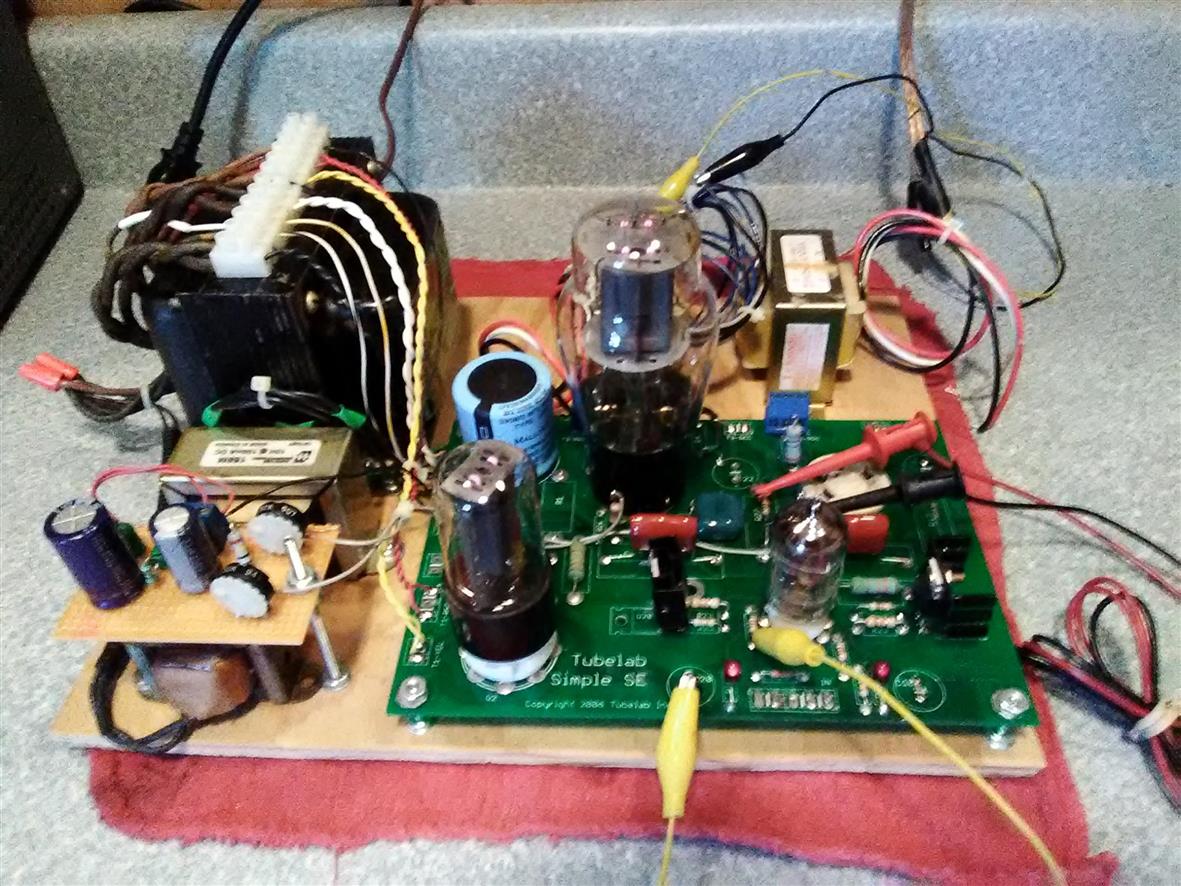

The experimental DH SSE that emerged ( 2A3 finals ) has worked without any component failures or other issue for the last three years. The TSE and TSE II have nothing to fear from that amp, but it is a nice and very simple beginner DH amp nonetheless.
The chassis - a 12 x 10 inch piece of scrap plywood, plucked from a trash pile ( literally ), bugs me. Likewise, the exposed voltage, while acceptable at the time, due to changing circumstances is now unacceptable.

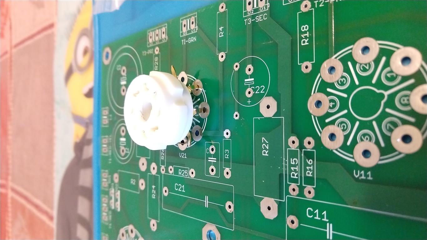

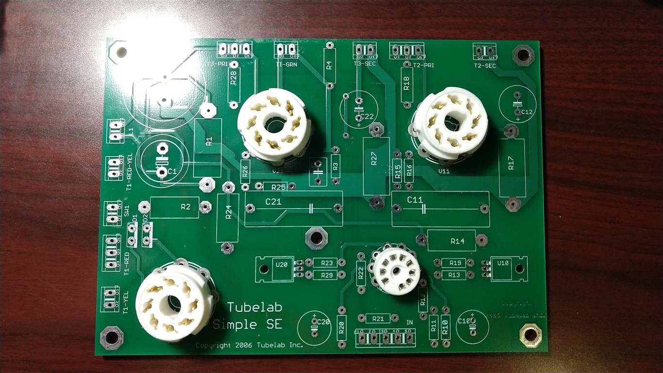

Another thing that has bugged me was the level of damage caused to the SSE PCB to make a DH amp. It's terrific for experimenting, but it's not for the faint hearted builder. Also as part of this thread, will be an attempt to build a DH SSE using readily available, directly heated, tubes that does not damage the PCB in any way - all modifications will be fully reversible.
I hate metal chassis working, even though it is the best choice for an amplifier, imo. I have zero woodworking skills, so that's out. Recent acquisition of some 3D printers has caused me to consider whether or not a 3D printed chassis can successfully support a tube power amplifier, specifically, the experimental DHT SSE and unmodified SSE amps.
Printing a breadboard or complete chassis may or may not work. It may be that the heavy power supply will need to be separated from the main chassis. It may be as simple as a plastic printed plate emulating the breadboard piece of wood, or maybe mounted on an inverted metal chassis, or a nice wood base. Heat from the tubes and power transformer may be a deal breaker. It may be a complete waste of time, plastic and bandwidth.

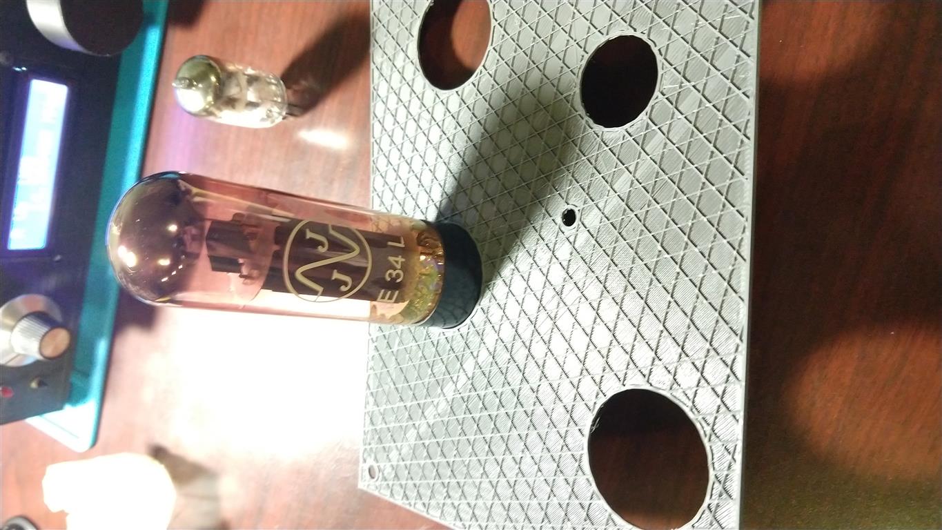

To start somewhere, I made a template of the SSE PC board, and printed it out, and it looks pretty good, but I don't have a board here at the lake to match it up with and make sure all the holes correspond satisfactorily. It may need some minor tweaking. I made a quick 10 x 12 x 2 inch model chassis ( the same size as my Hammond chassis / cage based child resistant SSE ), with the SSE template embedded, just to get an estimate of the economics. At my current filament price for high temp PLA, the 12 x 10 x 2 chassis would be about ten bucks at 50% infill, and will decline some as more holes are added for transformers, meters, etc. So, it looks like the economics are favorable.
I am still in the middle of another project that has turned out to be more difficult / time consuming than I had anticipated; there will a lot of trial and error involved here; and I can only print the big parts at my office where I have the big printer, so this project will play out over some length of time just like its predecessor, but if you are looking for a reason to build another SSE ( and who isn't? ) this could be that reason.

I tweaked the template a bit to give a better correspondence around the tube sockets, and made a partial print of the first five or six layers of the template.
This one looks usable - the holes for the tube bases may or may not need to be opened up a bit for more ventilation, and some ventilation for the 10M45's might be needed.
I tried to edit the first post, but apparently attachments cannot be added or removed, although it looks like the text can still be edited.

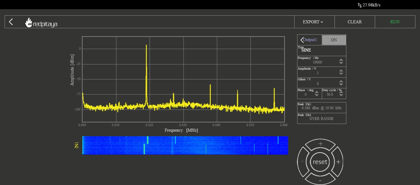

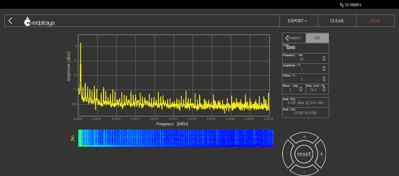

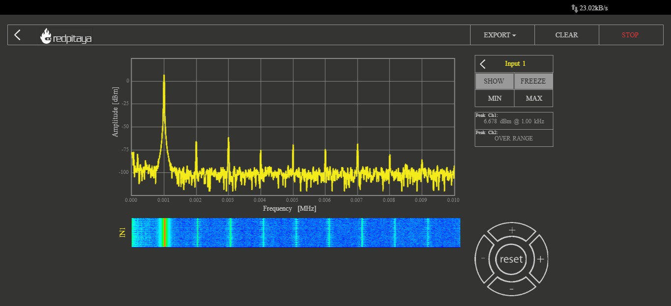

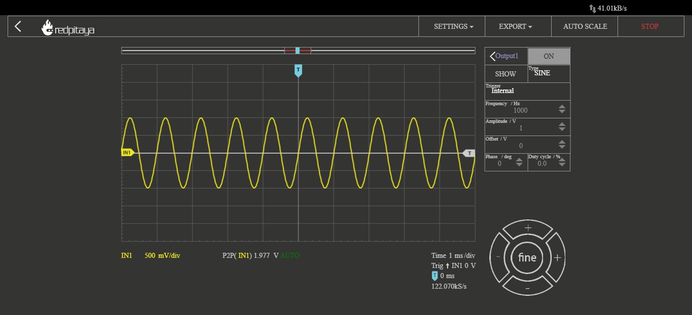

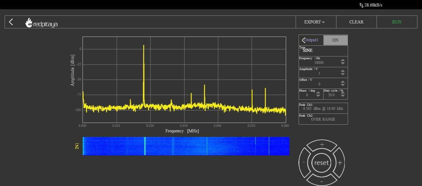

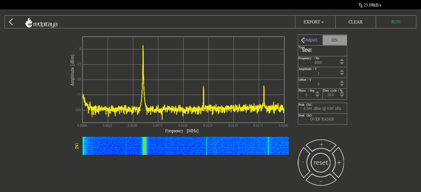

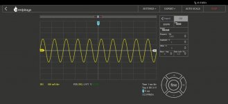

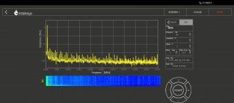

The predecessor 2A3 SSE was characterized with a Heathkit AA-1 Audio Analyzer ( assembled by me from an unbuilt kit four or five years ago ), but I am going to try to use something a bit more modern on this build.
I got a thing called a Red Pitaya ("RP")
Red Pitaya - Stemlab swiss army knife for engineers
to use in another project, and never really considered using it for audio since I have the aforementioned new AA-1, and a companion HD-1 THD analyzer and Leader audio generator, but it looks like the RP might be useful for audio equipment as well. If it works, a shelf full of equipment can be replaced with something about the size of a pack of smokes.
The first screenshot is a 1 volt ( 7dBm ) 1 KHz FFT of the channel one signal generator output looped back into the channel one input, and displayed on the FFT spectrum analyzer function. It looks like about 0.05 - 0.06% THD to me, so should be plenty usable here. I measured my cheap hamfest scrounge Leader generator at about 0.04% with the HD-1, so this seems comparable to my old analog stuff, with the additional advantage of seeing a spectrum distribution instead of just a % number. THD is not hard to calculate, and there are online calculators that can do it from raw numbers.
The 1KHz sine wave looks nice as well. The other shots are 60 Hz, 6 Khz, 18 KHz and 19 KHz, all at 1 volt loop back, for two tone IMD testing. I don't understand the value of two tone IMD testing with 18 and 19 Khz tones ( maybe someone can explain it to me ), but the RP can do it, so I guess I will try it. The AA-1 has onboard 60 Hz and 6 KHz tone generators, but I usually used the leader to inject 200 Hz as a low frequency test tone, since the little OPT's I use do not handle 60 Hz very well.
The AA-1 is actually a very useful all in one piece of test equipment even in this era, if you can find a good one at a low price.

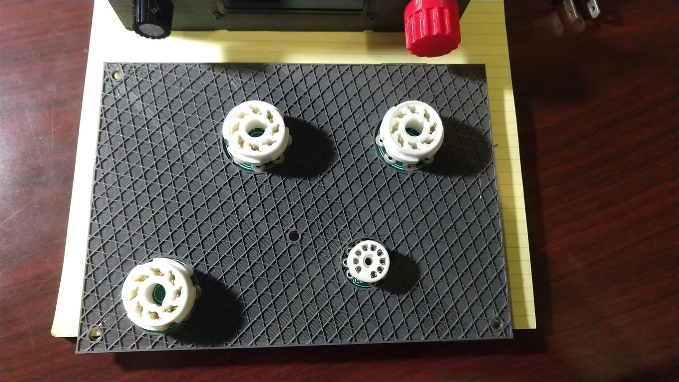

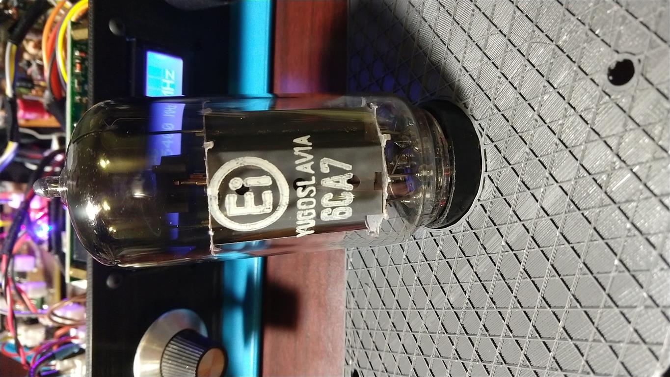

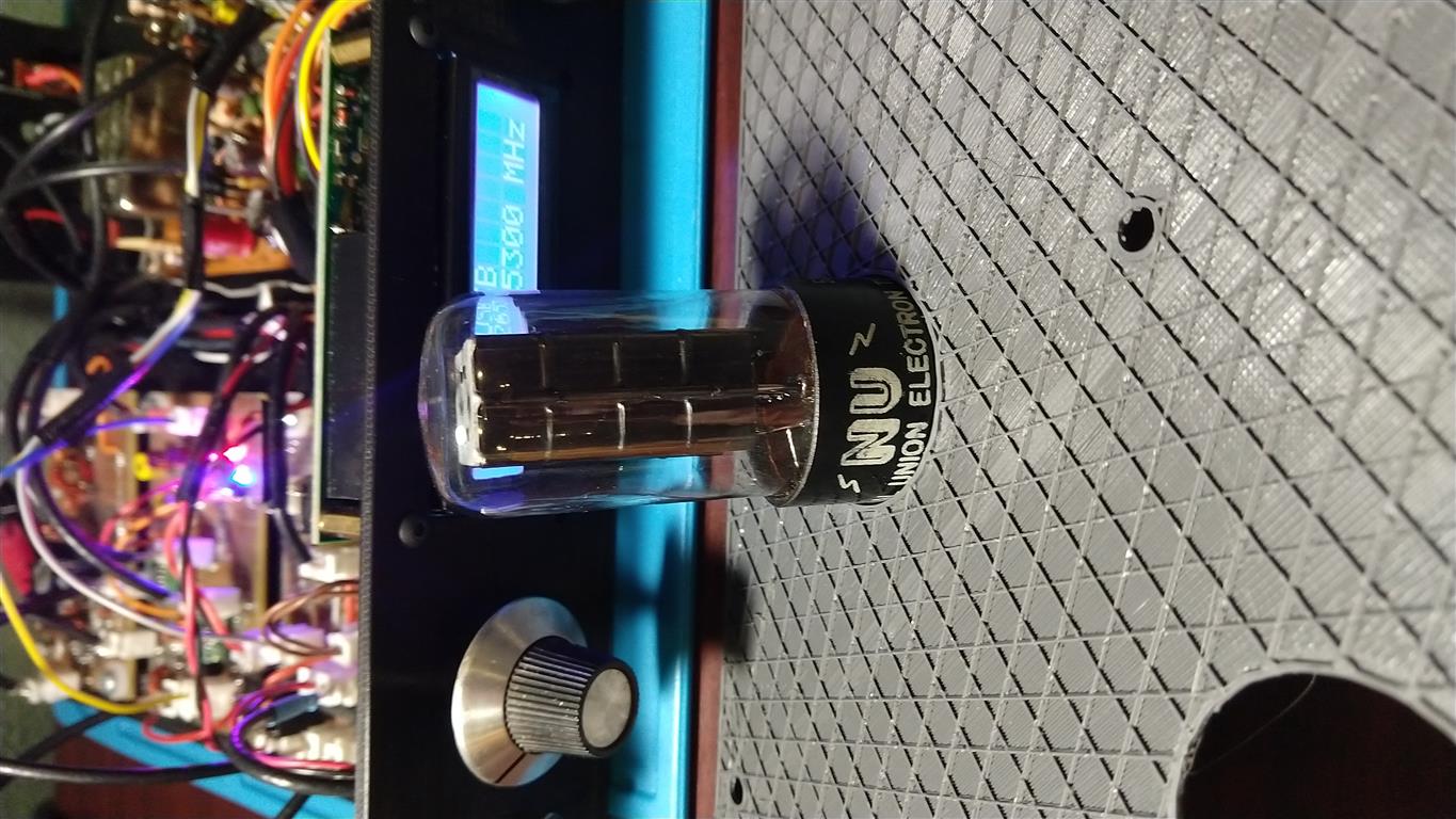

One of the things I had not given any previous thought to is the potentially poor manufacturing tolerance of cheap Chinese tube sockets. I grabbed three octals and one nine pin at random, stuck them in an SSE board, and while hard to tell from the parallax, they do not perfectly center in the outlines on the PCB. The socket stuck in the rectifier position is a particularly bad offender.
Regardless, I think there is enough tolerance in my template to be unaffected by this, although depending on the sockets, it may or may not look perfectly centered when viewed directly from above.
When passing the template over the tube sockets, it looks like it is sized to permit adequate ventilation around the sockets, so long as the template is below the upper surface of the octal tube sockets. Heat rises, so high heat PLA may not be necessary here.
For mounting above the upper level of the tube sockets, it fits the standard octal base and modern coin base like a glove, although heating of the PLA, even high heat PLA, may be problematic for this type of mounting. Fat bottom tubes like 6550 would need a much larger opening.
Tentatively, I think the most recent template is good to go for now.

When considering how to use directly heated tubes on the SSE, something it was clearly not intended to accommodate, my first thought was that you can’t get there from here. The 20 - 20 hindsight reality is that you can, easily, and anyone who wants an entry level, directly heated amp, should be able to produce a very good one with minimal effort and expense using an entirely unmodified SSE board.
I am not a tube historian by any means, but after De Forrest added the third element to the vacuum diode, a base / socket system with only four pins was entirely adequate for the vacuum tubes of that era, one pin being required for the plate (anode), one for the control grid, and two for the filamentary cathode. Thus, most directly heated tubes exist on a four pin base. As more electrodes were added to the tubes, and indirect cathode heating came to prevail, the number of pins on the base rapidly expanded, first to five, then six, seven, and finally by the mid ‘30’s or so, the eight pin octal base was well established.
The SSE uses the eight pin octal socket, therefore, to accomplish the goal of making a directly heated amplifier without any destructive modifications to the stock PCB, the first iteration of this project will be confined to directly heated tubes with an octal base.
The type 2A3 triode tube evolved into a 6 volt variant, the 6A3. The 6A3, when mounted on an octal base, became the 6B4G. NOS and new production 6B4G is readily available. 2A3 tubes have been proven to work satisfactorily with the existing SSE front end, provided that some component values are changed to reflect the lower B+ voltage that will be used, thus there is really no additional tinkering to be done to make a 6B4G SSE.
The SSE board uses the common 7AC octal tube pinout, The 7AC format assigns the pins as follows:
1. No connection, or metal shell
2. Heater
3. Anode ( plate )
4. Screen grid
5. Control grid
6. No connection
7. Heater
8. Cathode and suppressor grid ( or beam forming plates )
The SSE further incorporates a jumper between pins 1 and 8 making it compatible with the 8ET pinout ( EL34 / 6CA7 ), which brings the suppressor grid, or beam forming plates out separately to pin 1.

The only conflict between 7AC and 5S are pins 2 and 7. 7AC uses these pins for the tube heater, while 5S uses these pins for the combined cathode and heater of a directly heated tube. Other than the pin 2 and 7 connections, the 6B4 is a drop in tube for the SSE.
In practice, the conflicting uses of pins 2 and 7 is of no consequence. The SSE is a cathode biased amplifier. The directly heated SSE will also be cathode biased. Cathode biased directly heated power tubes, so far as I know, require a separate filament transformer or winding for each power tube, preferably with a center tap, thus the SSE filament circuitry, for the power tubes, is of no use to us anyway, and our directly heated tubes need to be isolated from it.
The captain obvious way of doing this is to just take the tube socket pins for 2 and 7, and bend them up and away from the PCB. All of the other tube socket pins will be soldered to the PCB as normal. The isolated pins on each tube socket will be used as solder points for the leads from that tubes filament transformer; the transformers center tap will be soldered to pin 8, thereby establishing the connection point for the cathode bias. To ensure there is no contact between pins 2 and 7 and the PCB, the socket can be elevated slightly, or some electrical tape or other insulating material can be applied to the exposed pads for pins 2 and 7.
