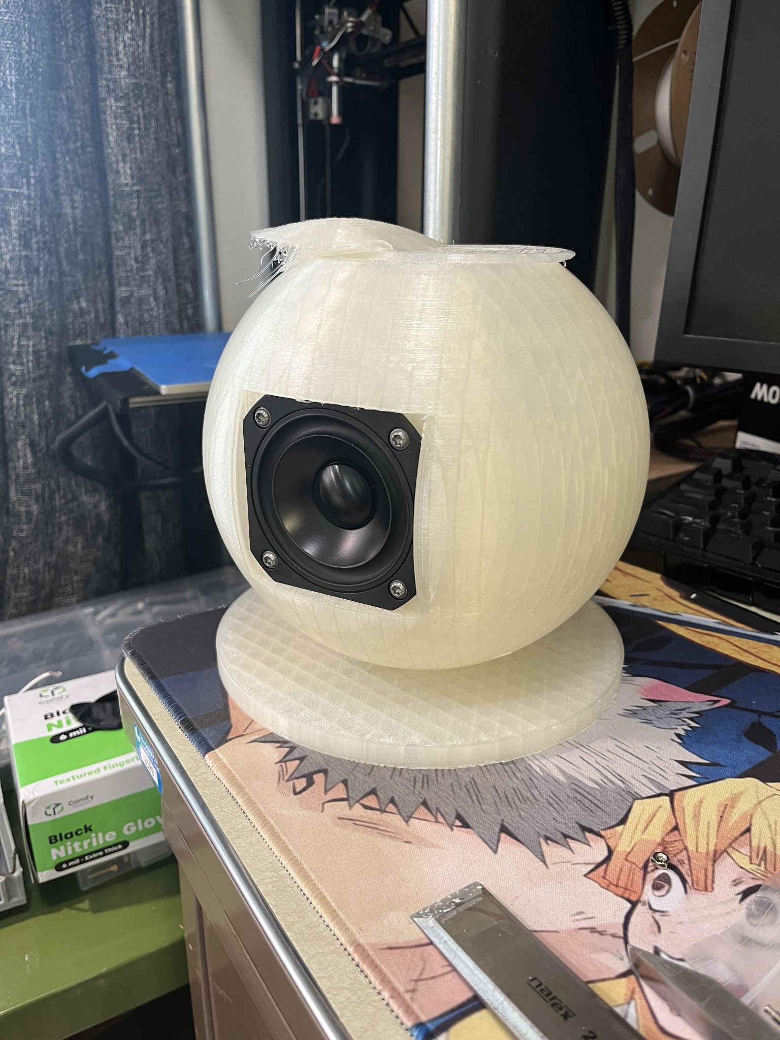

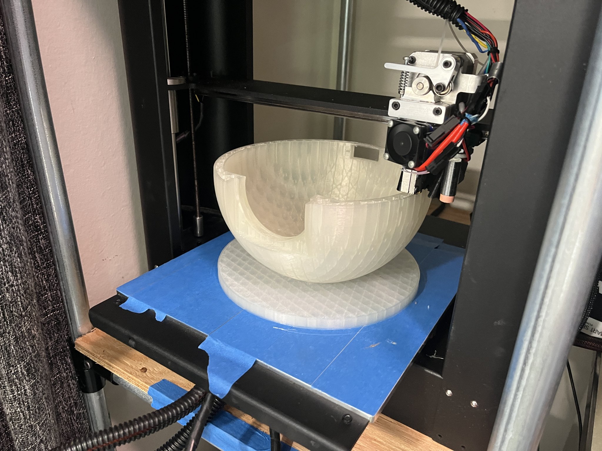

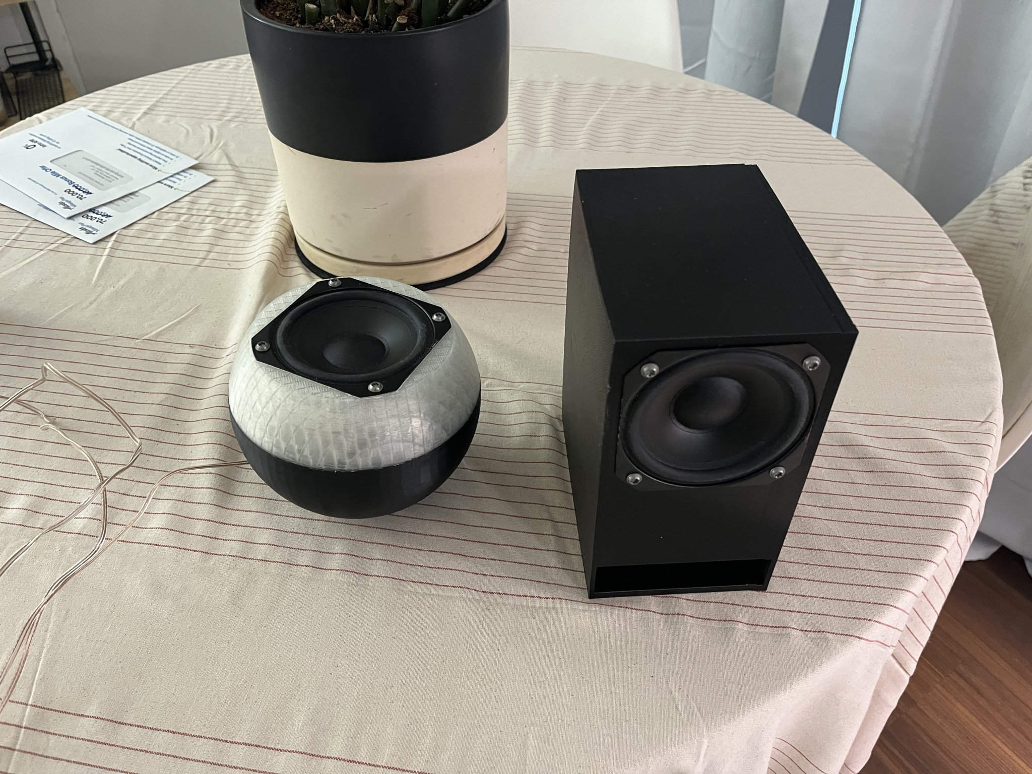

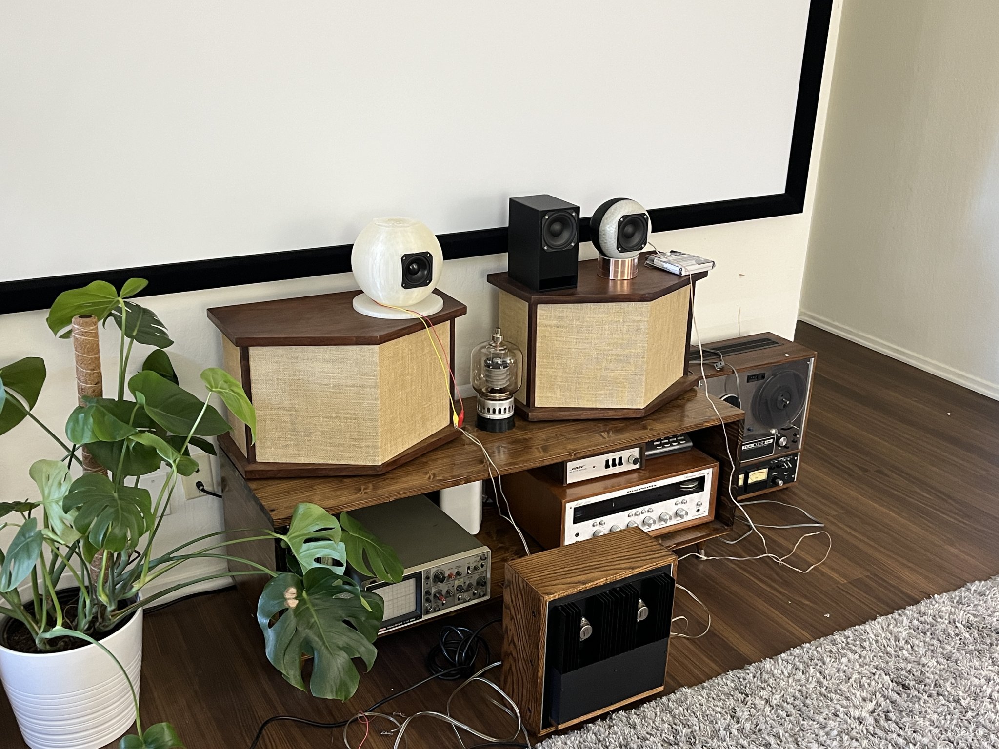

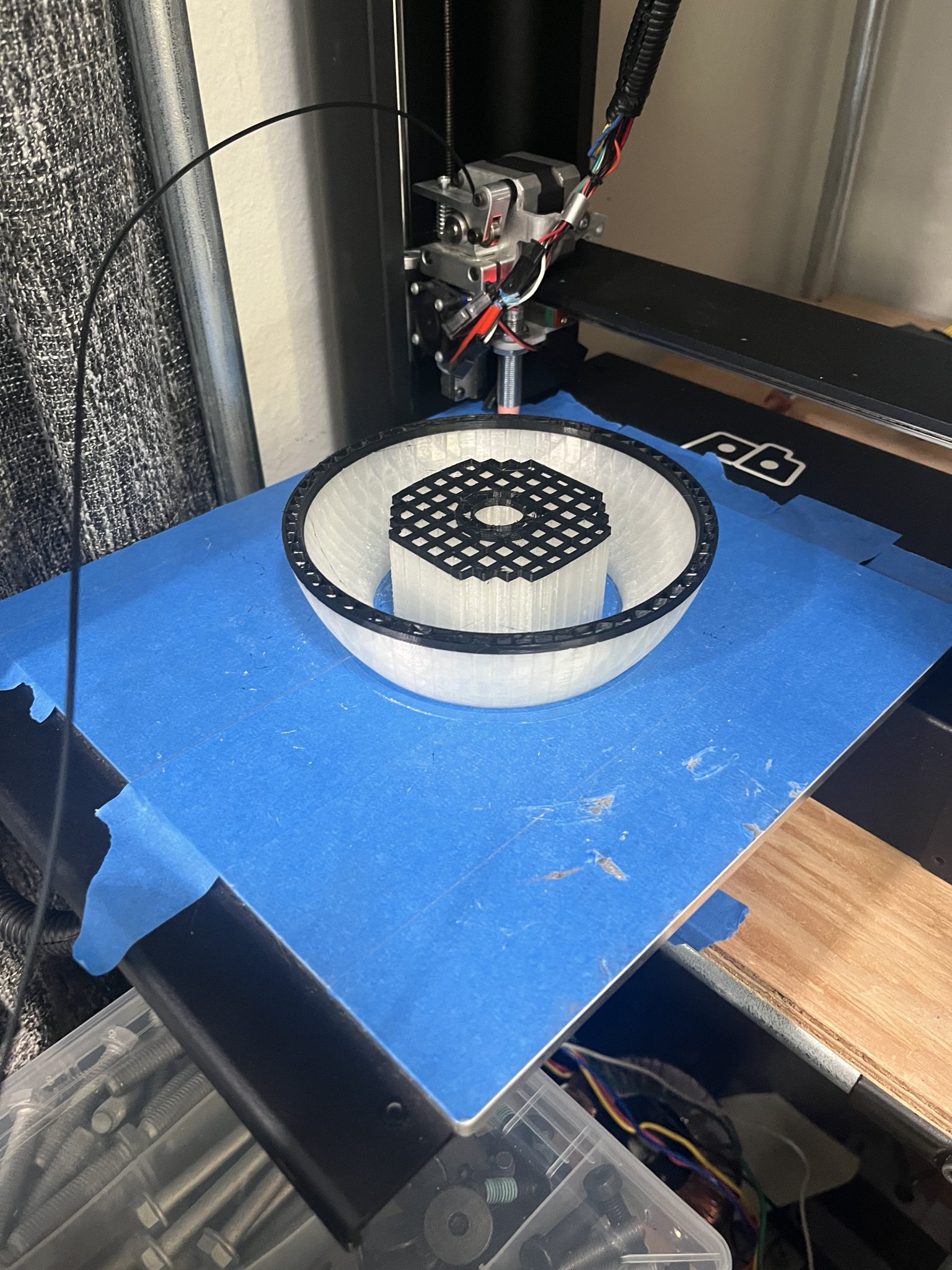

My roommate and I picked up some full-range 3” and 4” drivers at BAF23 raffle, with the intention of taking our very first foray into DIY speakers.
I had long put off building speakers on account of the dizzying amount of considerations, optimizations, and calculations one could leverage to design a (good) speaker.
My roommate assured me it’s well within our abilities to make a bad speaker, and perhaps we would learn something along the way—so no more excuses.
The result was a shootout between competing spherical designs (with a bonus fake “TL” concept speaker cab). Misprints aside, the results actually sounded surprisingly good to us. The biggest glow-up was the 3” driver, which really sounded far better then I gauged it would just off the unmounted listening test.

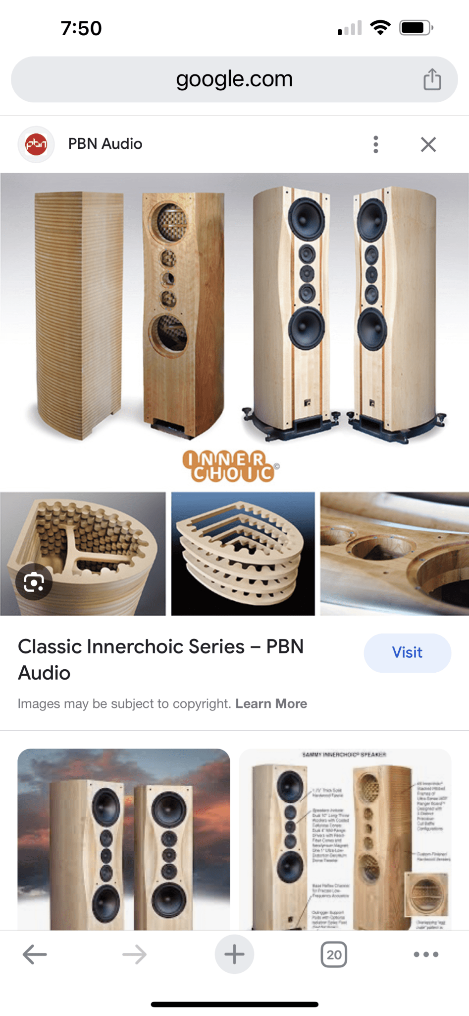

Maybe try a innercoic enclosure!
Translam. Yuk.
And the little knobby bits are inside the bass part of the enclosure and are not large enuff to make any real difference. “innercoic” should be absorptive but this is dispersive (at frequencies not seen in that part of the box)
This one is effective in the midrange

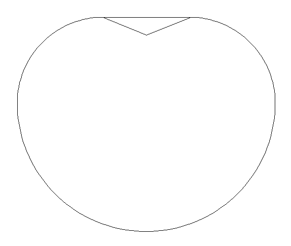

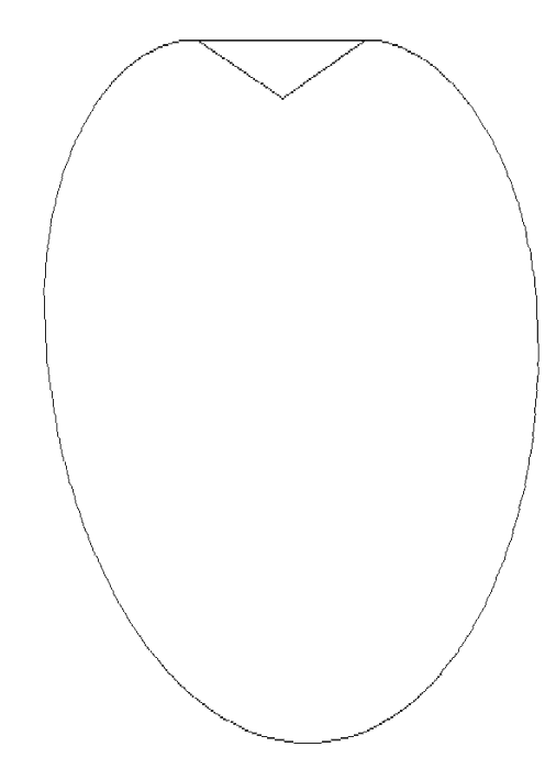

Truncated ellipsoids! I've got a few favorites 😀
Re: Innercoic -- I've been thinking of an idea that might be more useful (if also covered with some absorbative material e.g. eggcrate foam). I'm imagining a faceted surface on the inner walls of a speaker cabinet where each facet is of a random size, no facet is perpindicular to the driver, and no facet is parallel to another facet. Similar in concept to KEF's "meta" driver treatment but in a different shape and on a larger scale. Would be easily 3D printable.
