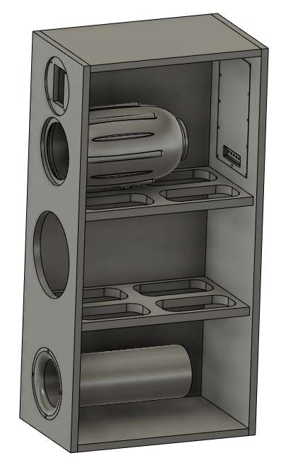

Honestly, a lot of what you just said went over my head. I have only desinged a couple different things so far.
I made a 3 way from traces for my bedroom
A desktop two way
A pair of full rangers for the my shop pool room
A folded horn full range for the kitchen
So this is my first major build. The goal is detailed, full range sound. We only sit in a couple places in the room these will be in so 15 degrees off axis dispersion is all I am really aiming for. This is for our TV where we spend the majority of our time yet currently has our worst sound system.
If you look at the box you'll see a removable back plate so this will allow me to mess with the crossover as I'm sure I won't get it right the first time around. I think I will also get a WIIM amp so I have a bit of active DSP and an EQ

I'd go with a 10 or 12" woofer since for all the complexity the 8" will be a limiting point.
You could side mount it or are the boxes built?
Or will you also use subs for HT?
There is nothing wrong with a single 8" woofer in a 3way, trouble or not. The SLS8 has plenty of travel and Pe to be fine.
The boxes are getting CNC cut this weekend. One of my coworkers and 48" square CNC in his garage. These don't need to play loud. They will likely play at 1-10 watts their entire existence.I'd go with a 10 or 12" woofer since for all the complexity the 8" will be a limiting point.
I'll just dumb down the tweeter and mid with L pads and such to level it all out.
I did make provisions in the back plate so that each driver has its own set of terminals. This makes it way easier for me to take measurements and it makes it so that I can run it active in the future if I ever decide to do that. Ive put quite a lot of thought into this design. Burned about 4 rolls of various 3d printing filament making all the stuff. Even the tweeters have their own little mini enclosure to protect them from the back waves of the woofer.

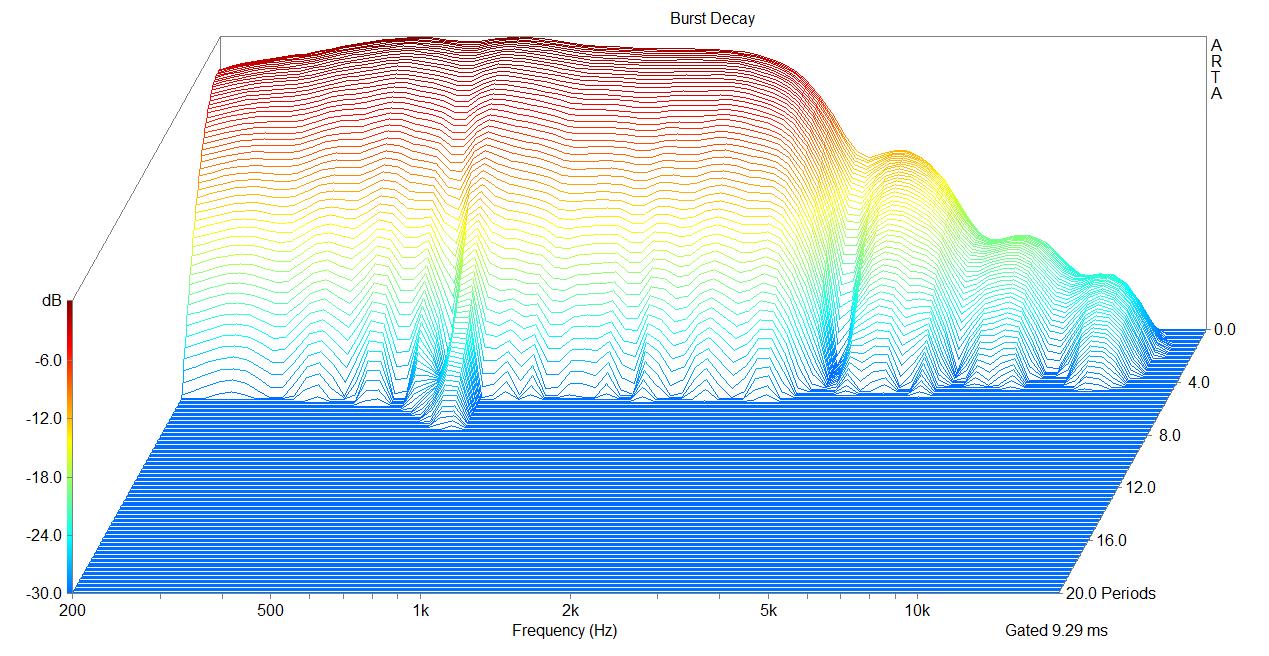

Yeah that looks like it is perfectly fine at 3k. I will cross it there.
Looks like something odd is breaking up at 1k. Probably nothing to be too concerned about. I wonder if that is specific to the driver.
