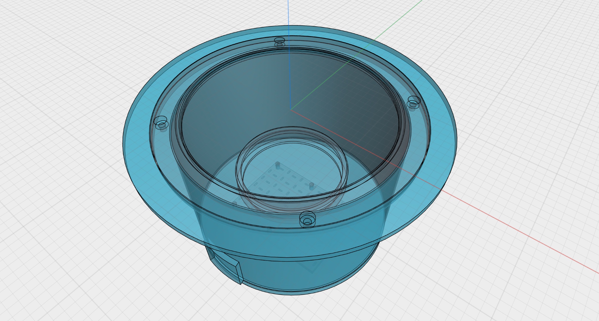

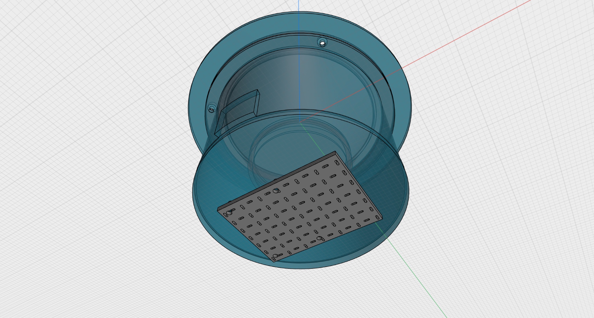

I've printed my waveguide using a gyroid infill and filling them with epoxy. It is a good fill in that it doesn't trap air pockets. If I were to do it over again, I would spray the print with flexseal, then fill with water to make sure it is watertight, empty it and dry (obviously), then fill with epoxy. If you don't water test it - well, you'll find out why it is important. 🙂 However, the plaster of pairs seems like a good idea. perhaps put it on a vibration table or shaker of some sort to make sure it gets in all the nooks and crannies.

Getting closer.... I've printed out a test enclosure and filled with Plaster of Paris mixed with wood glue. I'm going to print out the same test enclosure with 40% (grid?) infill and test both. Waiting on filament to be delivered...
