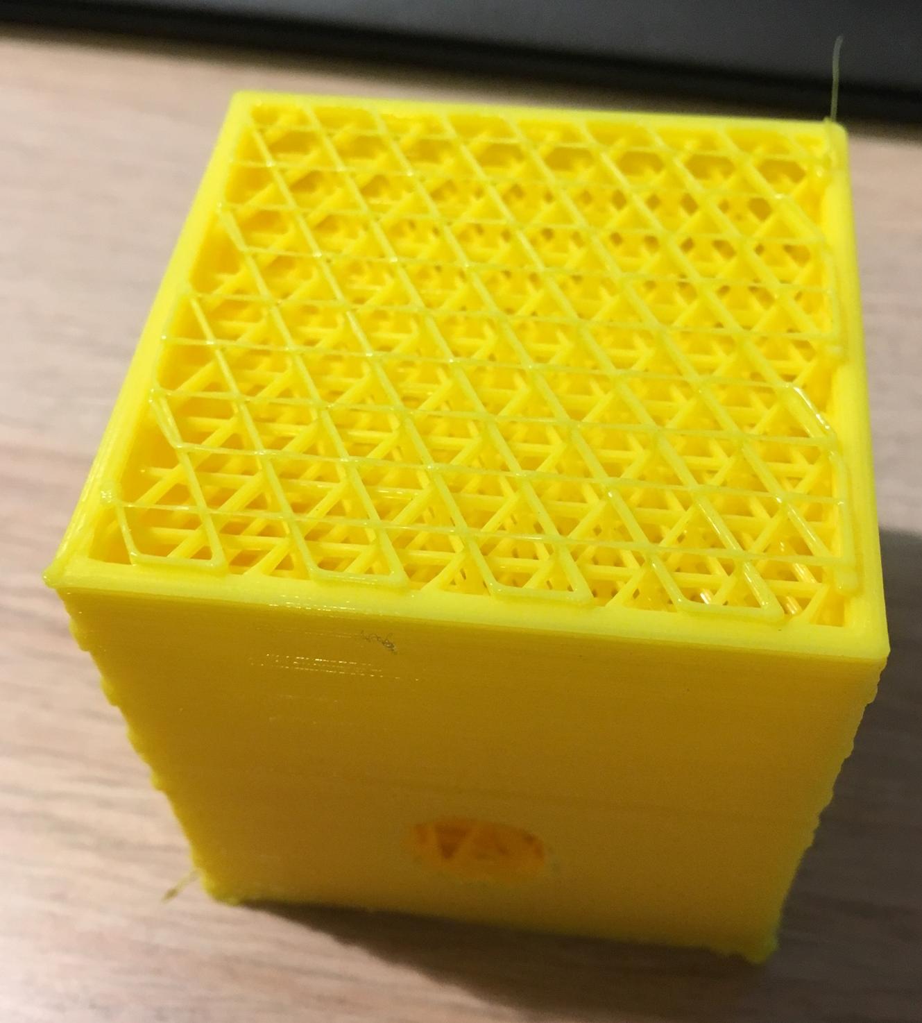

I too use PETG much more than PLA for these type of jobs. Prusa printer does ok with 0.2mm layers and I need to slow down the first layer a lot to 30% or so, but after that it works ok also at 100% of the speed using Prusa generic PET profiles.

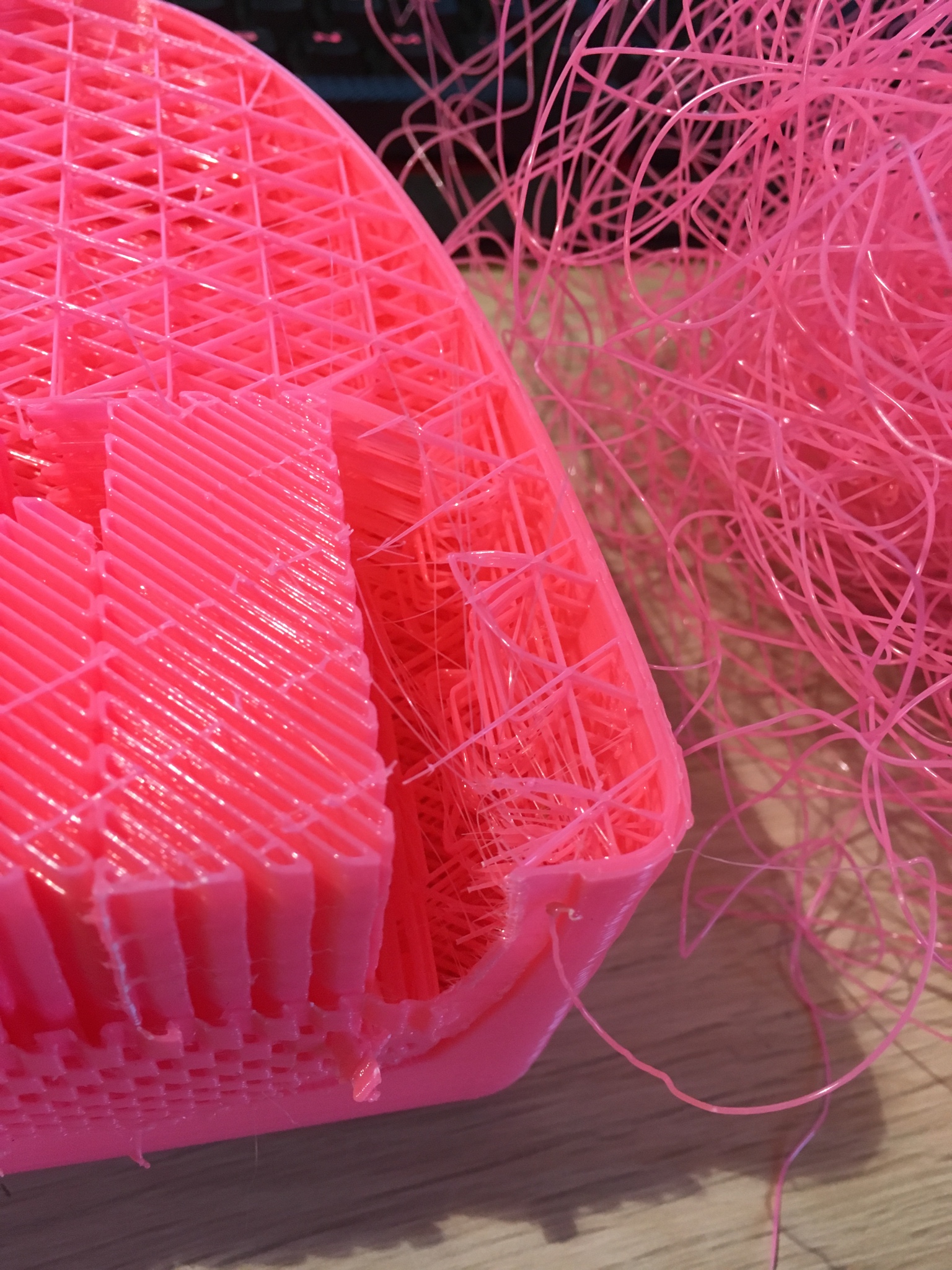

I'm hoping that the extra thick printed walls, and the body filler/spray paint should be enough to seal the box, and then some mortite would be good for dealing around the speaker itself.
Right now I'm still trying to figure out some print quality issues before I retry printing the full size speaker.
